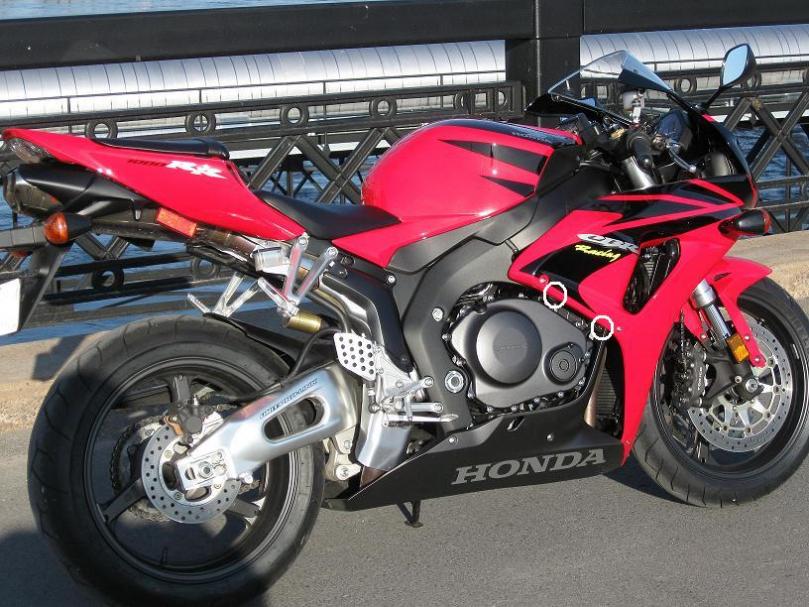

The picture shows where the main engine bolts are (there are two on each side).
I think I saw guys installing ''no cut'' sliders on the highest one.
But most of the pictures I see for ''cut through'' sliders are from '04 - '05 model years when the fairings were different, and they seem pretty low, which makes me think I should install them on the lowest bolt.
On the flip side, if they were too low, I am not sure if it would lift the wheels and have the handle bars dragging on the ground, if the bike should slide on its side...
Any educated opinion welcome!
