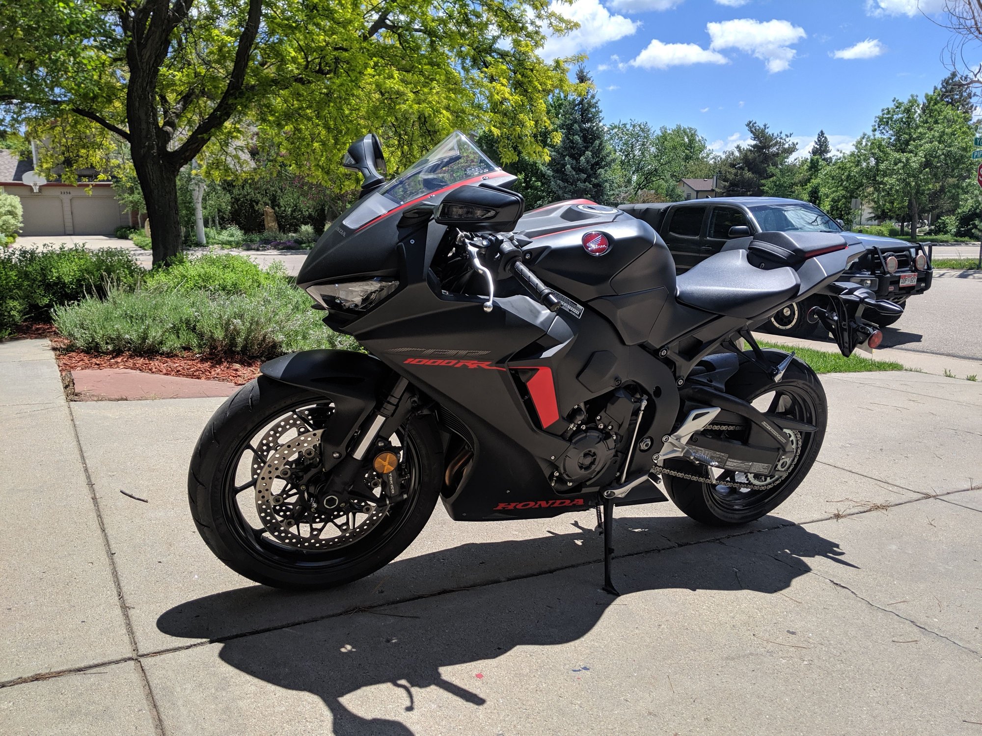

From - Colorado, United States
Been riding for 14 years on a variety of different bikes.
Own:
2018 CBR1000RR

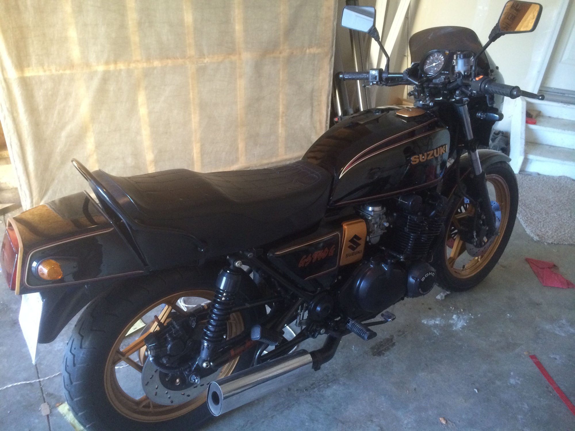

1980 GS850G (first street bike)

Wow, the GS takes me back... riding one of those that a budy owned in the early 80`s. It was the one and only shaft drive that I have ridden.
