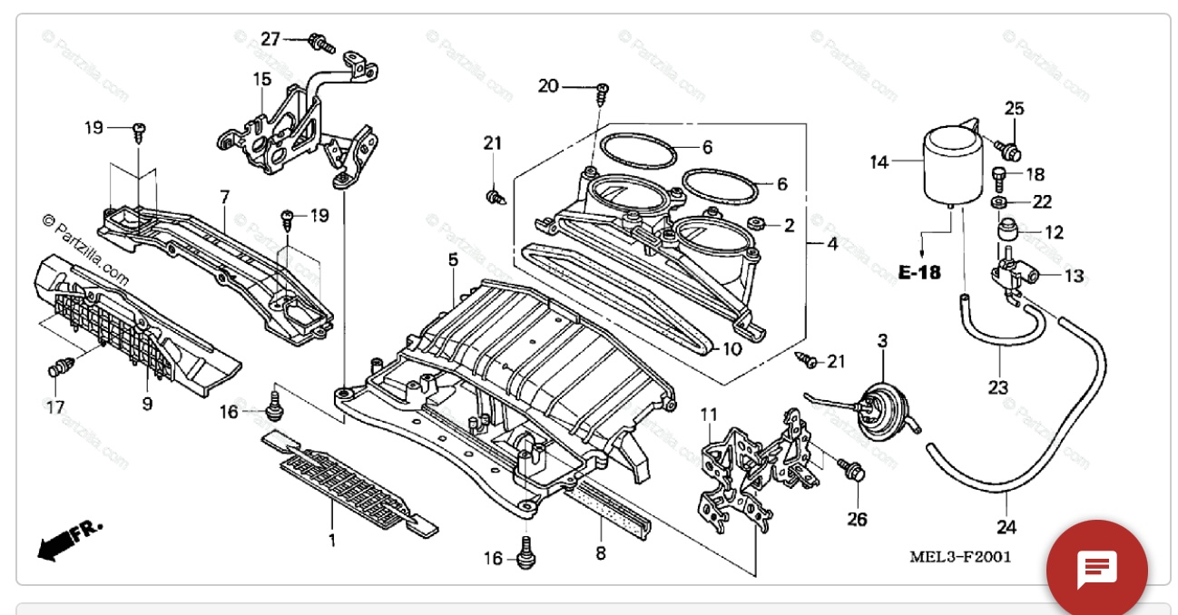

All that is left is two trim clips just above the front fender. If you have those out its time to pull. I know when I pulled down the air intake on my bike, it was a real pain trying to separate the intake from the main airbox. There is a molded in tab that holds the two together. One side is slotted and the inlet slides into the slot. It can be really stuck from that tab. Its located right in the middle of the inlet, so I think I used a flat head screw driver and pryed the two apart a little and it popped out.
heres a pic showing what you have to pry down. The intake actually has to tilt up and out. But if I remember right, there wasn't room so I had to pry it.

I have a similar problem. i feel i have taken the bike apart to get to the spark plugs and i am stuck trying to remove the air intake ducts so i can reach the two exterior spark plugs. there is only one bolt on the front side and i see a pin in the back that inserts into the frame but the front is stuck solid. how do i a free it?
Old Mar 10, 2024 | 12:20 PM
dannoxyz's Avatar
Posts: 1,988
Likes: 439
From: Mesa, AZ
There’s several bolts on side and underneath as well.
