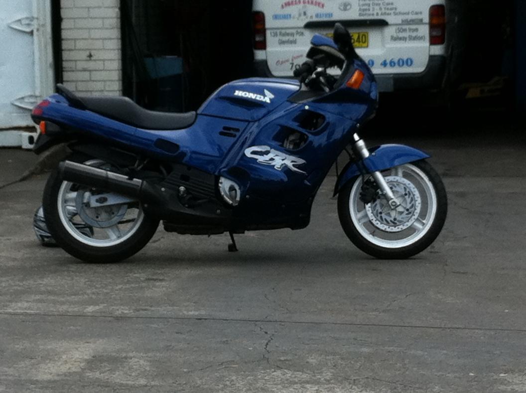

This is Hurricane Misty passing her first Registration inspection in her new life with me.. Pic taken today

Ol misty is lookin sweet there horsepower, I just finished putting on a new lower cowl,and protectors on the left side, I found a lot of gravel under the bracket mount so I would say the previous owner lost her on the loose stuff I had to do a bit of persuading to staighten a couple of brackets to get the new bits to fit. I also replaced the tank hinge pin, it had just a normal bolt done up that tight the flanges were squeezed together! She had not been started for a week so I replaced #3 cyl spark plug and she started OK but died shortly after just as I was about to go for a spin. Could not find anything wrong all plugs were sparking so I spat the dummy and went and chopped down a tree in the back yard, good strss reliever! I then had a look around all the work I had done to see if anything was out of place and noticed a small hose which looked as if it should have been attatched to the fuel tap! I suppose this is the vacuum hose because it is now going fine again, It feels good to have a win every now and again.

Hey Jarvid ..thanks man.. vaccum hose for sure always gets many... glad you to hear shes up and going
