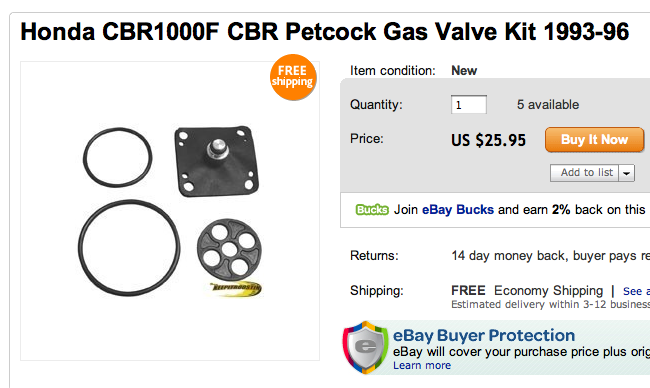

Hey, Iv'e been trouble shooting a fueling issue recently and have nailed it down to the petcock I suppose.
Anyone that has rebuilt the petcock may be able to tell me if this gasket set looks right and complete?

That looks about right, hopefully it has some screws or info on the sizes you need as well, you will have drill out the rivets as you may need to with some kits, and the diaphram has screws that may need to be replaced as they strip pretty easy. So just be prepared to do that and you will be GTG. Pick up a Metric oring kit from Harbor Freight to replace the tank to spacer oring as well if it is dryrotted as they can get that way too.

I went to Honda today and bought the kit. The kit in this picture is not what Honda supplied. NOTE: All the parts Honda provided were identical to what was in my petcock.
It was a clean plug and play. I reported the seller to ebay. I am tired of buying crap off ebay that does not work.

These parts are not for a 1993 cbr petcock. Honda says you can not open the petcock to rebuild it... only for the vacuum side and none of the parts pictured will do anything for the 1993.
I am sure you can get great parts from ebay but, the listings need to accurate.

Hmmm robbiegraham just drilled off the rivets on his and rebuilt it from an ebay kit !
and that's the approach I'll be taking with my 1990 & 1993
Matching Gas Cap , Ignition & Seat lock EBay
Ok, now you have my attention. I did not understand what he was talking about. LOL
