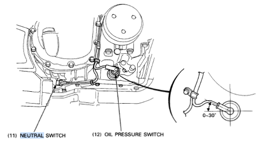

Hi Everyone.
I'm in the process of re-wiring the neutral switch and I don't have a motorcycle lift stand so it's a bit hard for me to get under bike at the moment so I was hoping someone would tell me exactly where the switch is to save me some time...I figure it will be near the gear select lever.
I don't have the original dash and all the wiring in the front is all over the place so I figured I could simply run a new wire from the neutral switch to the new after-market tachometer rather than looking for the corresponding cable up in the front as I currently have too many cables to sort out.

Hopefully this will help.
You sir… are a gentleman, you didn’t have to contribute and help, but you decided to be a good sport and help out, for that I thank you dearly and I wish you blessings for 2022!! All the best champ!
