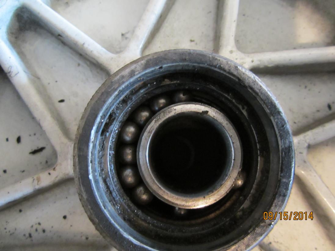

I am putting new bearings in the front of my 91, and i don't see anywhere that anyone mentions the spacer. What i need to know, is how much slop should be in the spacer. The last time, i must have tightened the brgs to tight, as i had an early failure on the left side. Rode it 250 miles back home from our camping trip. Very scary.
Attached Thumbnails Installing the front wheel brgs. the spacer-img_1026.jpg   Installing the front wheel brgs. the spacer-img_1025.jpg   Installing the front wheel brgs. the spacer-img_1024.jpg

There shouldn't be any slop. It spaces the the inner races of the bearings.
In your first photo it looks damaged, if so it should be replaced.
Is that what that is? Yeah, that looks damaged to me too.

I did replace the inner spacer as well. Everytyhing felt good when installed. I think i might have damaged the bearing on that side when i installed it last time. All good now. Thanks
