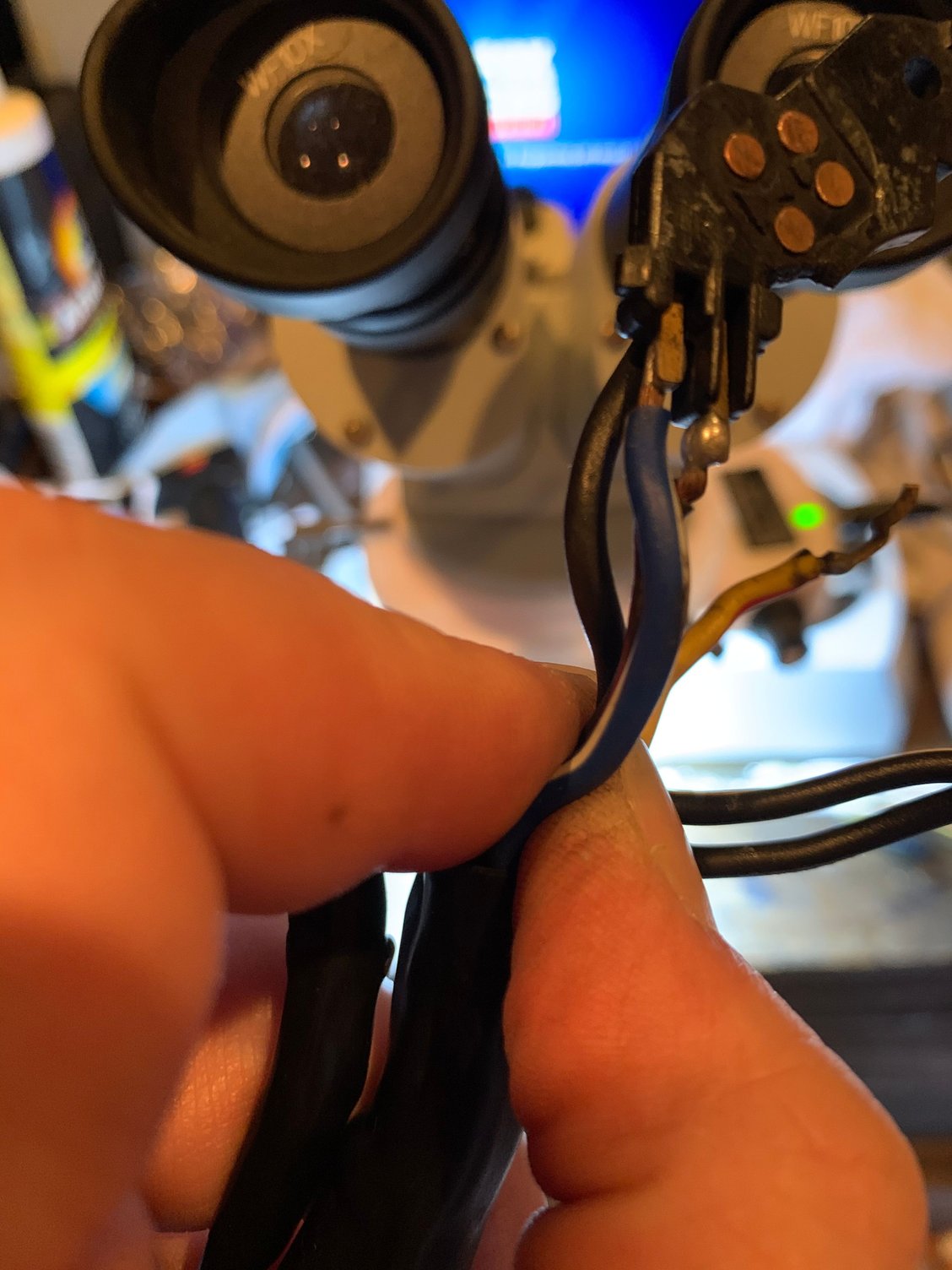

Originally Posted by IDoDirt
Some things I would point out on these while you've got them apart is to look at the solder joints. Many of them just look like a blob of solder sitting on the metal tab of the switch. This is common on many of the Honda switches. They are netorious for having the solder break off of the pad and just be hanging there.
To your point, OEM solder joints....
Old Nov 1, 2021 | 10:59 PM
Yea, they look pretty sad.
Nice set up BTW.
