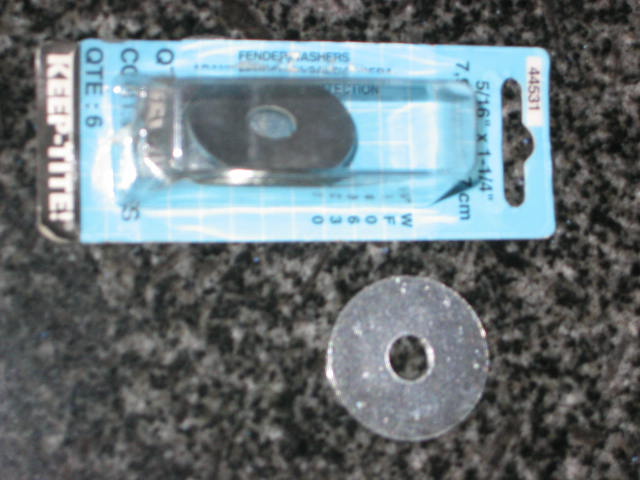

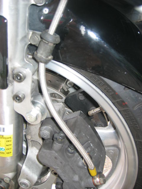

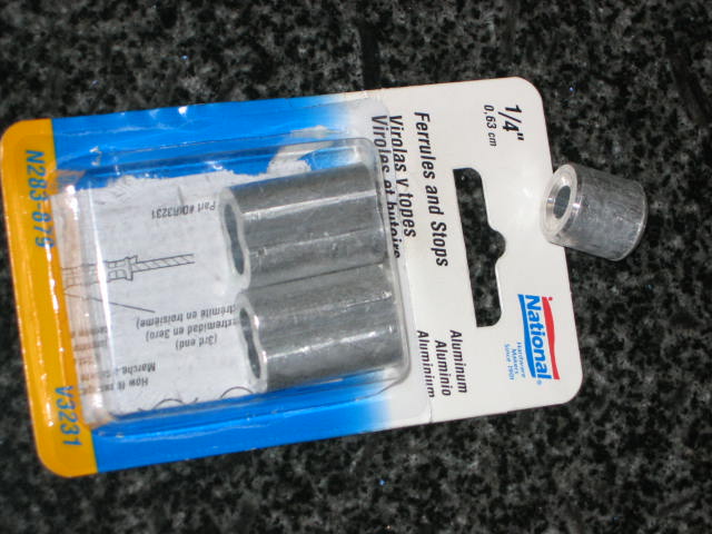

I used some cable stops that I cut with a hacksaw and filed smooth for spacers and drilled out. Then I found some large aluminum washers that I drilled out to take the 8mm bolt and made the brackets from flat stock aluminum from the hardware store. Use an 8mm bolt,washer, locking washer and nut to hold the brackets, spacers and large washers.
Save old hardware to help hold the lines in place. You will need new lines for the front. I ordered 1990 lines as they are not linked. Stack two lines on the MC and run them down to each caliper (bold head-washer-banjo-washer-banjo-washer-MC {washer=soft copper seal washer}).
