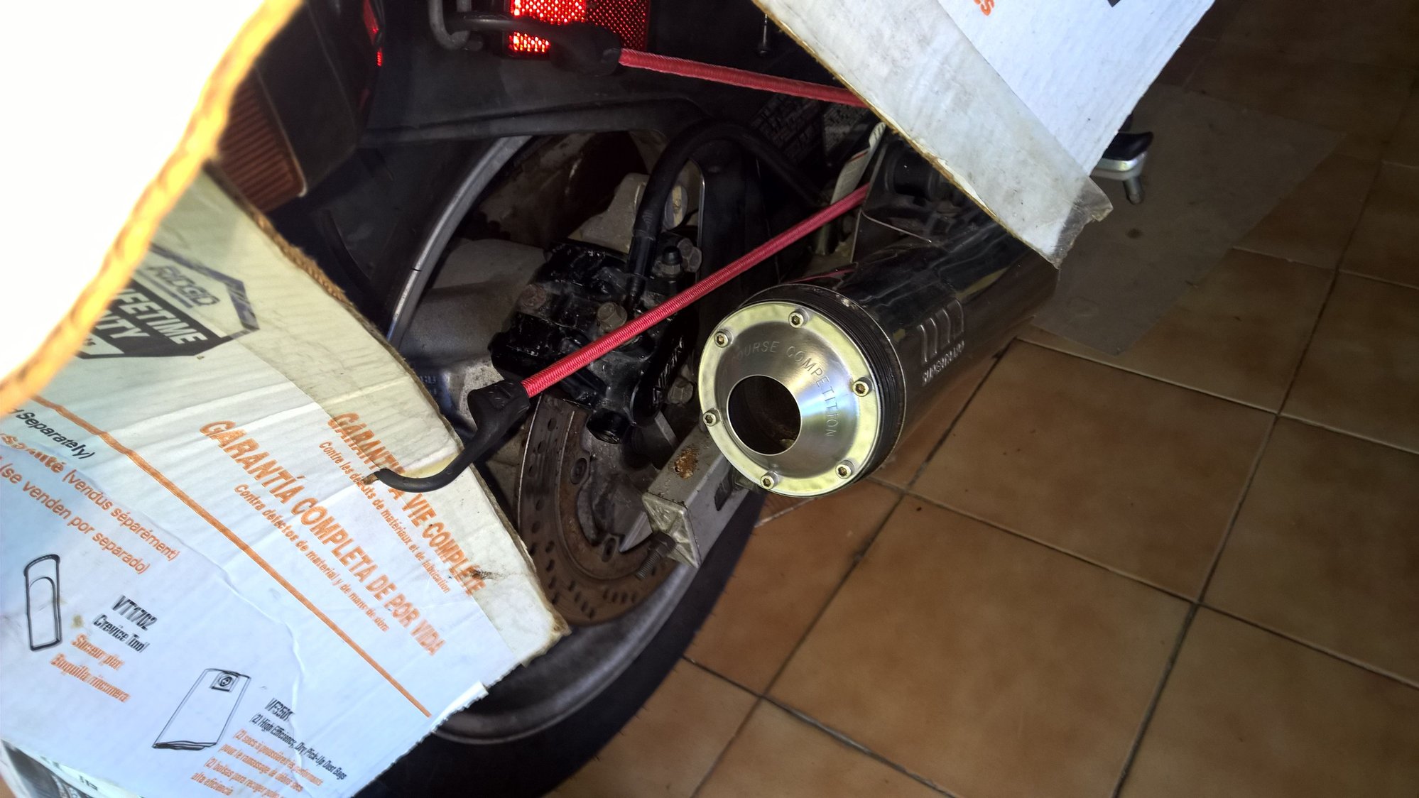

Yes it's loud, but I like the looks. Bike came with closed end caps supertrapp slip ons, I like better the open end cap, so there they are.
