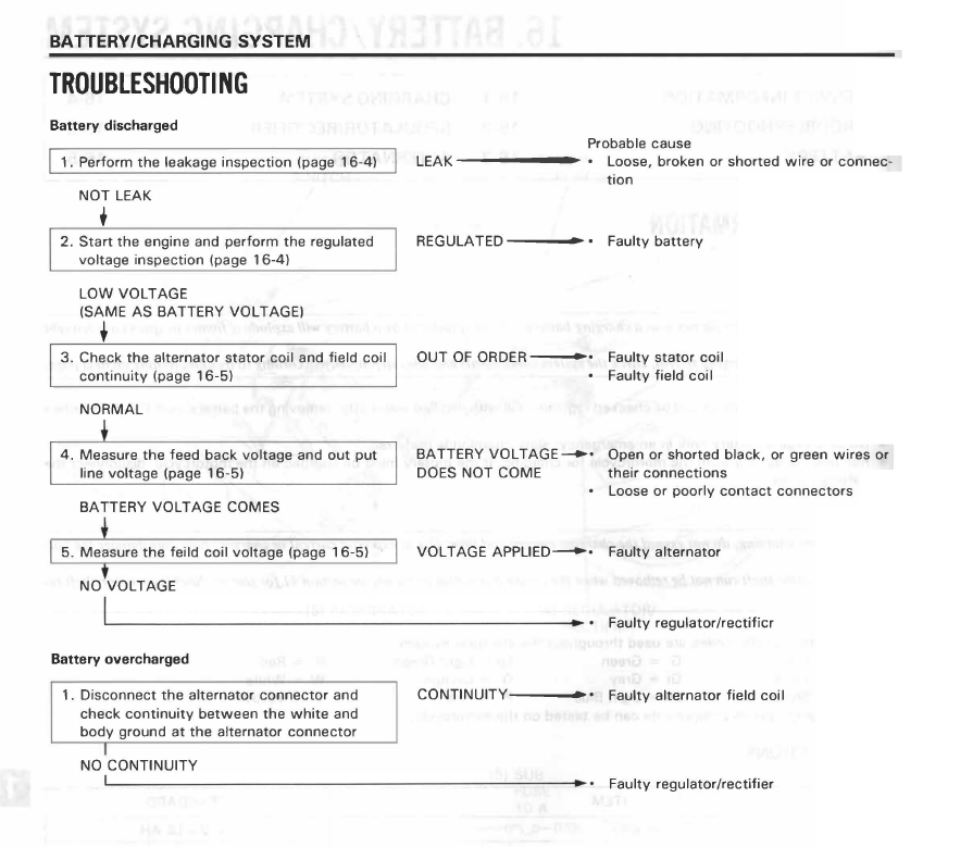

What is battery voltage? Does it crank slowly, ie., is the battery discharging? Cause that's what it sounds like
You really should be working from the manual. There's a free pdf on this very forum. Chapter 16 deals with the Battery/Charging system, and there are some simple tests that will rule out a lot of the common culprits. If you learn it properly once, I promise it'll make it a lot easier to troubleshoot similar problems in the future. If the battery is discharged, you will want to check out the following:
1) Parasitic draw/short to ground (voltage leakage inspection)
2) Bad battery (regulated voltage inspection)
3) Stator coil continuity
4) Field coil continuity
5) Feedback & output line voltage
6) Field coil voltage
When those tests are done, you should have all the info you need to make a diagnosis, and we'll help however we can
Also I'd be putting a trickle charger on that old battery. Unless the voltage is below 9V or so, you've got a good chance of bringing it back from the dead. Then you have a spare (sounds like you'll need it)
Good luck
Good luck
