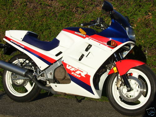

Hi all
i have ordered a fender fron vfr750f 1992, i beleive it will fit and for those whom wants a smaller fender it is perfect , it still goes with the style of the bike.i will put it on this week end and post pictures.
Attached Thumbnails Smaller front fender for 87-88-89-91-vfr92-front-fender.jpg   Smaller front fender for 87-88-89-91-vfr86-92.jpg

From: Quebec,Canada
Well i just put it on, It is a perfect Fit, a bolt on swap, it took me five minutes, undoo the bolts take off the original one and put the new one, somehow I believe they should have done it this way when the bike was launched. it smooths out the whole shape of it, the front styling looks less heavy.
pics too follow!

here they are
Attached Thumbnails Smaller front fender for 87-88-89-91-cbrwin2010-2.jpg   Smaller front fender for 87-88-89-91-cbrwin2010-3.jpg   Smaller front fender for 87-88-89-91-cbrwin2010-5.jpg   Smaller front fender for 87-88-89-91-cbrwin2010-6.jpg   Smaller front fender for 87-88-89-91-cbrwinn2010-4.jpg

And the beautiful part of it, it is a straight bolt on ! Nothing to do , 5 minutes to take the old out and 5 minutes to put that one, and i was lucky i found one on fleebay the exact color of my bike!
