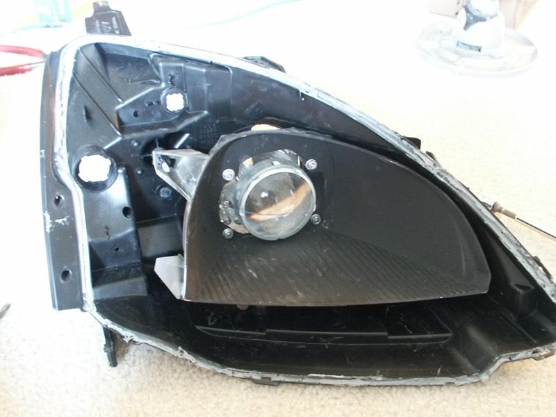

I got a set of BMW HID's BiXenon bulb, ballast, projector. I opened up the housing and cut into the reflectors to allow the projector space to mount right to the housing. Mounting to the housing gives me full ajustability just like stock. The advantage to this is that I have both sides low beam and both high. Got the set up from a friend that works at a repair shop where they throw that stuff away. cost me only 120 for everything. Of course loads of work to get them in. I'll post pics in a few days.

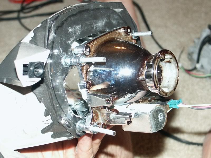

I've done 2 for cars:
http://smg.photobucket.com/albums/v5.../HID_Retro_01/
http://smg.photobucket.com/albums/v5.../HID_Retro_02/
But it is a hell of a lot of work... but the best you can possibly have. Please share pics, space is so tight, I don't know if I could fit anything in the F4i housing...
