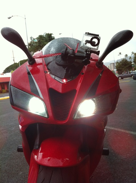

fenatic, I forgot to mention, I think inside the headlight housing, the shinny thing inside is different on both side. So the light reflect different way. I might be wrong though. But when I changed to projector, I had to take off those reflectable inner silver thing from headlight housing. When I had DDM HID, (I believe I had same kit as you) even though the bulbs were the same, left side was always highbeamed. I think dual running headlight bike must have different set ups.
Johnnyn The projector I got was from Bikelitez. It also comes with halo. You gotta melt the headlight lens seal, and take that silver thing off. It came with mounting plate so you just gotta mount the projector on that bracket and pop in.
I just hated beaming the oncoming cars. I had so many cars flick their highbeam to me and one time, I got yelled at. Plus my lenses started to melt.
