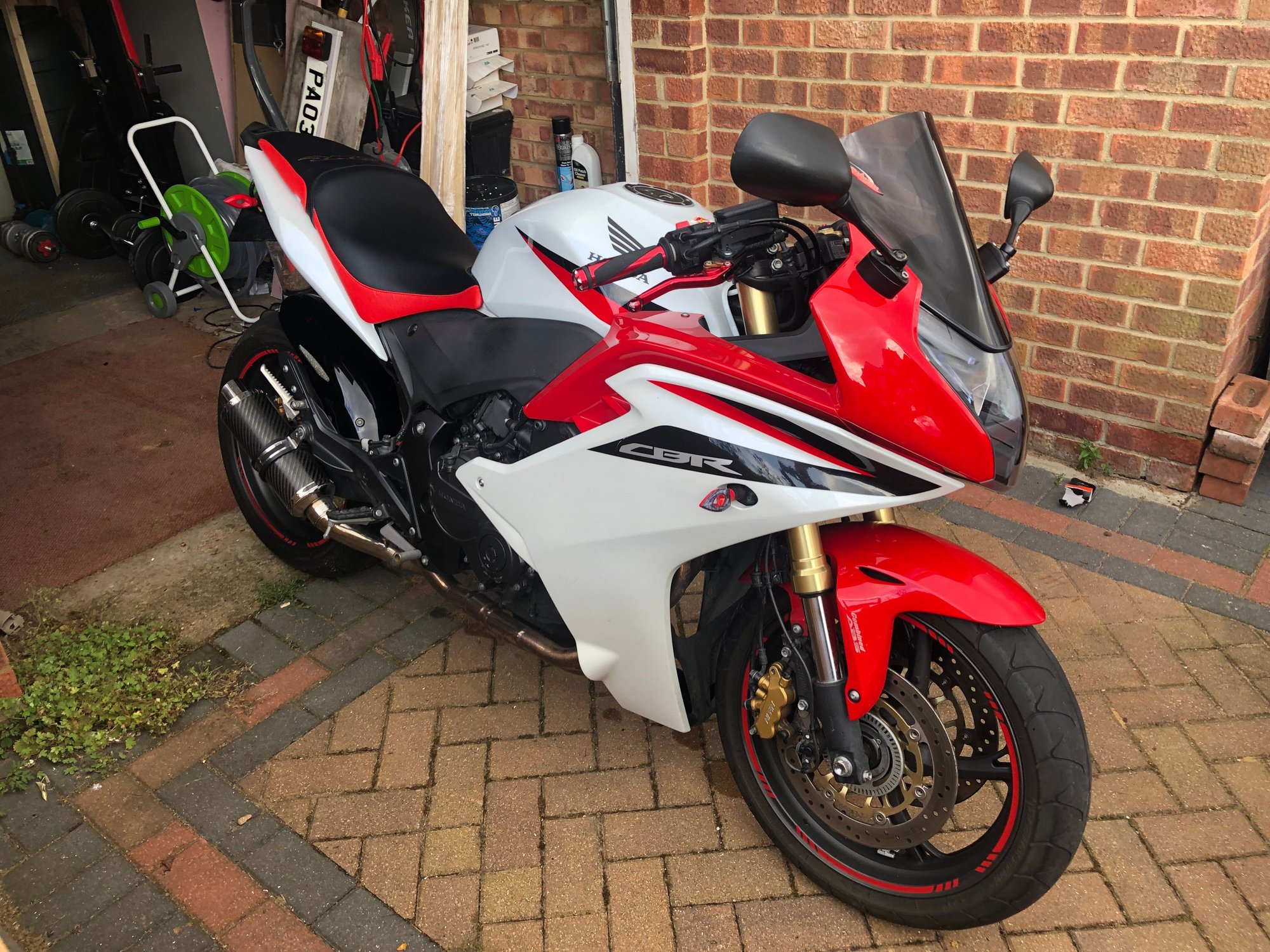

Hi all,
After many nights of research I still dont have a an answer to a few queries I have so hopefully someone on this forum will have the answers I need.
As you will all know, the CBR600F sounds terrible standard! Even after installing an Akra slip on, I didnt notice much improvment. After watching several youtube videos Ive decided to go down the decat route.
The questions I have;
Can the cat be removed from the existing header pipes (by an exhaust specialist), or would I need to purchase a complete new header system?
Would the bike need mapped following the completion of the decat works? Ive seen mixed opinions so would like to hear from someone who actually have/had it done. Ive also seen people advising a power commander would be required... Is this really necessary?
Any help would be appreciated
Thanks
Lee

Post a pic of the exhaust, especially one with the cat.

I think you'd need a remap for sure.
Would need pics of other questions...
