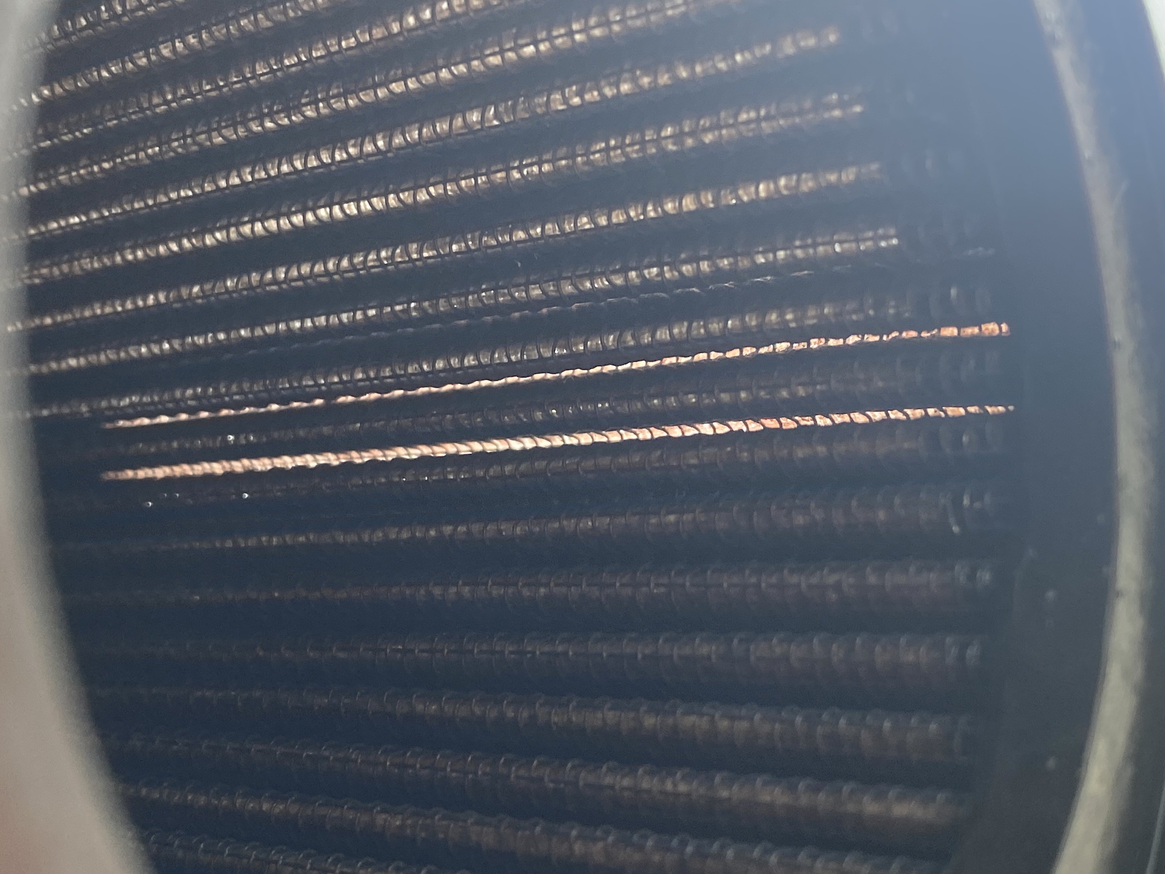

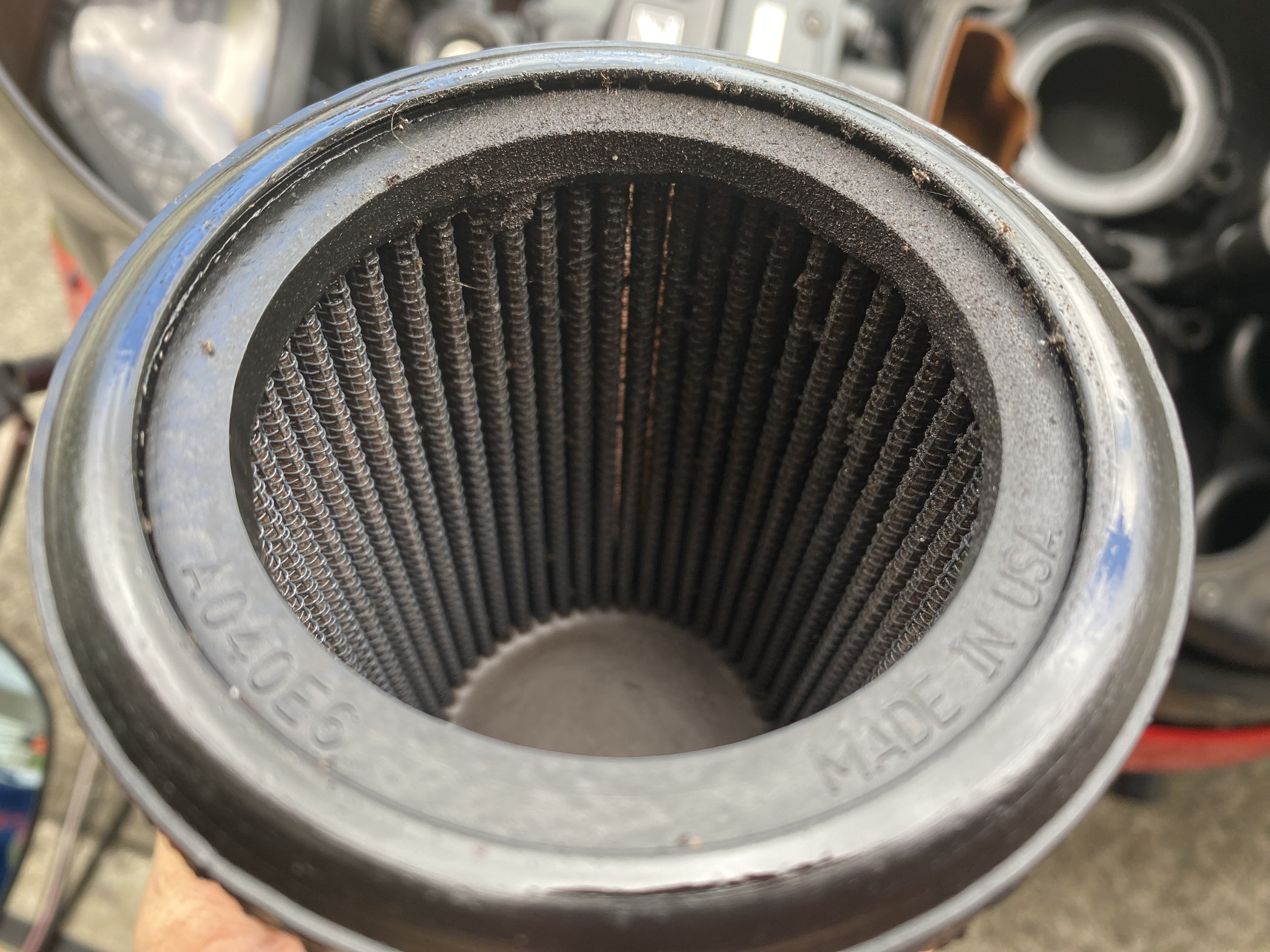

BMC may let through some stuff, but nowhere close to amount K&N does. Those have outright holes in filtre that does nothing!
Attached Thumbnails Removing steel mesh screen from stock air filter?-knfiltre_6939.jpg   Removing steel mesh screen from stock air filter?-knfiltre_6945.jpg
