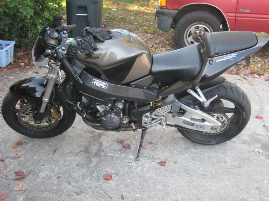

i've got some pics that are a month or so old of my fighter.
its been off the road for a week or so now. i'm puttin on some dirty bars, making a new headlight out of an infinity j30 headlight, and a new guage mount. all i'm waiting on now are my brake lines from galfer to get here, and i should be back on the road again. i'm also taking the rear brake resevior and mounting it to the front, and making the rear resevior be a longer piece of clear tubing.

conrice im thinking about making my 929 a fighter, did you relocate your key to the side there?
is that wat i see in the first pic?

yup. and i ground/sanded down the top yoke

very nice, i like that idea, so i can tuck the cluster in tighter....
was the relocation pretty simple?

Conrice I see a gap under your tank. Did your bike have the ram air tubes like an f4i at one point? I don't know how the 954's look under their plastics.

those gaps are from the duct covers, thats why i plan on fiberglassing my tank, and getting rid of that gap

ya it was pretty simple. solder and heat shrink wrap the connections. i've modded the harness a lot, but its not hard if you have a wiring diagram handy.
ya everything is behind the axle including the light now on my bike. and with my new setup, when i'm tucked in - my head is out infront the entire bike - its a badass feeling.
