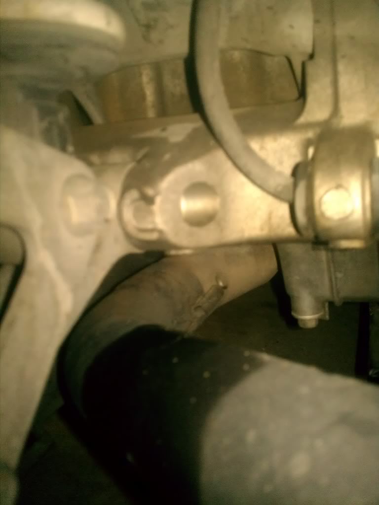

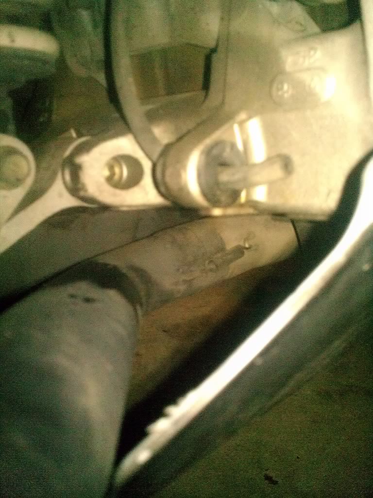

hope this shows how tight th area is.

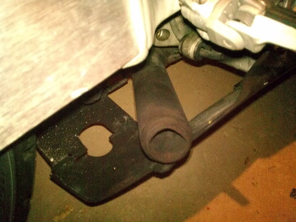

i cut the exhaust down to practically nothing but its not an open pipe. it has a baffle, so the sound is controlled. looks good but its rich at idle now and i knew i was goin to lose mid-range power. i was thinkin of removing the PCIII for now until i can get it dynoed, unless it isn't worth it since the pipe is so short. need some technical help on this one. here are some pics.

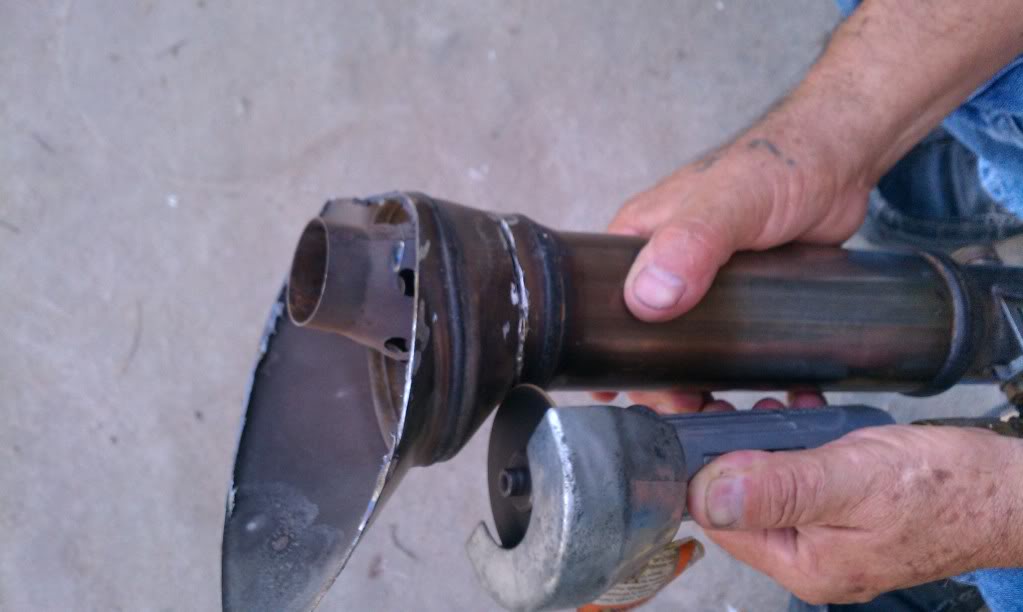

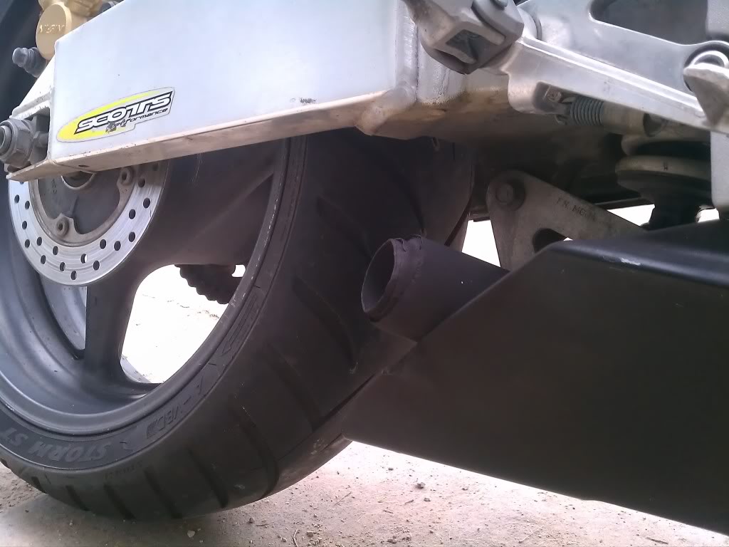

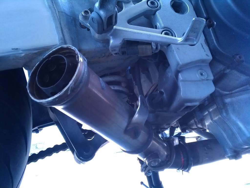

i nixed the exhaust with the baffle since it was restricting exhaust flow at high rpms. here is the new one...

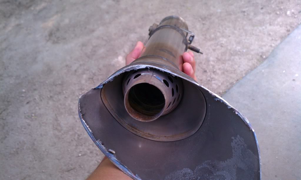

i had an '05 cbr1000 stock undertail exhaust that i gutted. here is the important part...

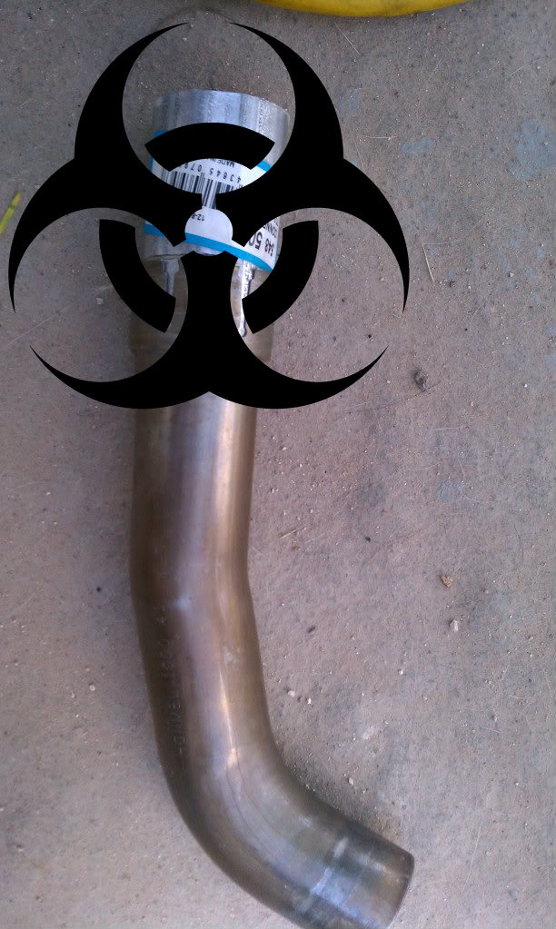

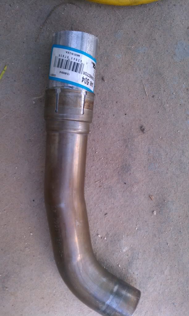

and the down-pipe...
cut off the extra metal...
cut the flared inlet off the down-pipe...

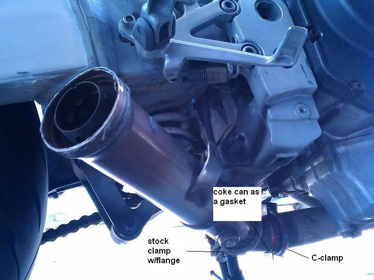

here's the breakdown of installation...
worx great and pushes hard thru the rpm range.
