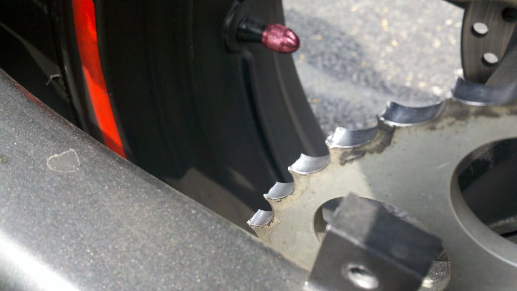

Because this is getting a little scary

Holy crap that sprocket is in bad shape. Yeah you need a new one on there and stat!

Ordered last week, shipped monday, and have still yet to see it.
I swear this things getting worse by the day

yeah i would stop riding that bike right now. Looks like a ninja throwing star and it would suck to get stranded somewhere. That is beyond safe riding.

Did you order a new chain and front sprocket as well?

nope, just the sprocket. i know you're supposed to replace all as a set but moneys tight

you may have issues with you current chain meshing up with a new sprocket. better check the front sprocket too!
