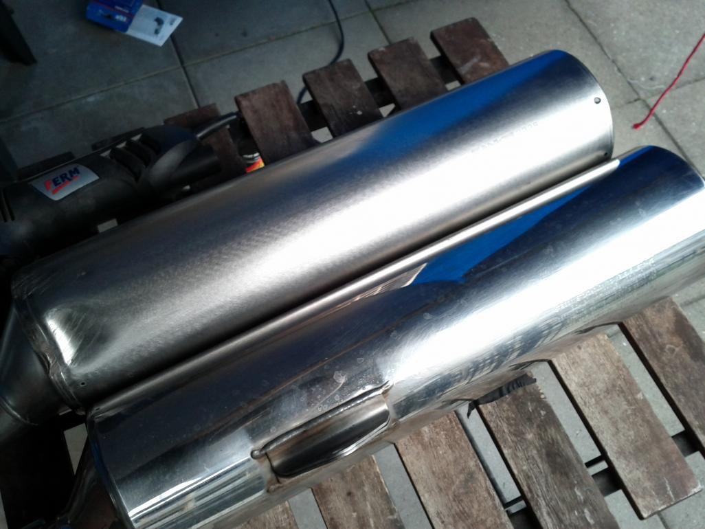

Exhausts before:
After sanding one of them. I liked the 'brushed' look:
Heating the pipe before and after painting to speed up the curing process.
The high temp paint will stay quite soft untill it's thoroughly warmed up. I won't be able to do this untill I take it for an hour long, or so, run:
The high temp paint will stay quite soft untill it's thoroughly warmed up. I won't be able to do this untill I take it for an hour long, or so, run:Found a cheap right mirror housing which I basically bought for just the mirror. I might sell the housing and get my money back but we'll see. The mirror brackets also finally came in. I'll eventually get some tinted signal glasses but in the meantime will order some VHT Nite-Shades to tint it a bit.

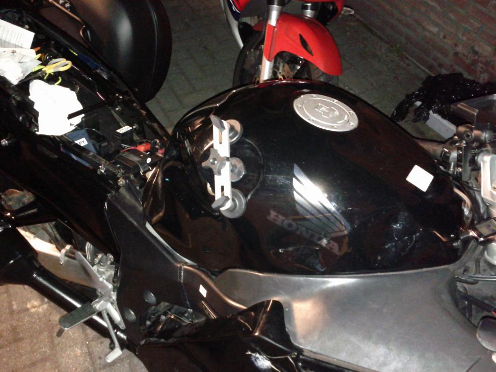

So this is the bike today (see below). I'm riding around on it everyday since the F4 needs a new rear tire and fuel pump. I needed some storage because I have to pick someone up for the airport so I put on the side cases. For general use I'll probably use the topcase the most, especially when carrying a passenger since it has a backrest.
She's working like a charm but I do feel a lack of power at higher rpm's.
I suspect the airfilter might be a bit dirty/oily (which reminds me, I still have to order a new one). The bike had some thin white smoke coming out of the exhausts a couple days ago which I suspect was some oil and/or coolant to have seeped into where it didn't belong. That cleared completely up after a few rides.
I am however keeping my eye on the coolant level and oil. I hope the head gasket is still ok! The bubble screen was bought from eBay (well. similar to but you can get the exact same on there). It was super cheap but works like a charm. I'm 6"3 and the original screen (plus this touring screen that came with the bike) was absolutely useless. I'm quite happy with it. I've also ordered some tinted turnsignal lenses for the front. The orange lenses make the bike look so much older.
