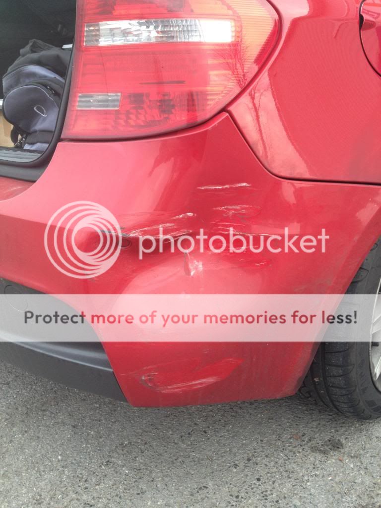

i have a 57 m sport 1 series. nice car right! until, an unknown entity drove into the back of it on a cold night and drove off, no note, no cctv nothing. so i go outside and find this....

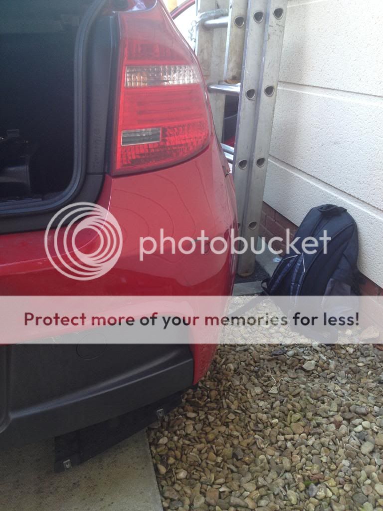

So i went home, figured out myself how to remove the bumper enough to get to the dent,
[IMG][/IMG]
Heated the dent up with a hair dryer and popped it straight out from behind. and polished the paint transfer off.
easy peasy
[IMG][/IMG]
all it cost me was about 45 mins and probably 3pence worth of electricity.
never going to the BMW dealership again.
