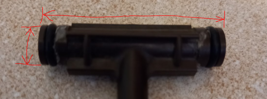

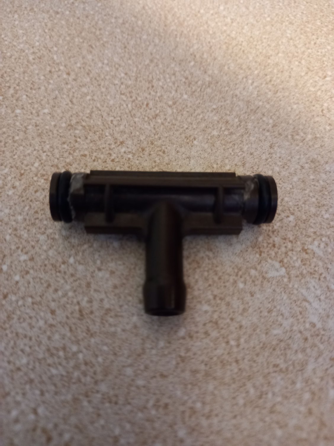

Hi i am trying to obtain a fuel T piece that links the kiehin carbs together, there is one between carbs 1and2 and one between 3and4 i have tried everywhere i can think of but have had no success can anyone help? either information to obtain one or if you have one would you be prepared to sell, the one i have is broken,
this is the part

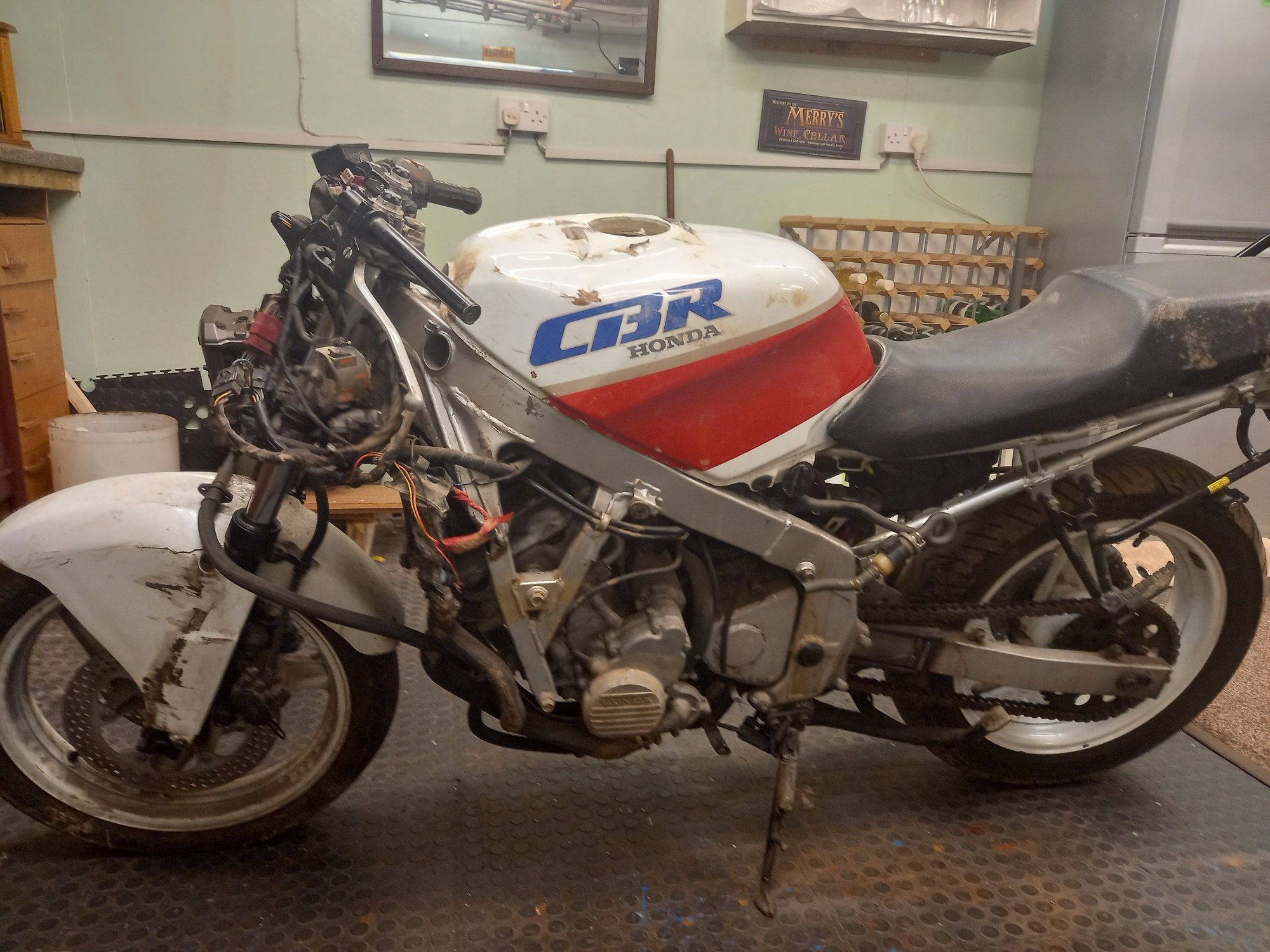

pics of progress.
as it came

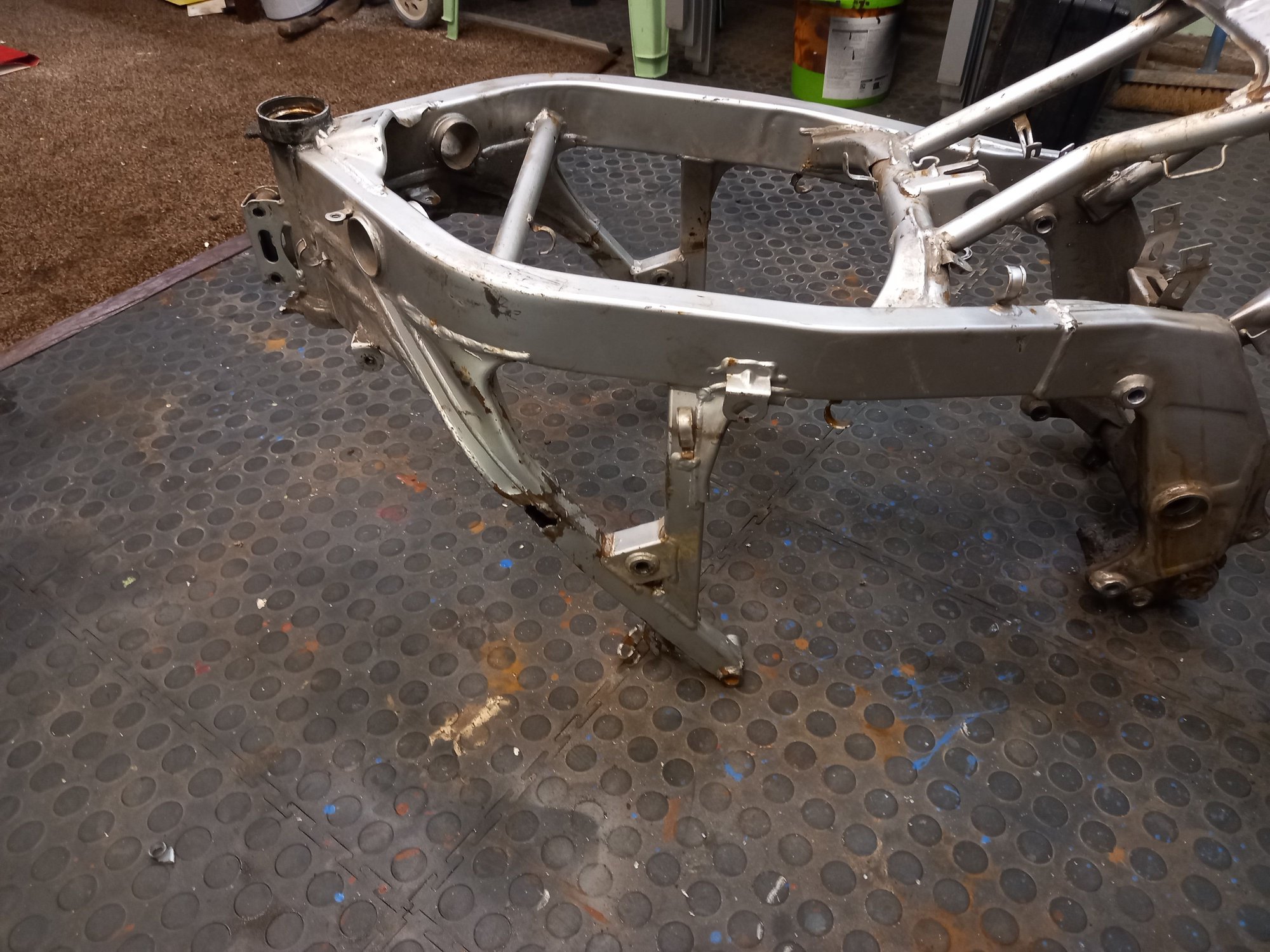

damage to frame
this is the part
@raymond28 What are the dimensions? Specifically from one end of the T where the O rings are to the other. It may look slightly different, but might be identical to the F2's and F3's. Also the diameter of the ends where the O rings are. Not the O rings themselves.

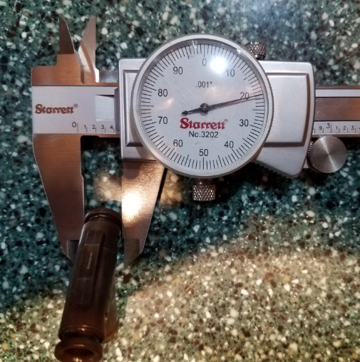

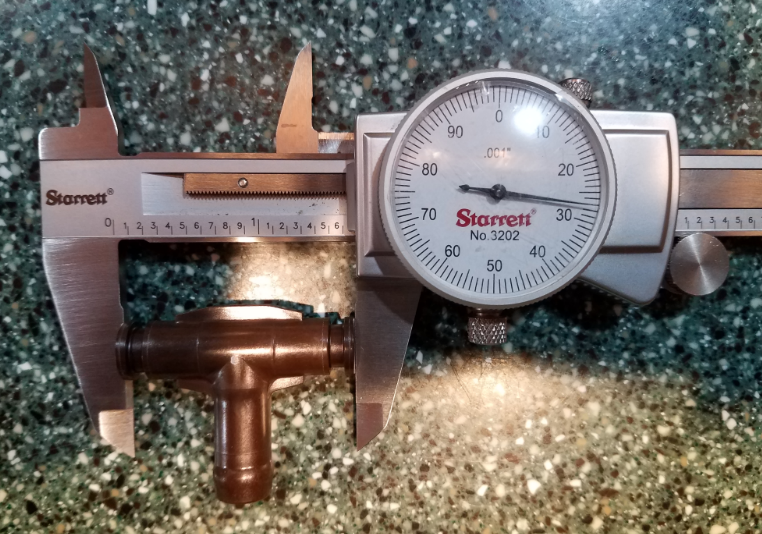

Old Jan 31, 2022 | 05:48 PM
Here they are for the F3. 1.627 or slightly longer than 1 5/8" from end to end. And 0.421" or slightly less than 7/16".

Hi thanks for showing interest, measurements are 1"7/8 end to end, and 7/16 across end so will have to keep looking, thanks again.

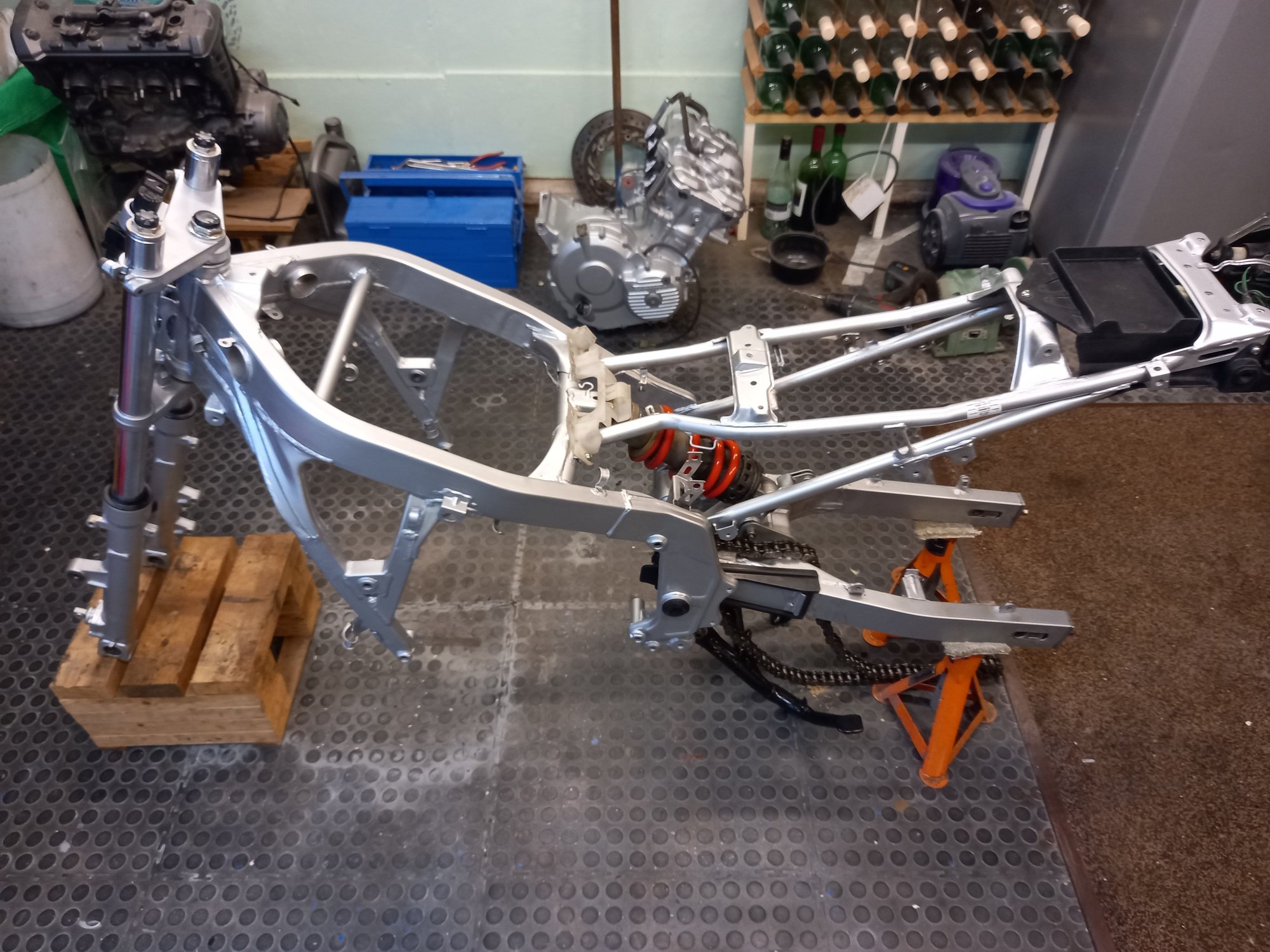

Hi again well rebuild now started, frame welded and repainted, forks refitted with new seals and dust covers, headstock (triple tree) refitted with new taper bearings, mono shock refitted, swing arm refitted with new bearings
progress so far
