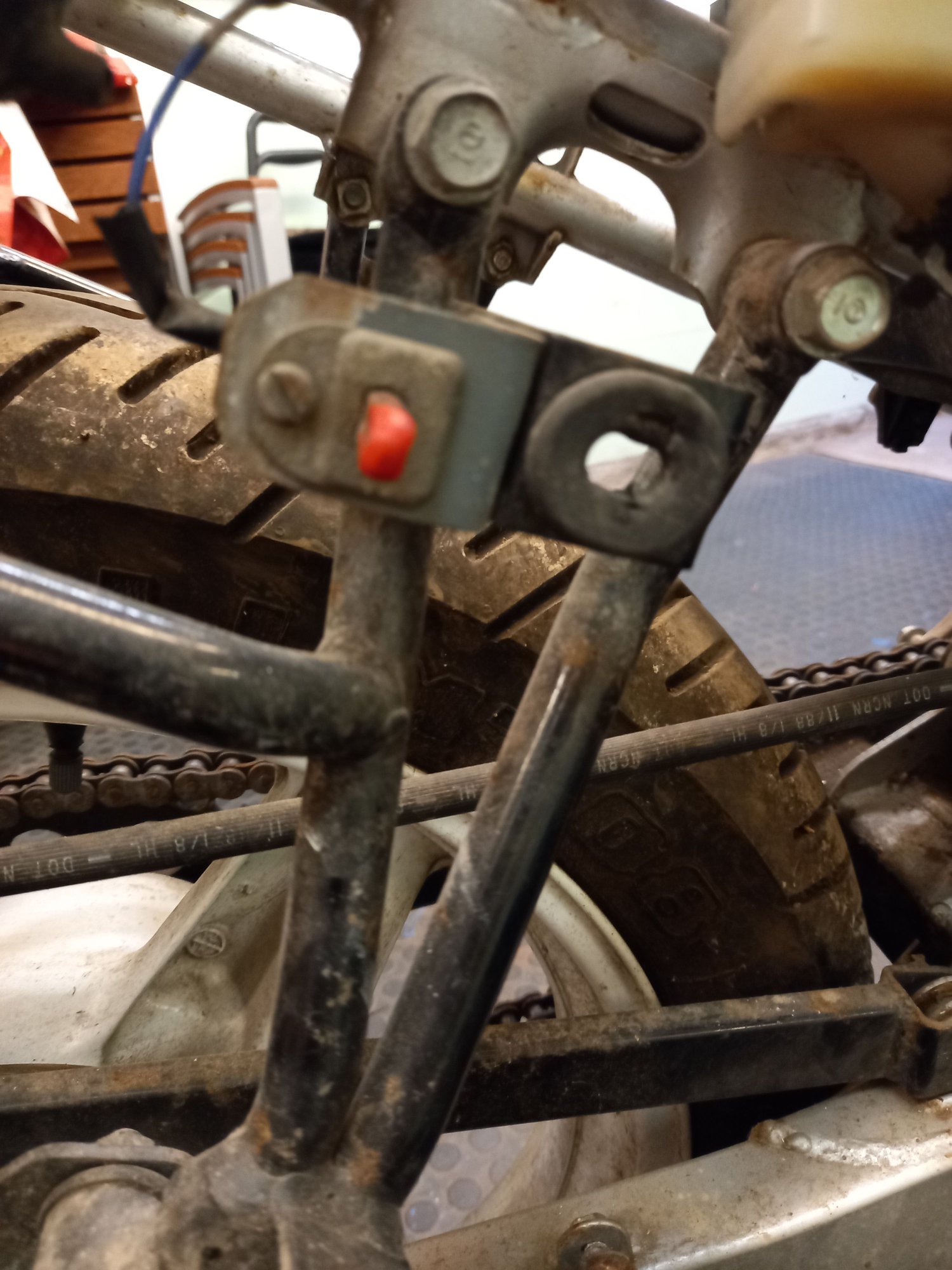

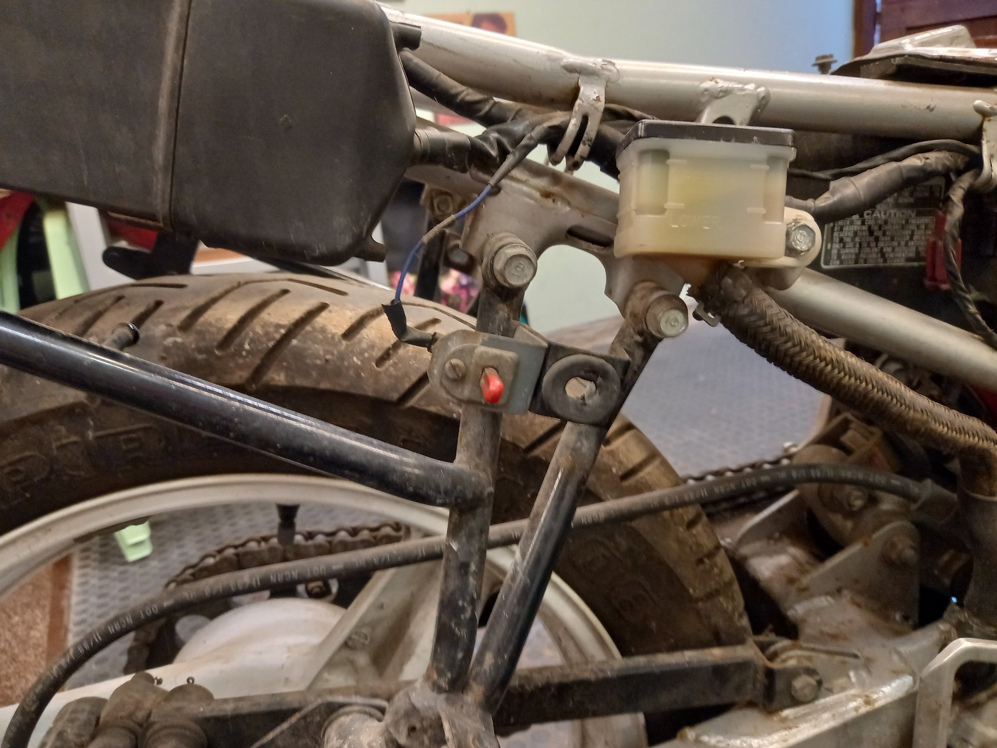

Default photos
attached photos of button switch.
this is the switch, its a push button type.
Old Nov 19, 2021 | 10:32 AM
jklett's Avatar
Joined: Aug 2021
Posts: 15
From: New Jersey
Alarm override. Checks all the boxes= hidden behind fairing, makeshift bracket, flat screw, wiring doesn't match up with factory harness.
Old Nov 19, 2021 | 05:03 PM
I would agree. That is not factory at all. It's amazing how much a picture helps.
