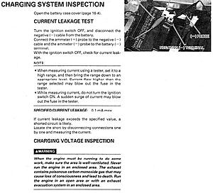

Hi Dan. Would be great if you could pull out your Factory Service Manual and let me know the MAX Current Leak figure for my bike as I only have a Haynes Manual.
Old Apr 4, 2023 | 09:17 PM
dannoxyz's Avatar
Posts: 1,988
Likes: 439
From: Mesa, AZ

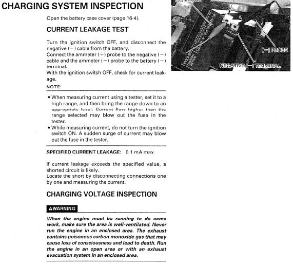

Sorry, appears I maligned Haynes prematurely when they correctly copied factory-manual for this spec.
1. unplug yellow-wires connector between stator and RR, does drain go away?
2. unplug red connector at starter-solenoid, does drain go away?
Is battery dying between rides due to this drain?

Thank-You Dan. That is EXACTLY the confirmation I was looking for.
I definitely have a drain.
The search continues!
