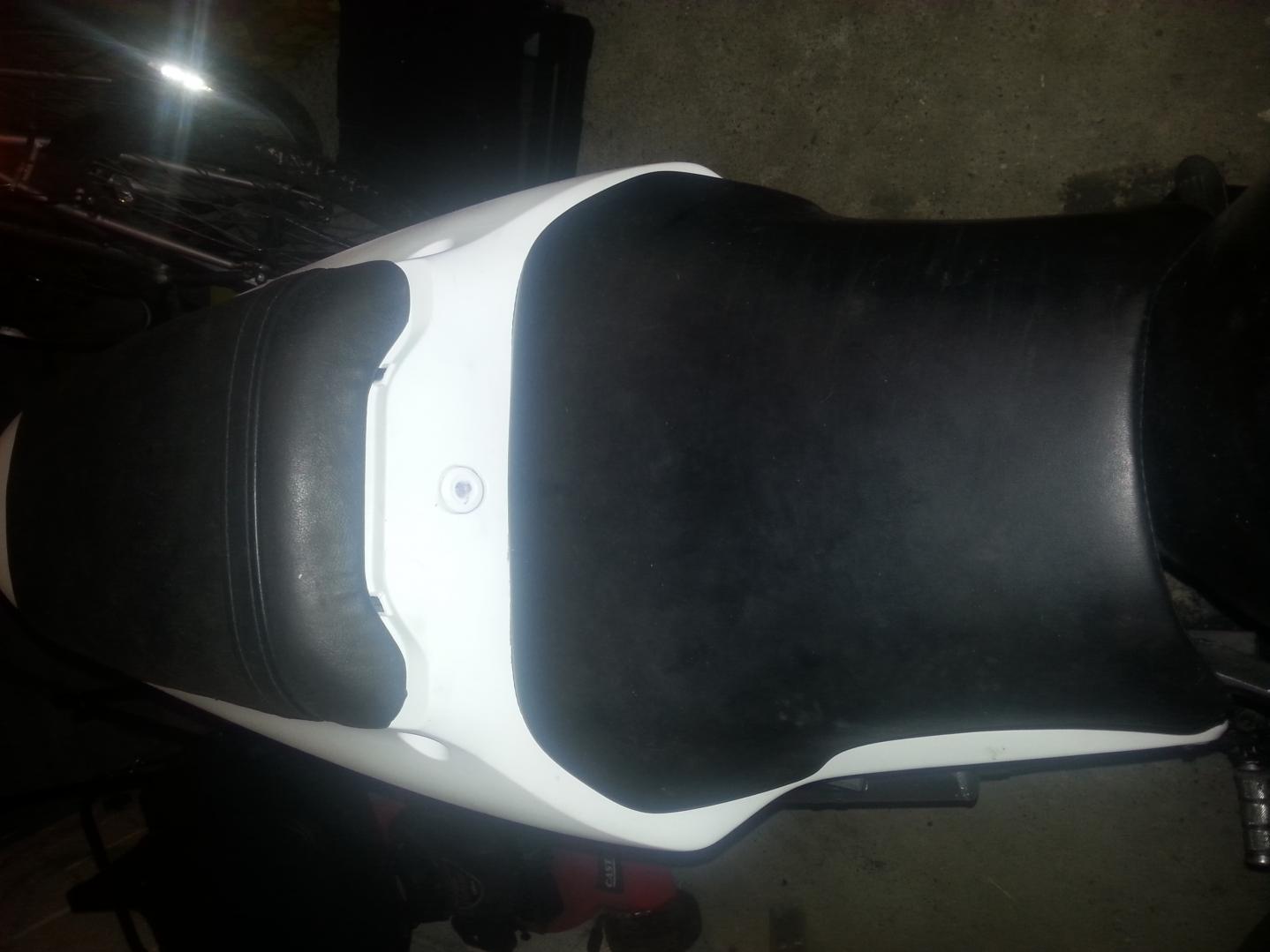

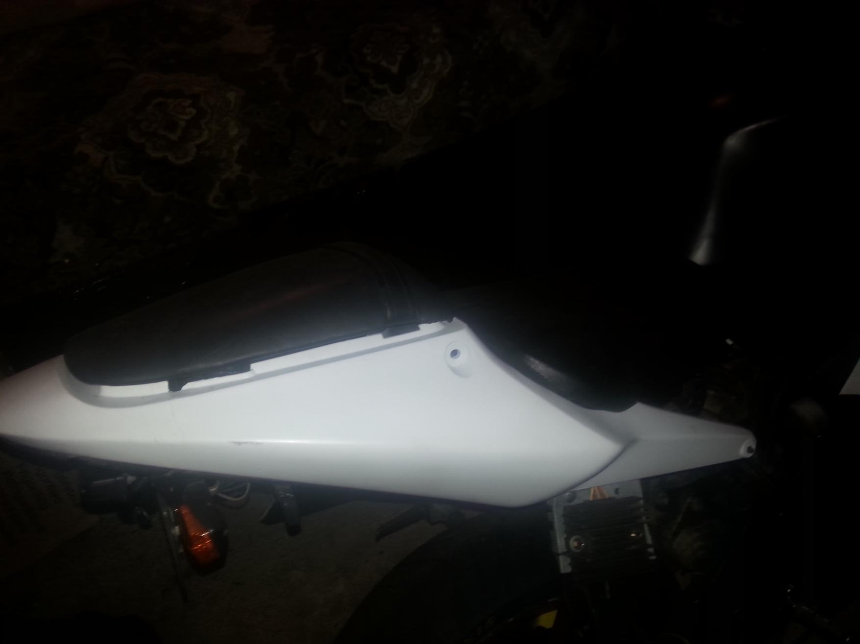

That's definitely a 954 tail. And if you look closely, you can see the 954 subframe on there too. It looks like they modified the frame so that the 954 subframe you bolt on. It looks nice on there, but if you want a 600rr tail, Look for one on ebay or in your local classifieds. Since you have a 954 subframe on there already, I would look for 954 fighters online where people have put 600rr tails onto them (there are quite a few). That'll be the easiest way to adapt a 600rr tail onto your bike if that's the direction you want to go.

Thanks, Looks wise there's not much in the difference so I'd prolly go with what was supposed to be there. On a scale of 1-10 how certain are you? I took some more pictures there for more detail.

Hate to burst your bubble, but going back to factory is pretty much out of the question except for a frame swap. The PO cut off the frame and welded a tab so that the 954 subframe could bolt on.
Honestly, as long as the welding is good - it's going to be better than factory because that aluminum subframe is a ton lighter than your stock steel subframe was.

10. There's no doubt about the tail. It's definitely a 954 tail. As far as the subframe - it's definitely a 954 one as well. I can't completely tell if it's been modified at all because I can't see all of it. But I can tell by the plates where it mounts to the frame and the distance between the plates and the support beam that it is a 954 subframe as well.

Wait till you see where and how the rectifier is mounted

So you have that frame too? That's a good buy for 150 euros! Well, you wont have to worry about the R/R not getting air flow, just make sure it doesn't burn your leg if it gets hot.
I was just stating that the guy cut the subframe for your bike and welded on plates - so it basically wouldn't be able to modified back to factory, you'd have to frame swap it. If you don't like that tail/subframe, or you worry about it's strength, it wouldn't be hard to frame swap your bike.
But, you could clean up the modified bike. Most of it is just wiring, and adapting the CDI and everything to where it'll fit with the modified subframe. (and grabbing the better stuff off that second bike - like the air box).

Hard to see it overheating there, the mount it's bolted on can only be described as a butchered car radio to dissipate the heat or something. I'm sure there is a mounting place somewhere on the subframe. I've just lumped the CDI under the seat, there's a little cubby hole there that it fits in. It was a pain when I changed the wiring loom to figure out where it all goes. I'd say they bypassed the solenoid somehow as they had custom gauges on it. I got the stock dash when I did the loom so it's all back to factory now. I've been out on it several times and there isn't any glaring problems engine wise, I got ~100 mph easy enough with no flat spots so it's good to go as it is but its ugly still.
From a once over of the welds the frame looks good to go so I'll probably keep that frame instead of swapping, the only thing holding me back was that I wasn't sure what the tail was off of. Could end up with 2 bikes the way things are going. I got onto my local breakers there and they have a 954 for breaking so I'll probably get the tail if its in good condition and then it's pretty much a respray and away we go
