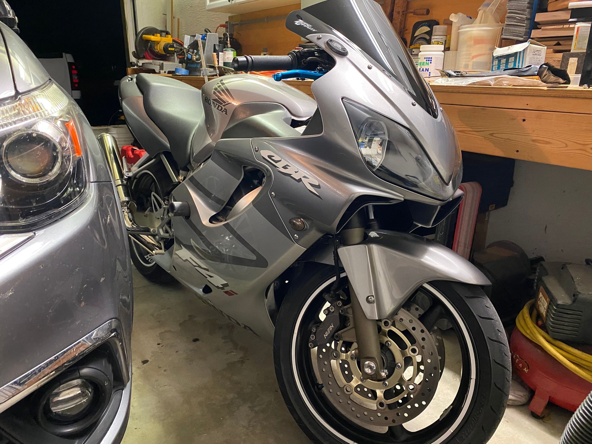

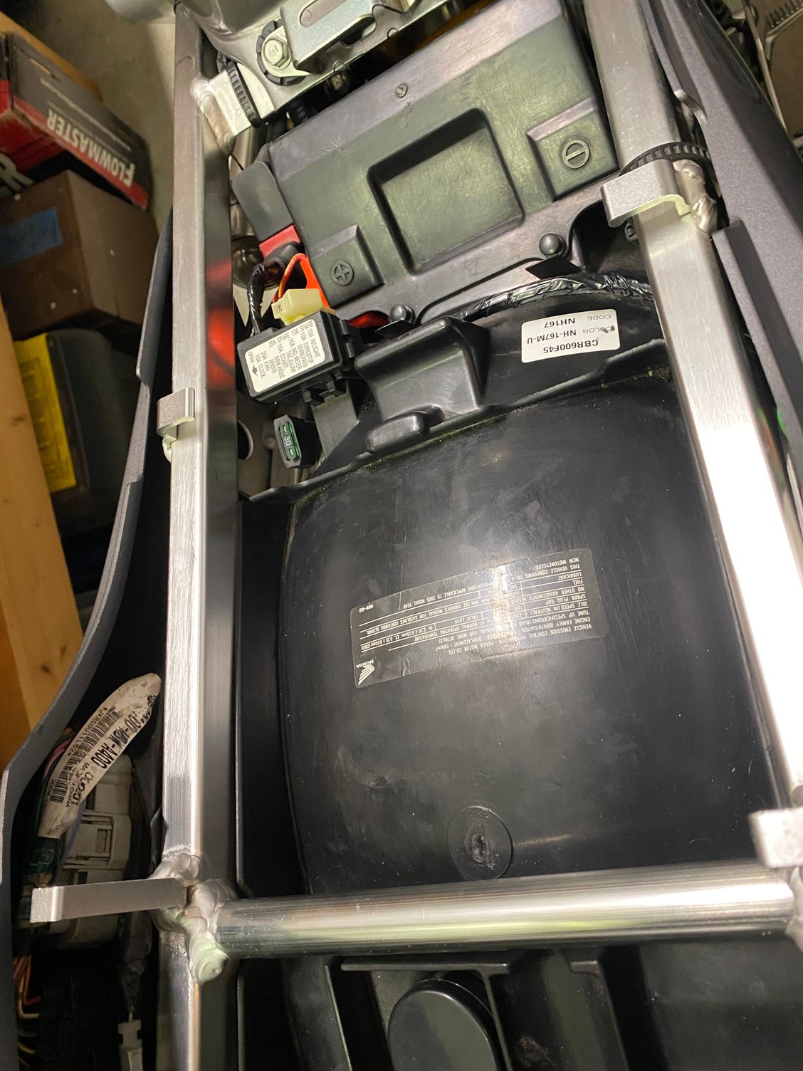

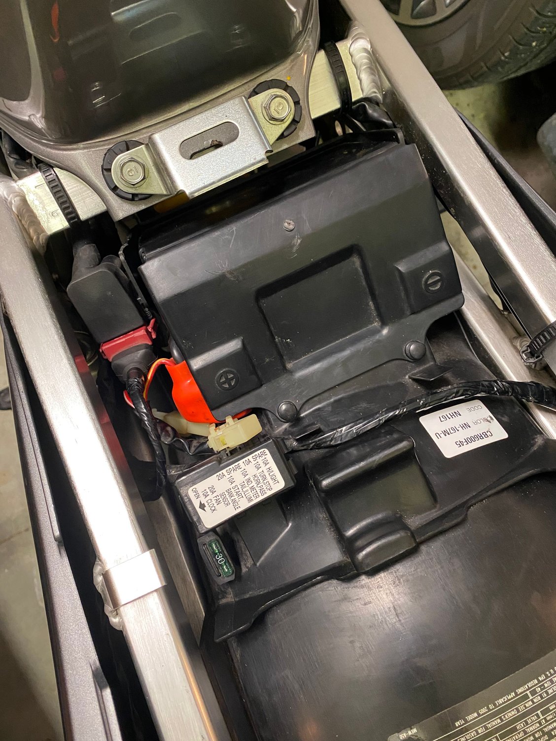

Hello, I’m Nicholas from Cape Coral, Florida. I just picked up a 2005 Honda CBR 600 F4I and rode it 1 1/2 hours home. Bike did amazing but noticed the FI light came on, bike still has less than 10k miles. The MPH reading does not work… I’m assuming it’s turning on because of the faulty sensor but wanted to check by using the paper clip in the service connector but can’t find the connector anywhere. See pictures below, if anyone has ideas where it may be, let me know, thanks!

Found the service connector, was further back than expected. Closer to the brake light than the battery, codes #9 and #11 came up which is what I expected. I know I need to replace the vehicle speed sensor and check the IAT sensor. Does anyone have part numbers for these sensors, thanks!
