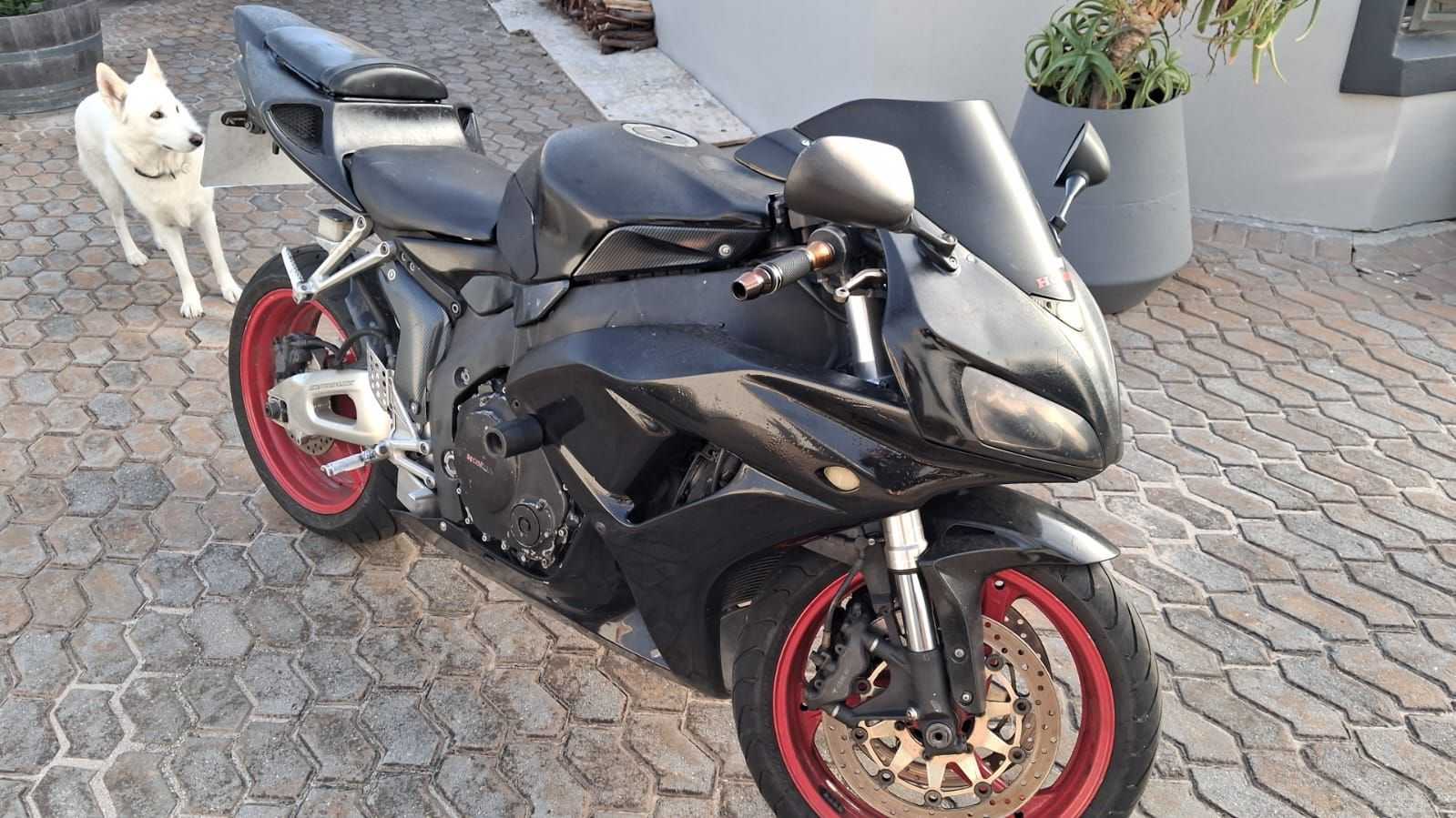

Last year I got a 2002 Honda Blackbird, really loving that machine!!
And a couple of weeks ago I got the brainfart to buy a 2007 Honda Fireblade 1000 (in much need of TLC and a engine knocking noise). After watching too many rebuild videos on YouTube, I thought to myself: "Myself, I reckon you can do this" and so I did.
At this point in time, all symptoms point towards the valve clearance and that is where I'm headed next. Hopefully a couple of shims can sort out the issue. My first stop was the Cam Chain Tensioner and the Chain Rail but they are just peachy. Other than that the bike is in good shape, she sounds like a monster. Still want to replace the radiator, fairing, grips, etc, etc.

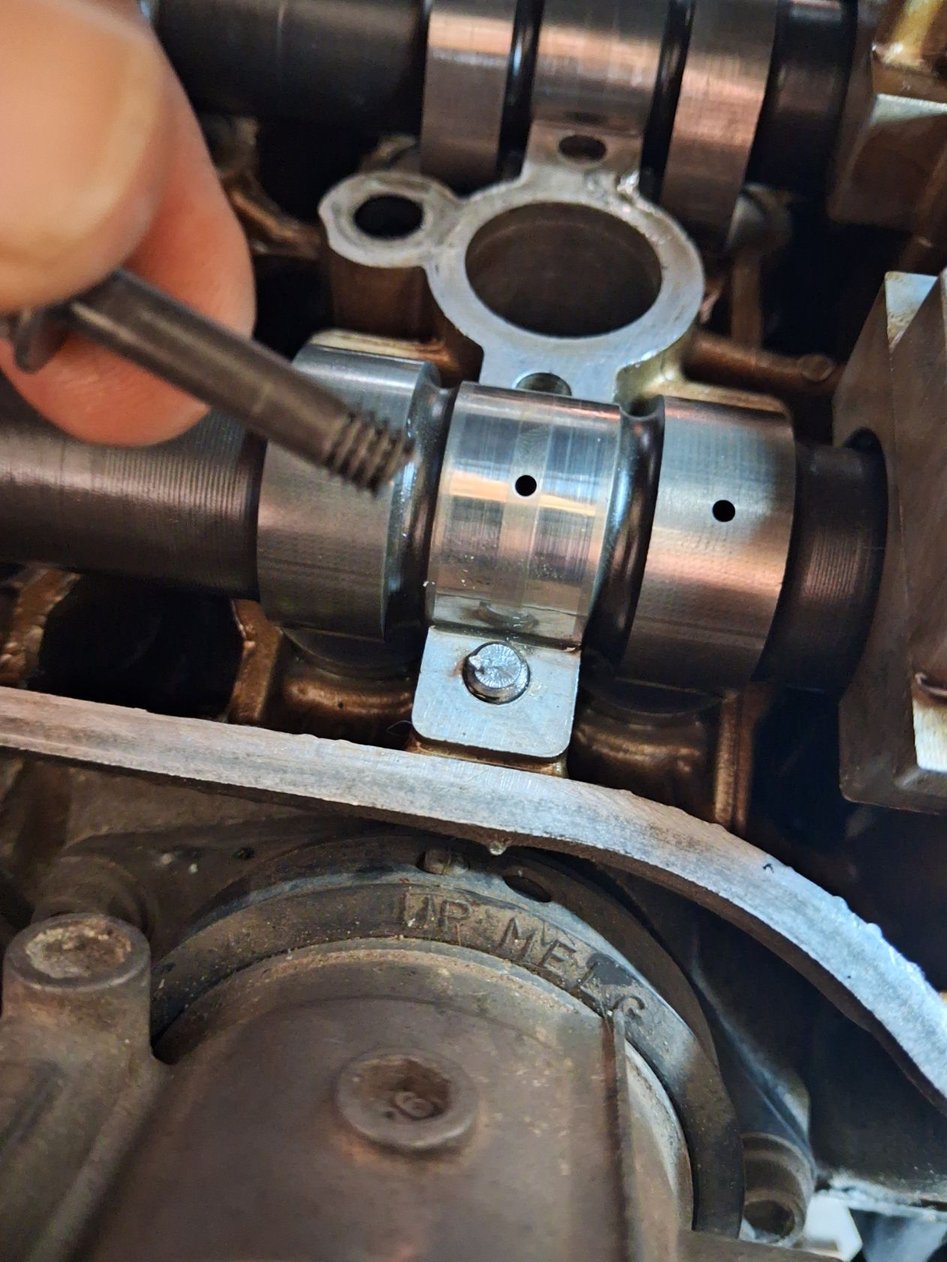

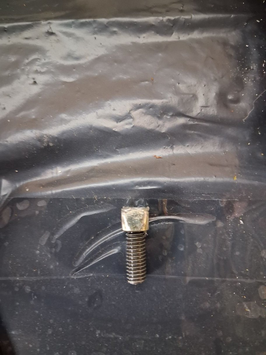

Latest update, I managed to get my hands on a box of Shims which thankfully had the six that I needed. Manage to replace the shims, install the camshafts, timing chain and onto to the camshaft covers.
And that is when it happened..... the snapping sound of a bolt giving up on life. At first I thought it was the torque wrench.....it wasn't.
Thankfully I was left with 1mm+ of thread and stuck a bolt on there with Pratley Steel. Left the little f#cker for 24 hrs and was able to just unscrew the remaining piece......unfortunately the bolt that I attached was slightly too big to turn, unless I removed the camshafts again. Which is what I had to do.
So there has been some back and forth, picked up a replacement bolt this morning, next step is to get the camshaft covers bank on and start reassembling.

Nice fix.
I've had some success with stud extractors but that can leave swarf in the engine

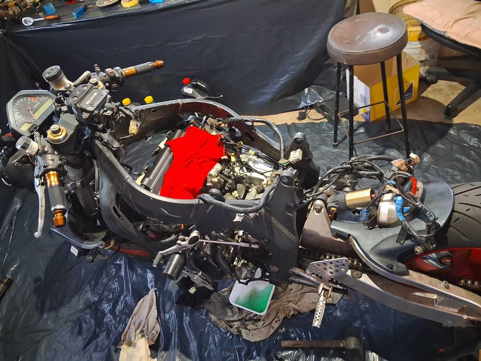

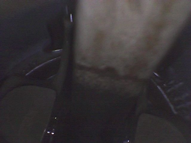

Soooo it has been a while. After replacing the busted nut and putting her back together, I managed to bust another one. Long story short, I put her back together again and the bike wouldn't start. Eventually I ran the battery down, so that went away for a recharge. Plugged the battery back in and still no luck, strip the bike down again to find that my timing was out. Put the whole engine back together again and she started!!!
It was a proud moment considering I have never stripped an engine down that far. The moment of joy was short lived as the knocking noise is still very much there. I pulled the oil pan, stuck a camera in the engine and found the source of the knocking sound. Broken conrod!
Have stripped most of the bike down, going to see if I can remove the engine bolts but keep the bottom one in, and pivot the engine onto the ground. I should have decent clearance to get into the top and bottom end of the engine. Just need to do some homework on how to calculate the rod bearings.
The journey continues....
