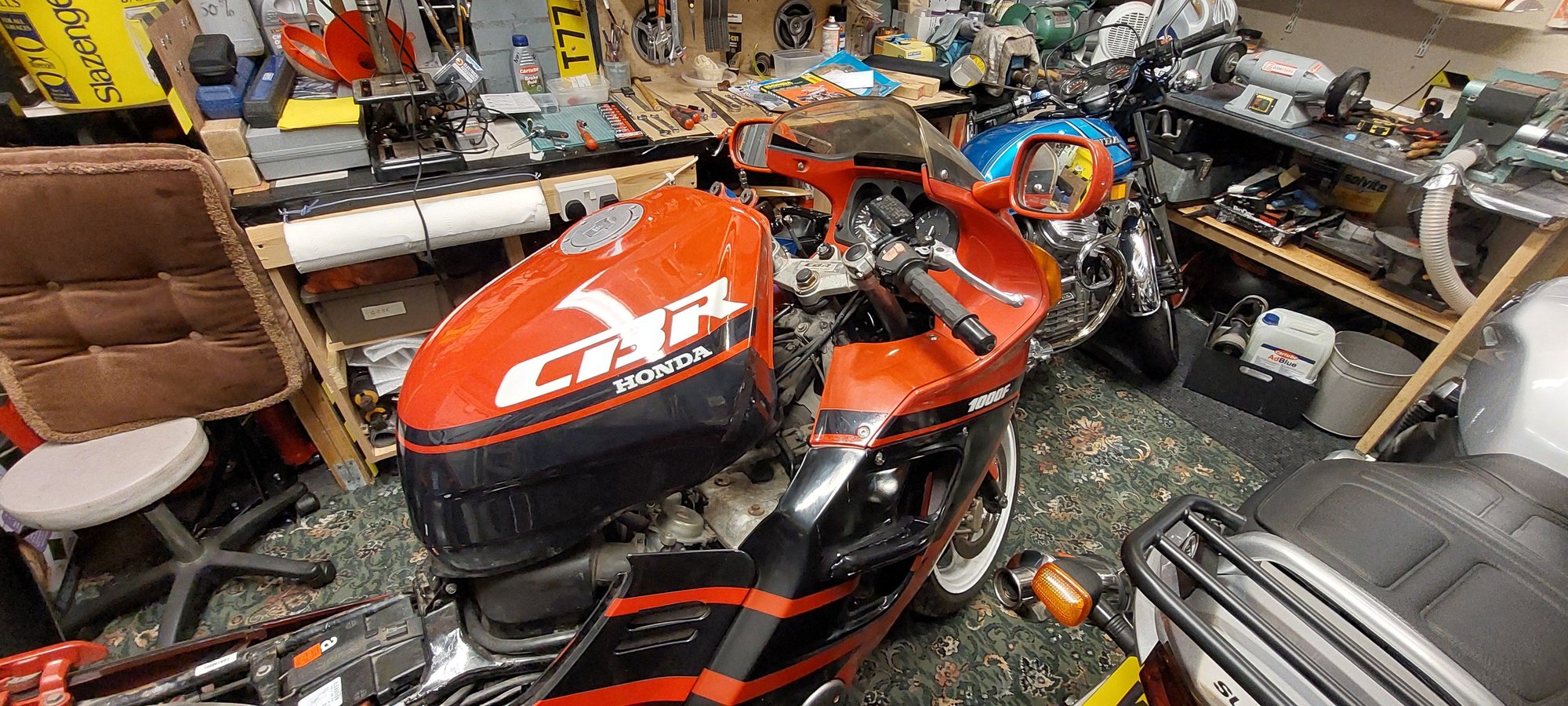

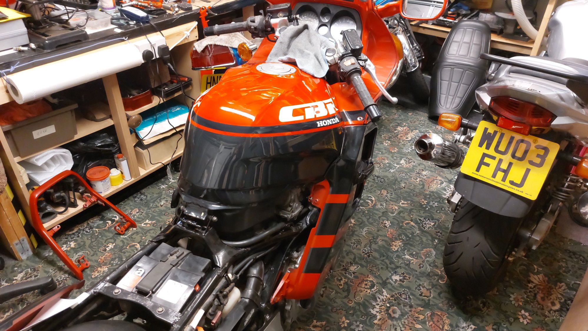

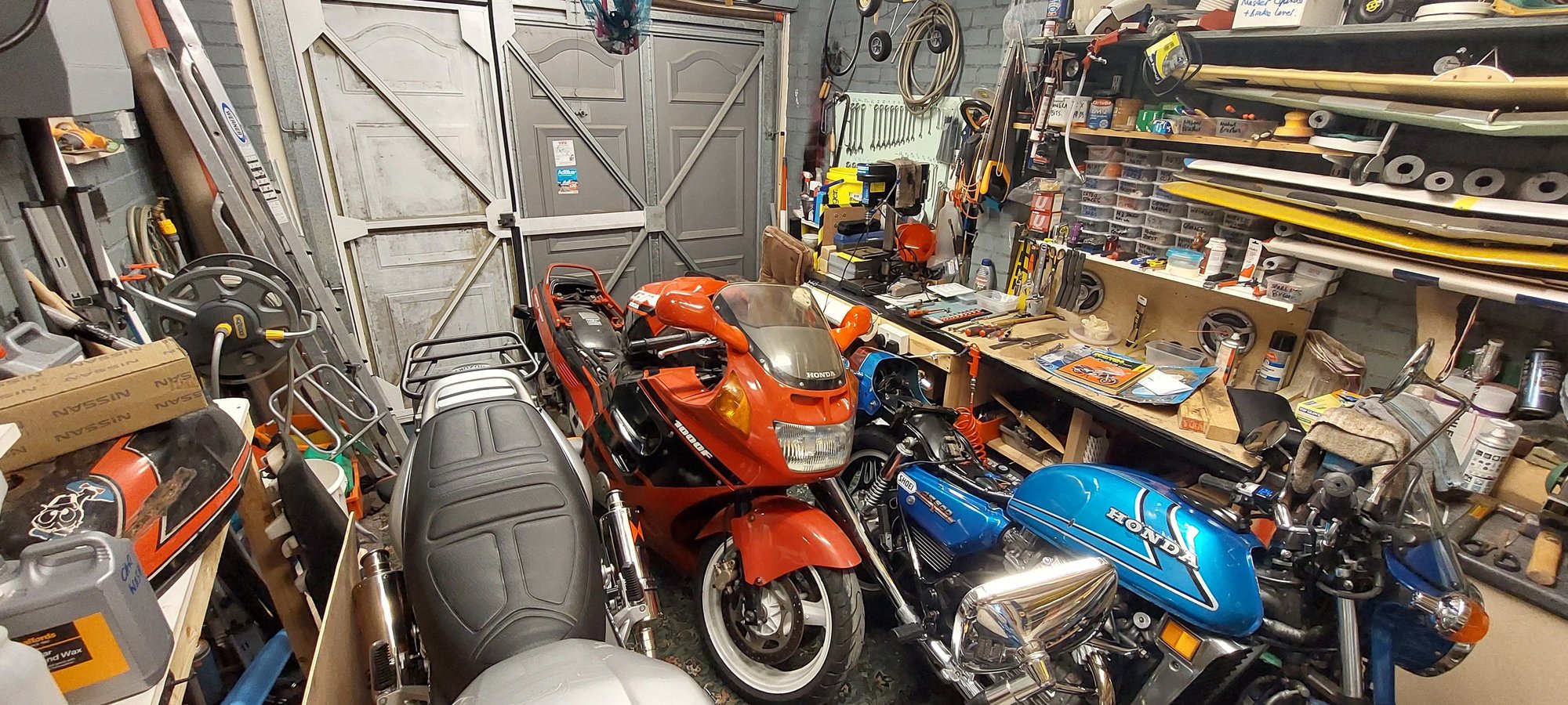

Got there and the Bloke is gutted as the clutch is now working......Still only firing on two tho, two adjacent on the left as you sit on the bike. So has to be carbs not coils.
Bike is now crammed into the garage and ready for inspection !!

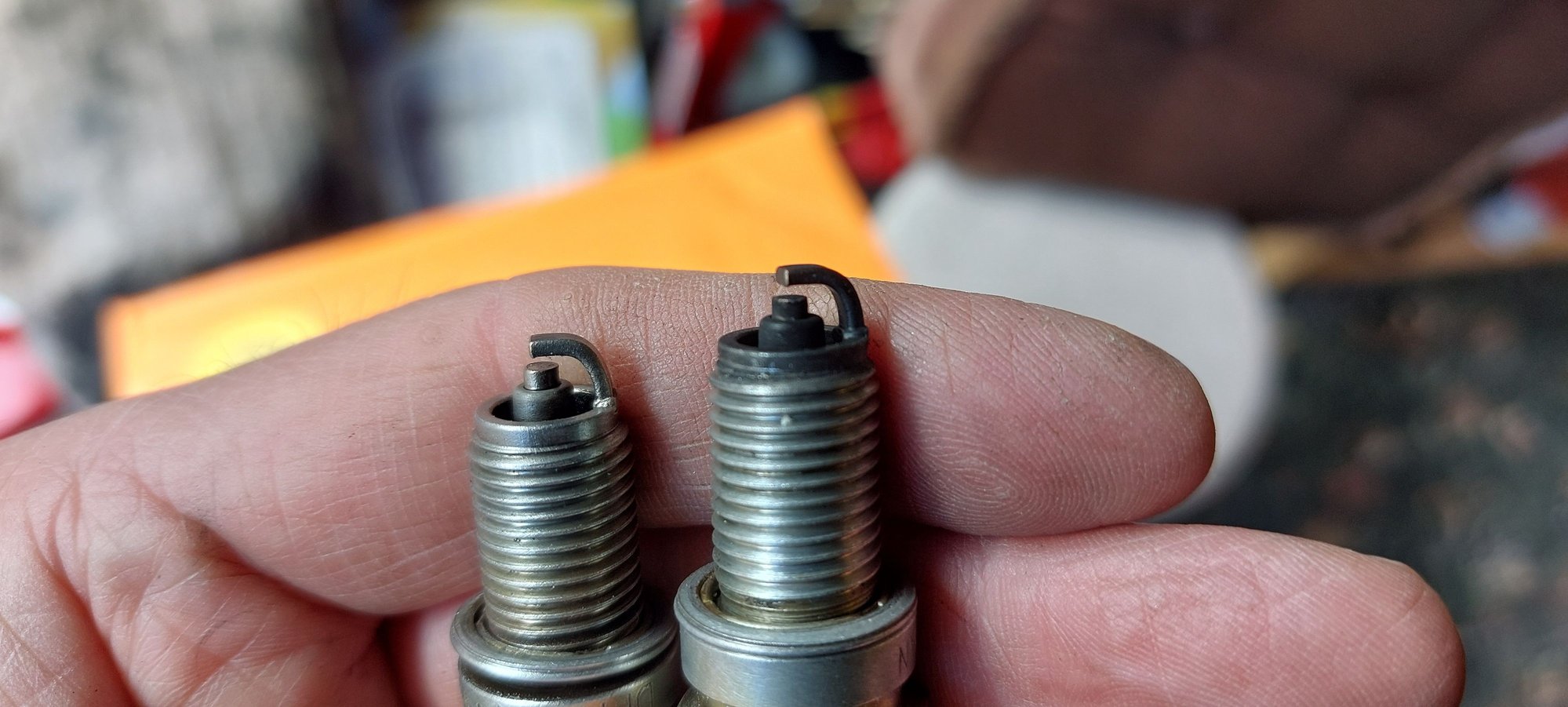

So today I got stuck into the CBR, the plan being to figure out the problem with the two cylinders (1 and 2) As I said, I ruled out bad coils as that would have shown up as 1 and 3 or 2 and 4.(or similar) .I checked for fuel in the bowls, there was fuel. New Plugs were new fitted by P.O. Next, I got plug number one out. I had to get a wrench onto my plug spanner to crack it, God knows who torqued it down this hard, as you know it should be finger tight and a nip up....
Anyway, I tested the one plug I knew was good (4), in position one. good spark. OK ....... Tested the original plug, OMG..... lol, Sparking and arcing all over the place. I pulled number two, the same. I had some old plugs I took out of a CX500, same spec, apart from temp (8 instead of 9). I banged them in and Boom, firing on all 4 cylinders like a Good Un.
All I can think of is that they were cheap Chinese copies, that he had bought unknowingly, as plugs are stupid money nowadays, or the insulators had been damaged from being tightened down so hard ?

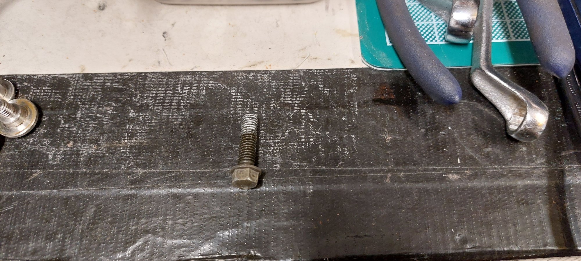

I dropped a screwdriver bit in the bike and it didn't come out of the bottom, so a mad search ensued. I Found a bolt in there that some one else had lost at some point as well as my bit.
D.D.
Loose bolt, looks like a tank retaining bolt to me.

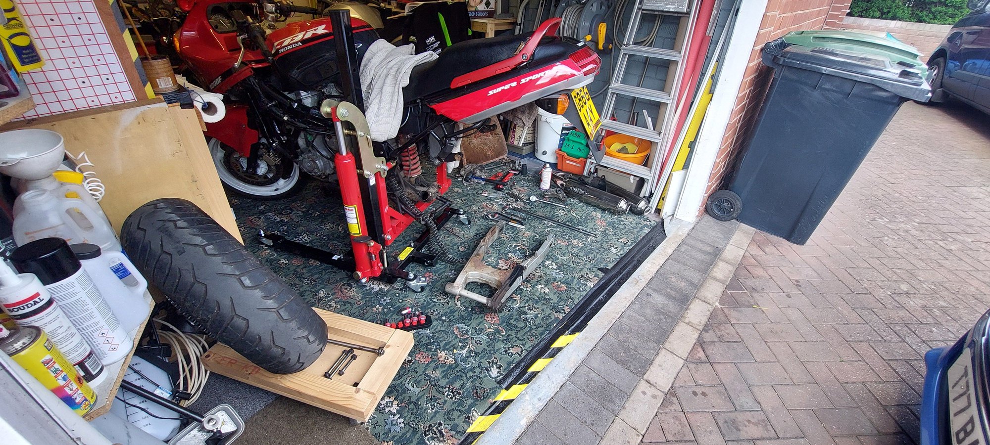

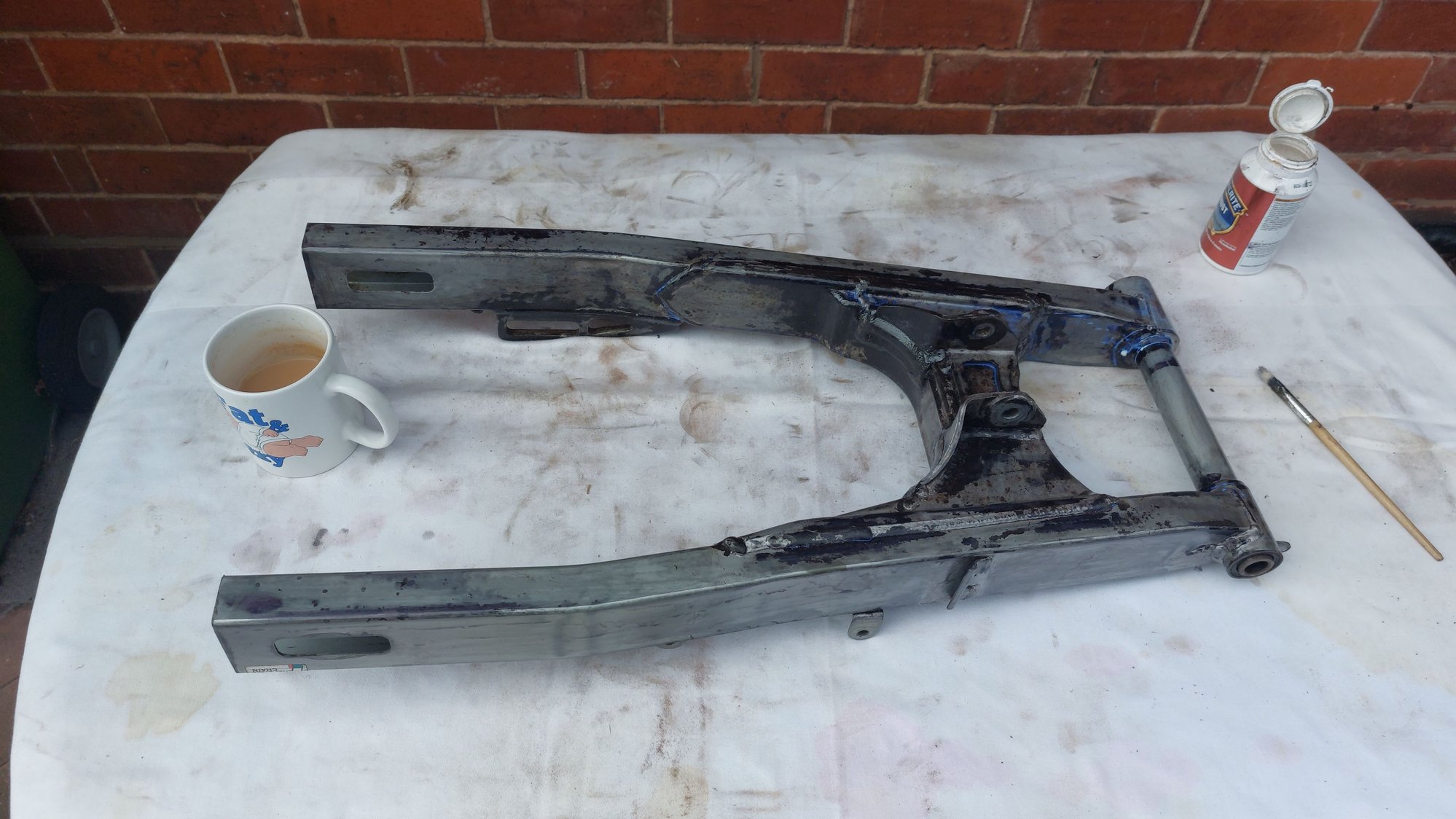

I got the swing arm and the shock out today. I'm going to paint the swing arm after cleaning it up and give the shock and pivot a good clean and check the bearings.
D.D.
Years of grime.
Lots of rust but only on the surface.
I made my own lifting kit for the Abba skylift using their swing arm kit. To be fair all I had to do was cut the bolts down a bit.

Shock is out and the swing arm is rubbed down and treated.

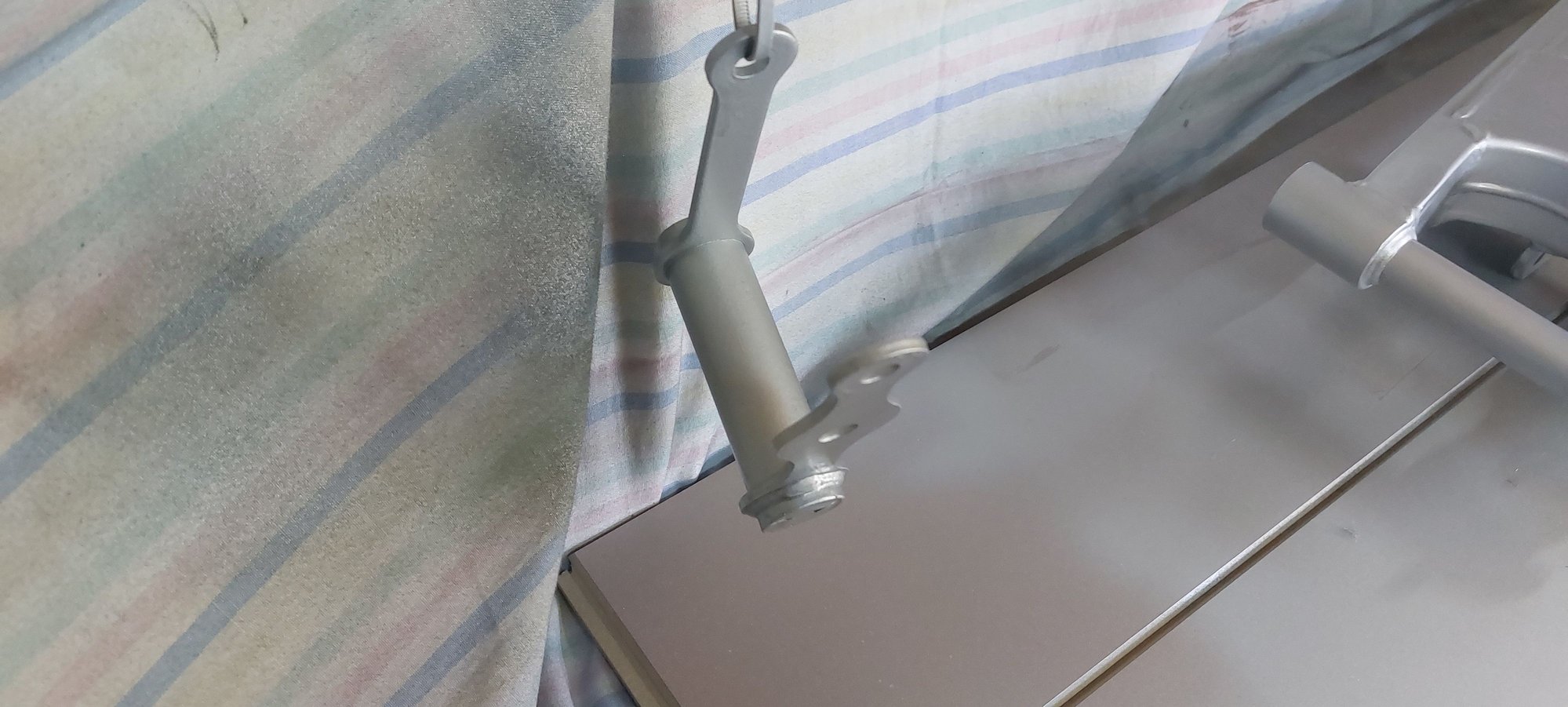

A few more jobs done today.
D.D.
Swingarm painted.
Suspension frame link.
Shock cleaned up ok.

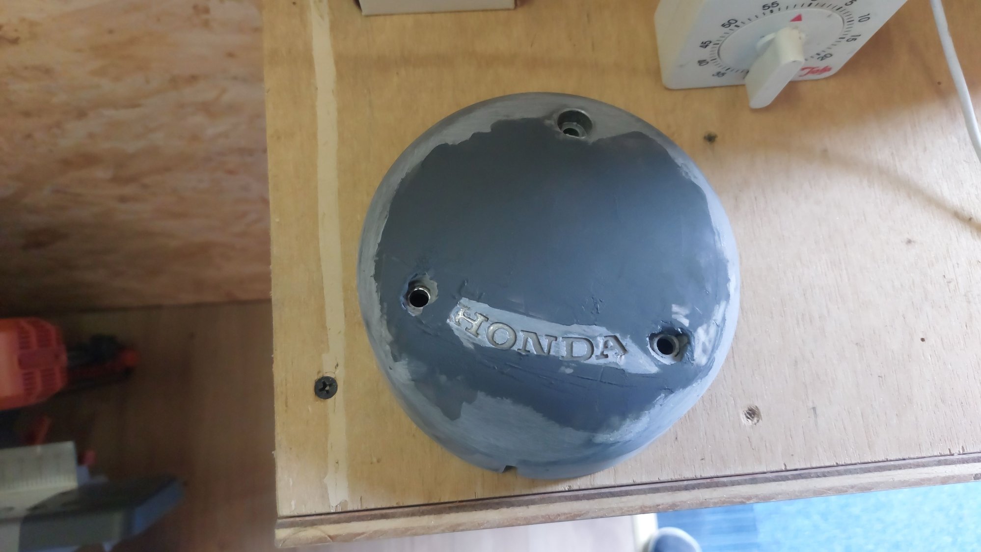

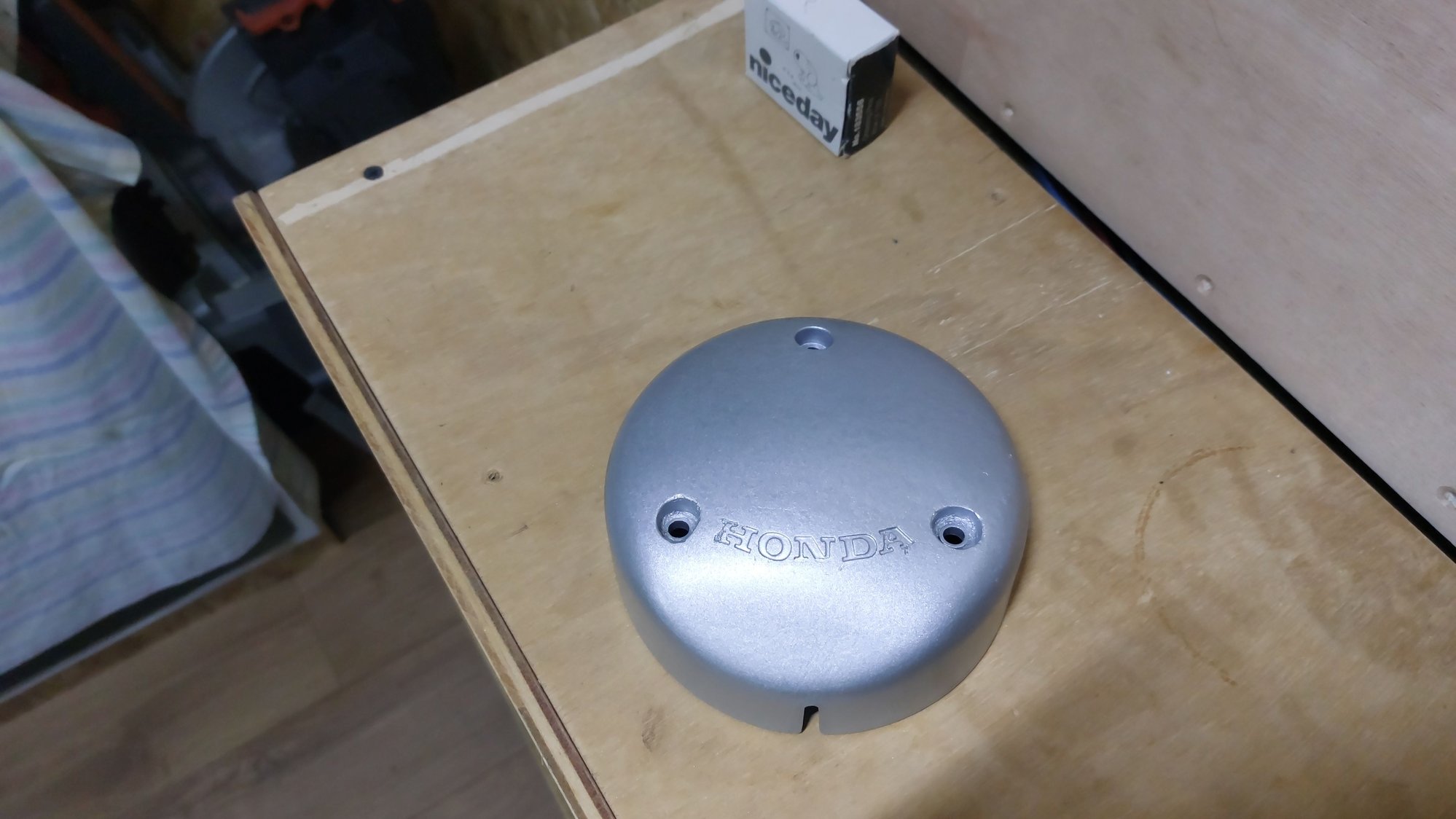

I had to repair the side cover, it was smashed right in from a drop.

Thanks Ed, got some paint on the cover panel too.
D.D.
Before.
After.
Old May 8, 2024 | 04:16 PM
Ed Harris's Avatar
Joined: Jul 2023
Posts: 468
Likes: 125
From: UK,East Midlands
Woah, what paint is that?
