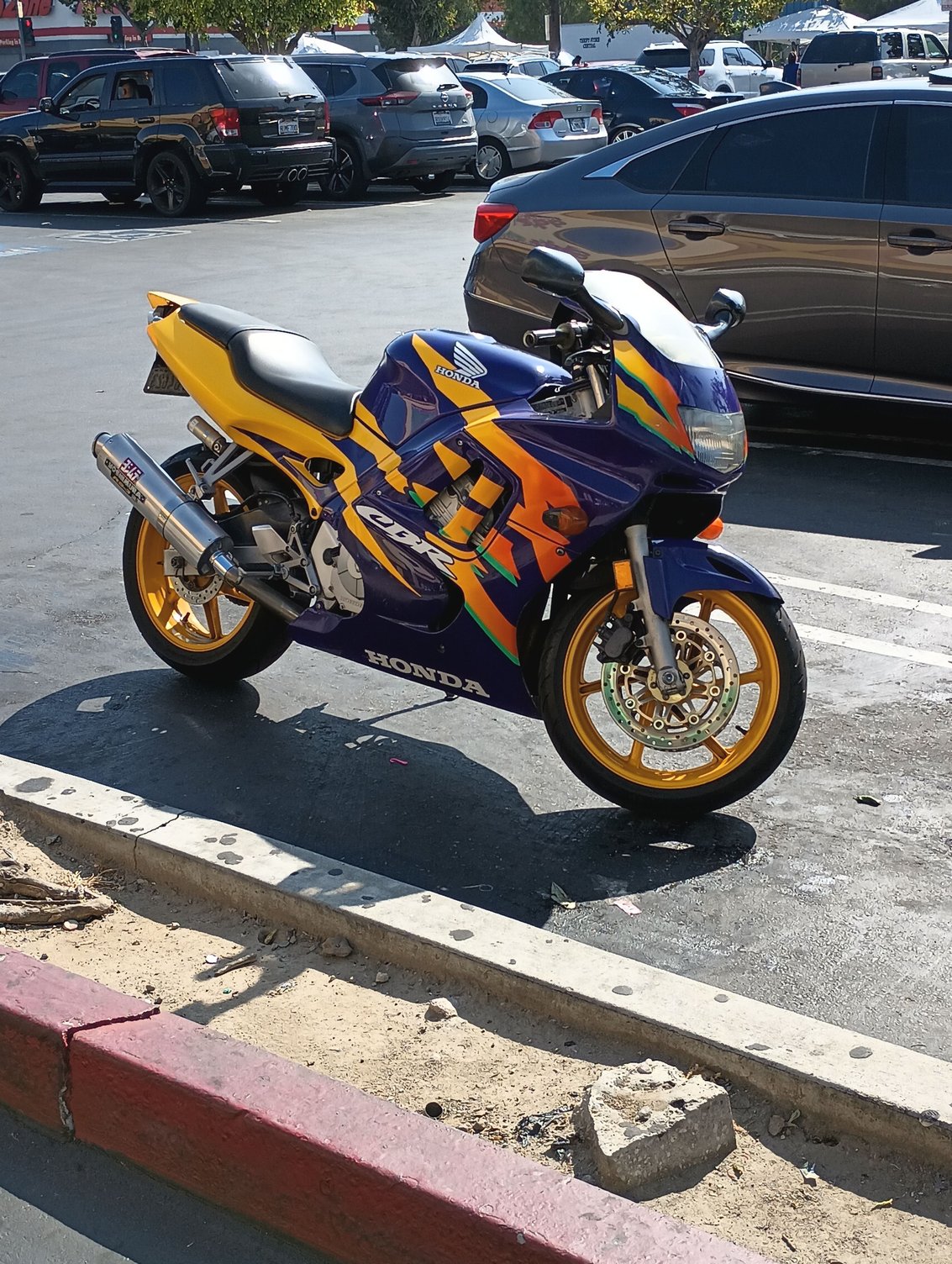

That's an awesome looking bike!!

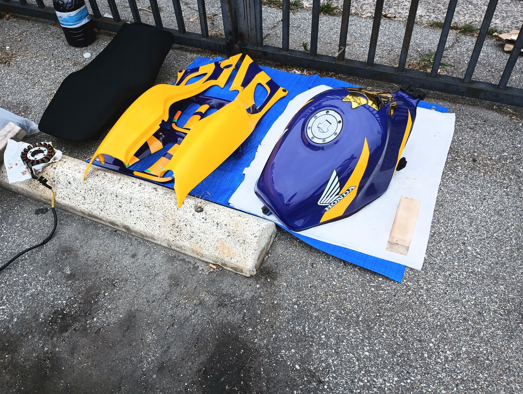

Ummmm, yeah. 🫤 The new stator (Caltric) lasted less than 100-miles and burned out (120mph riding aside). I humbly acknowledge my stubbornness and defense of the cheaper parts when my mechanic, members here at the forum, and my towing guy all advised me to get OEM or Rick's. 😞
A brand new Rick's stator is on the way and I'll do the swap again. 😁
