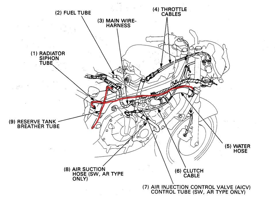

Hey new member here dunno where I’m posting this I’m trying
just rebuilding my 93 f2 and can’t for the life off me rember where the coolant bottle hoses go can anyone help please thanks
Old Aug 23, 2024 | 04:32 AM
Posts: 2,577

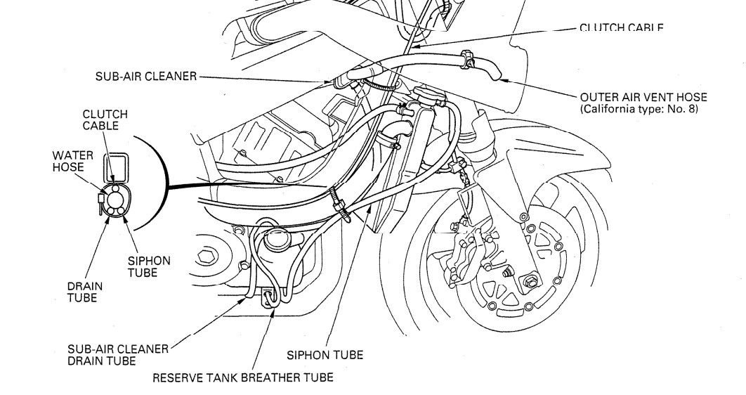

Welcome to the forum, unfortunately I do not have an F3 manual, but here are pictures from the earlier model and the F4 so might be of some help.

There are 2 hoses from the coolant reservoir, the one on the bottom goes to the radiator (to the radiator cap) its a return line and the one on the top of the reservoir is dor overflowing and it goes from there straight to the floor, that one is for venting and overflowing
If you need some more info from the workshop manual send me a PM
