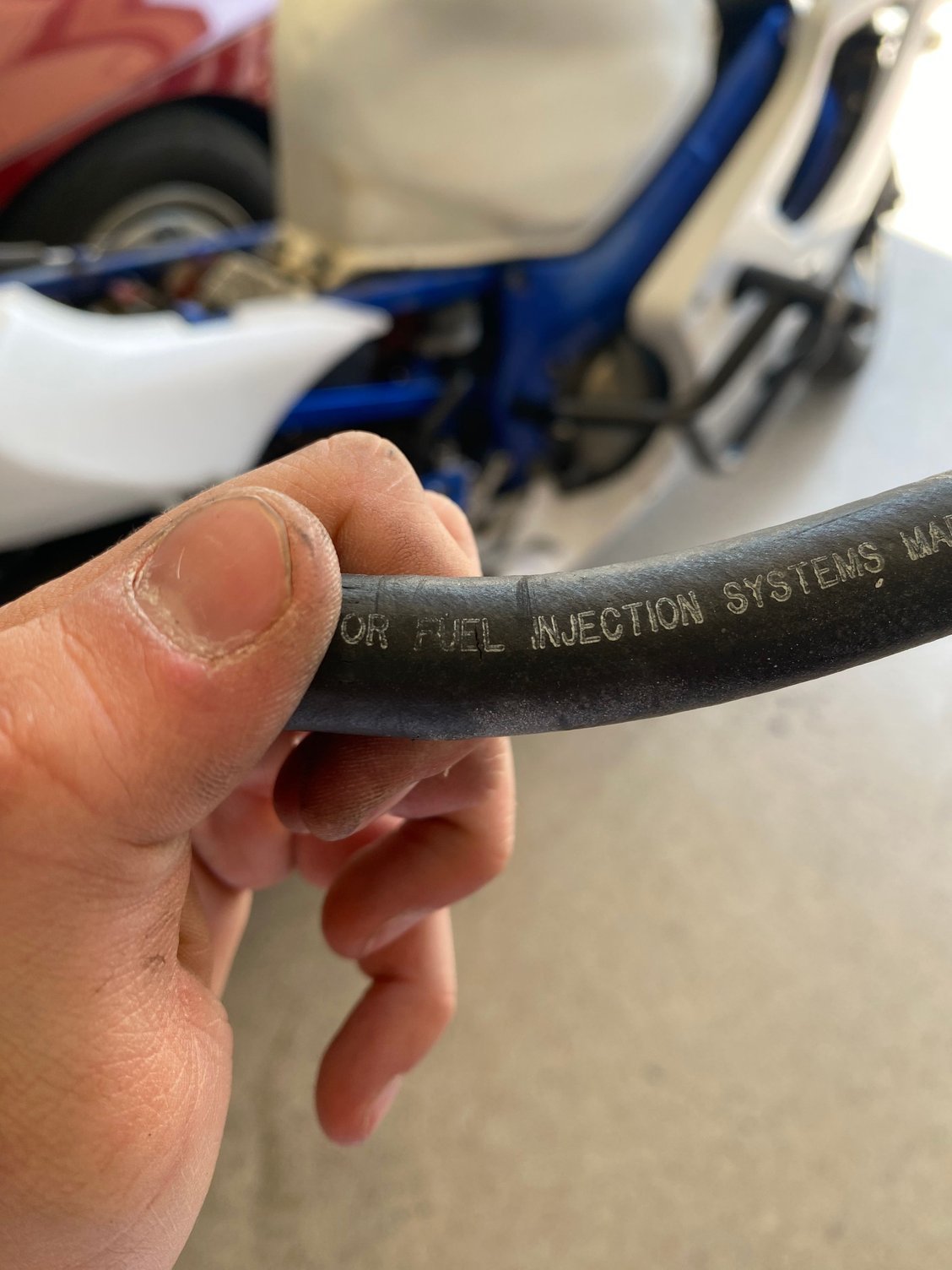

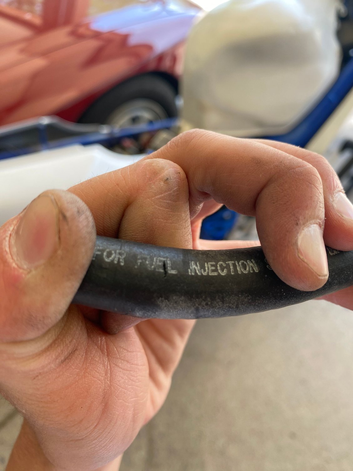

Default I think I fixed it.
So while taking off the tank everything seemed fine. Buttttt when I went to take off the fuel line to the tank I noticed a little hole. If it got stretched a little bit it would open up. So I think at the higher speeds that was opening up and leaking out gas so that’s what’s causing the decel. I fixed it now and it runs good. I’ll have to test it on the highway to make sure that was the issue.
I did leak out of that hole when I tried to take the tank off.
also side note. Bought some seafoam. Gonna run some of that over the next 2 tanks just to clean the carbs a bit. Can’t hurt to try.

Fantastic, great spot. Fingers crossed that sorts it.
Not sure about the Seafoam and whether it will do any good. It does not have PEA in it which is what you need to clean the crud out of the carbs etc.
Something like Techron PEA Concentrate Plus is what you are after.
