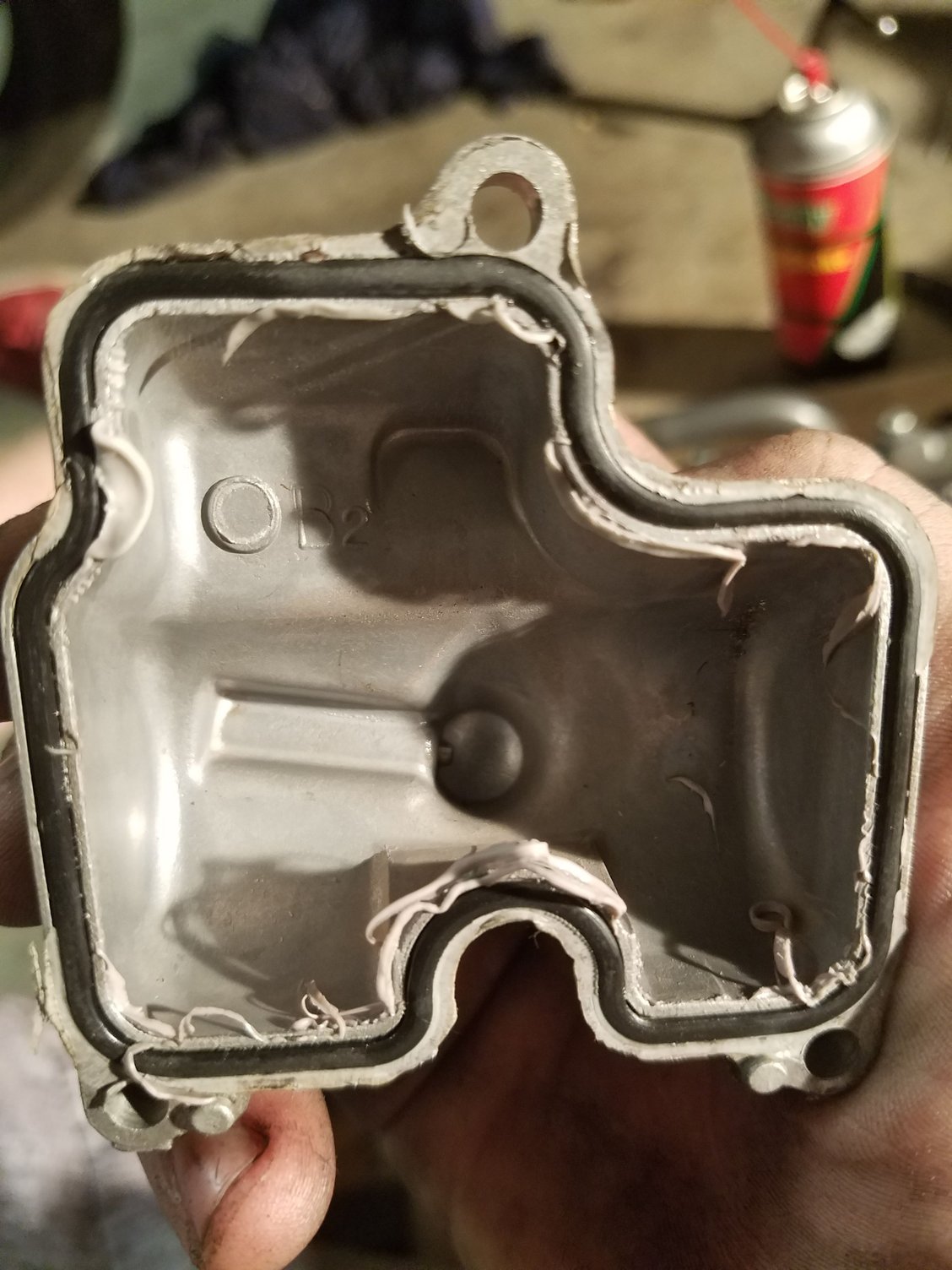

So I'm having a little trouble diagnosing my bike. It's a 1998 cbr600f3. It started having some carb issues a couple months ago and so I had somebody rebuild them completely with all new Jets needles floats gaskets and o rings. It ran great for a couple of months.. And then started having a bunch of electrical issues with the fuel pump. I got all that sorted out. Fuel pumps working great , it's brand new. but when I get to about 5 to 7 RPMs it starts sputtering and total power loss. Definitely feels like a fuel issue but it can't be the carbs because they were so recently done. When the bike is in neutral I can rev it up past 7 and it sounds super clean. Doesn't stutter at all. But as soon as I'm in gear it feels like a fuel starvation issue. I've changed the stator, the regulator rectifier, the fuel cut relay, brand new fuel filter fuel pump and air filter. Also new spark plugs. I have no idea what it's doing but it's really starting to **** me off. Any help would be much appreciated

Awesome thank you for your response! I think you're 100% right. I pulled off the air filter air box and intake ports yesterday and noticed that the slide in carb number 4 wasn't going up with the rest. It wasn't physically stuck, but it wouldn't left with the rest. I took the carbs off today and thought it might be a tear in the diaphragm so I open that up and there wasn't. I think it just wasn't seated right. Anyways so I got that all sorted out. Now all four slides go up in sync. It improved my power just a tiny bit. but me being in such a hurry to get back on the road and me being a dumbass I didn't even think to open the float bowls and check the other three. Even after I found a little bit of silicone type gasket sealer inside the fourth 4th float Bowl. To be honest I was just a little intimidated because I've never cleaned carbs and I didn't want to take them out of sync. Especially because I don't have carb syncing instruments. But anyways, I'll do some more youtubing on how to clean them properly and I'll be back at it tomorrow. Thank you again for your response

Thank you everyone for the responses! It was in fact clogged jets. From the gasket sealer the mechanic used. It's back on the road and with more power then it has since I've owned it

Great news. Glad you got to the bottom of it. Just an FYI, The bowl gaskets do not require sealer if the are in proper condition.

Gasket sealer? WTH?
I use silicone grease on the rubber gaskets, but sealer is a no-no.
