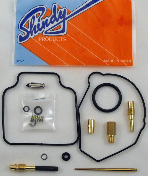

ill try the spray test and get back to you . the bike idles fine with or without the choke. it dies around 2-3000 rpm when reving if the choke is on, and around 5000 with choke off. when reving up it starts to putter like an old flappy assed fart, like the diaphrams are fluttering. smells rich from the exhaust too. I did not ajust the pilot screws, i cdidnt see them ant the manual doesnt mention them. so about the floats....... the y looked ok to me and had spring to them from the lil spring thing. i dont know what its called. but I dont know...does it matter when you put the float spring thing in if it fce one way or the other. in this image its the black tiped short metal piece in the bag. but i guess ill have to take them apart again and check everything.

that image is here actually. and i guess its just above the plastic bag
http://imagehost.vendio.com/a/370164...8_CARB_KIT.jpg

Yup , thats the float valve, and thinkin about it , when you put the float back in the body , posibly your float valve slipped off of the float during assembly .
