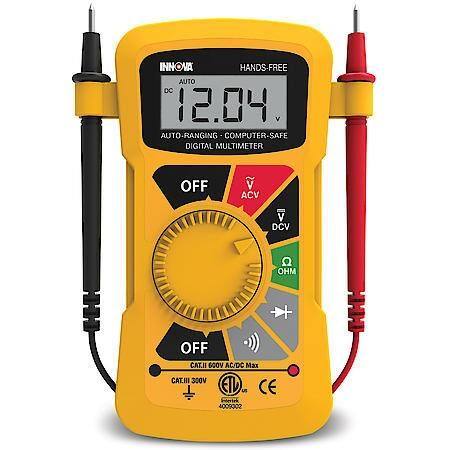

Hmmm, ok I'll take a look at the wiring diagram tomorrow and see what's happening. Clearly a dead short on the down stream circuits from that Engine Stop switch (kill switch). And just for clarification, that's the one on the right throttle control assembly correct?
Old Apr 20, 2021 | 02:02 PM
So, do you have a meter, an analog VOM or a digital dmm? If not, you need to get one. They are not expensive. You can get one a Walmart, Amazon, most parts stores will have them.

hey sorry I dont know how to reply so I just clicked quote. Haha but yes that's correct it is on the right. And also i have not the slightest clue as to what those devices you mentioned are but I'll be more than happy to look them up and purchase one. 🙂 also thank you soooo much for your support

Ok Thanks! I found it. Quoting seems to be best when you want to respond to a specific person while reply is to the original poster. 🤔 cool! Also I looked those devices up and much like you I know what they are and have only used this one(pic below , above, sideways, or wherever it'll pop up&#128514 to check battery level. I hear nightmare stories about electrical problems with bikes so I'm sure that you're right about a learning curve dealing with electrical issues. 🙄😩

OK, well continuing with the logical question is ok, you have used this one. Does that mean you're in possession of it or just used it in the past? If you don't have one, then pick up an inexpensive one locally. I'd also recommend watching something along these lines.

I still have it but I'll get one of the models as shown in the video. Also that YouTube video was pretty helpful

The issue have on your bike is that you're blowing fuses. More often than not it's a broken, pinched, or bare wire that is touching the frame. That is a relatively easy thing to find with a meter. Once you have it, we can go from there.
