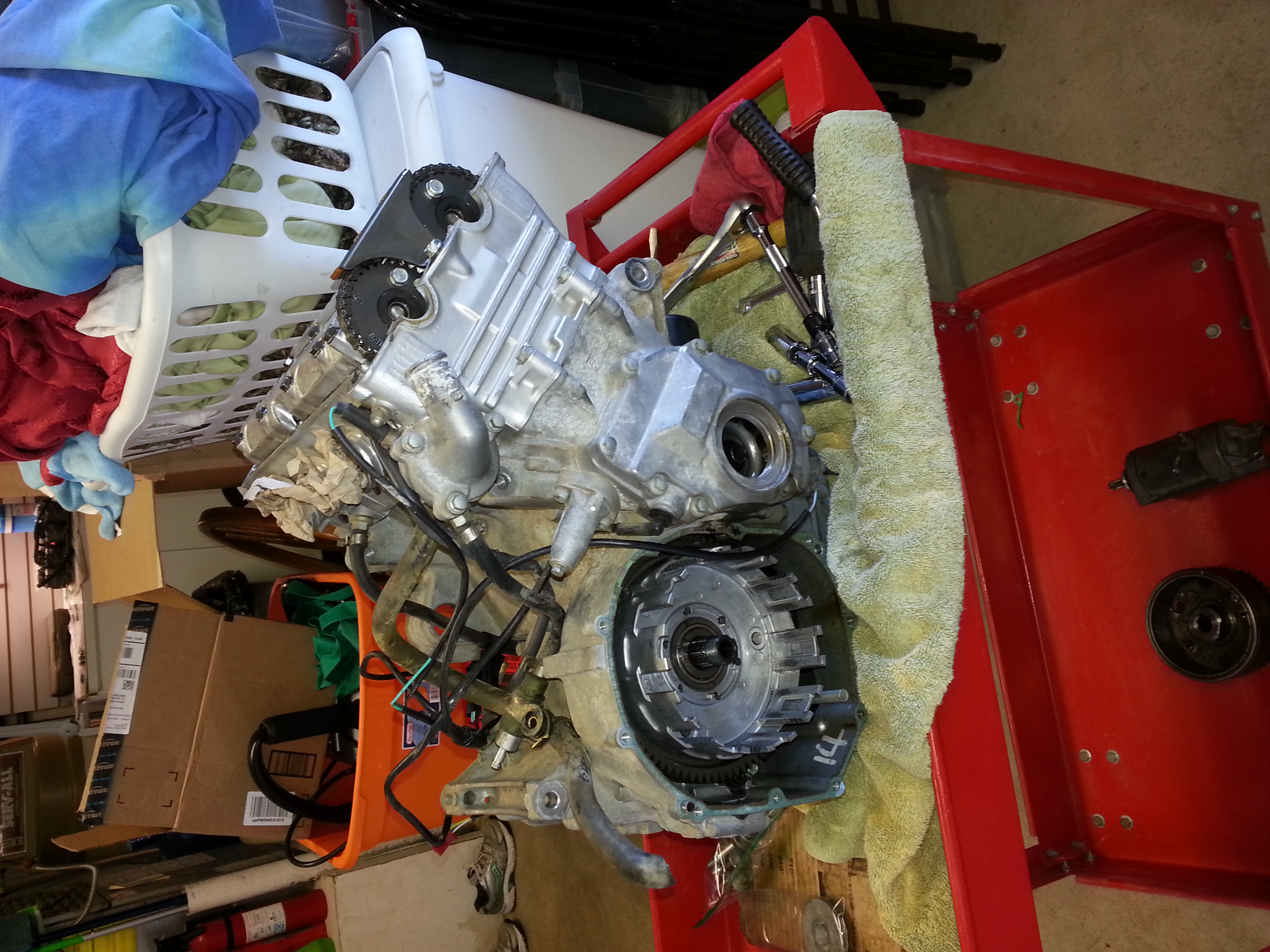

Two Engines one bike
Attached Thumbnails 1997 Honda CBR600 F3 LOW COMPRESSION-20160717_165125.jpg   1997 Honda CBR600 F3 LOW COMPRESSION-20160717_165157.jpg   1997 Honda CBR600 F3 LOW COMPRESSION-20160717_165248.jpg   1997 Honda CBR600 F3 LOW COMPRESSION-20160717_165229.jpg
