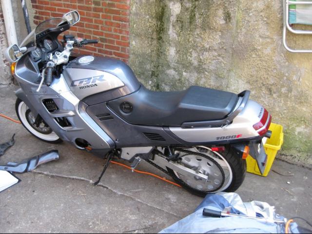

Strewth..that's different , and .hows the size of that rear sprocket !!!

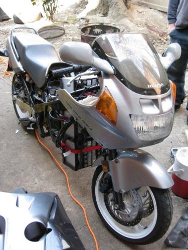

I don't understand the big sprocket either. If you add three times the number of teeth to the rear, the front sprocket would have to go three times faster to go the 55 mph as claimed, however those motors only turn 4,000 rpm max. It doesn't add up.
I didn't understand that, either, man. However, he mentions that he's running 4.5:1 gearing now instead of 6:1 previously. He also said that at 6:1 he was only running 35-40mph.
4000RPM @ 4.5:1 would be 888RPM. With a wheel circumference of 62" (just approximate), it would equate to 55,056 inches covered per min. That equates to .869miles per min. or 52MPH.
But that sprocket looks huge, so maybe he took the pics with the old 6:1 sprocket on?

That sprocket looks frickken huge alright
Well ....... it was all about the Dude trying to get .......range on the thing (14 miles)
