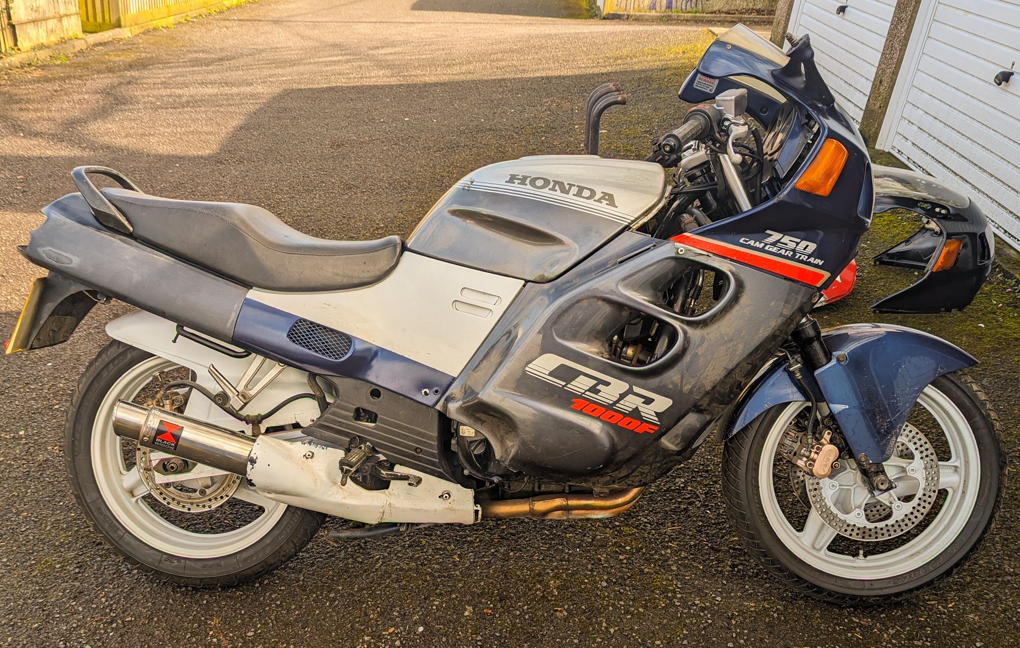

Hi, I'm currently restoring a 750 Hurricane and I have question about the stock silences. Is there any way to get to the baffles or are they sealed as one of silencers seem to have something rattling around in side and I was wondering if it was the baffle itself. TIA

Hey, nice looking bike!!!

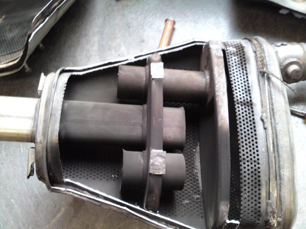

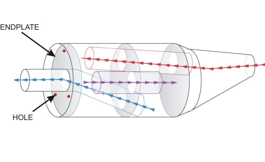

Entire muffler is baffle assembly (multi-chamber, reverse flows). Most likely one of pieces inside rusted and broke free. Easy enough to cut can open at welded seam at end. Find loose piece and weld it back into place. Some views of other mufflers.
