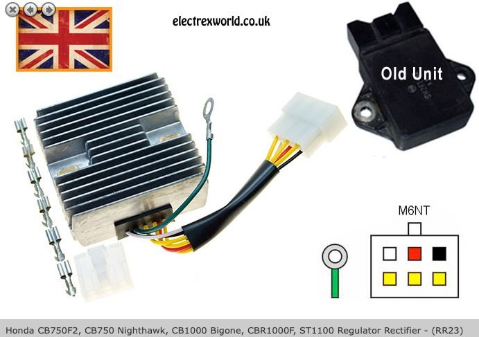

These are also good:
From what I've read, this one provides more current to the battery than the original unit at low to moderate revs.
A word of caution...there's a huge amount of electrical current coming up those yellow wires from the alternator, and it's looking for any excuse to short itself and then burn itself!
Make sure your electrical connections in the junction box are absolutely perfect. Don't ask me how I know this!
Cheers,
Dennis

Thanks dmoh for the heads up.
I think one of our other members got one from there recently as well and seems to work well.
