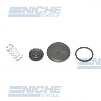

Running thread of my search for Petcock rebuild parts - this petcock has one side riveted (the switch side) and one side (diaphragm side) serviceable.
1. Upper and Lower petcock extension block o-rings (one on the tank, one on the petcock - 28.5mm x 2mm / 29.5mm x 2mm
2. Parts Unlimited 0705-0467 Petcock rebuild (includes main bolts, 4 diaphragm screws, diaphragm and spring, upper and lower extension block o-rings, control switch screw
3. Niche Cycle PRH-11013 - petcock diaphram rebuild kit - contains spring, diaphragm and lower o-ring (but missing tank side o-ring and screws).
OR
If you can find it (you probably can't!)
4. 16950-MZ2-790 PETCOCK ASSY - complete petcock including strainer - out of stock worldwide.
5. Rivet (switch side) main oring -
28.3 x 1.78mm
