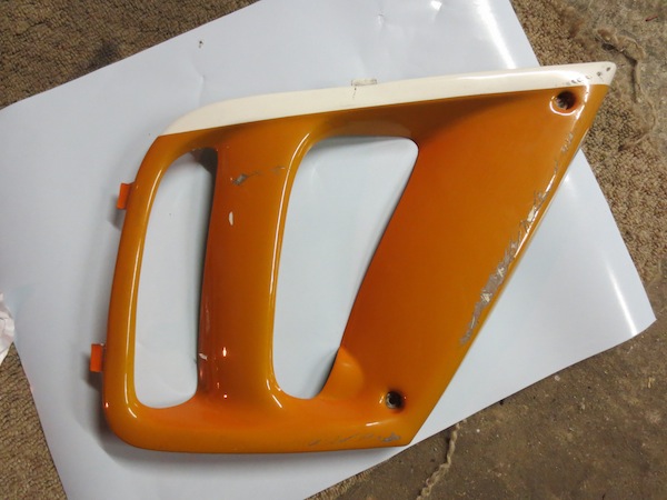

ok this is my first attempt at vinyl and at a build thread so well ... it is what it is.
This for me was a fail with the vinyl although the process was fine!
I wanted to vinyl the whole bike in white and add custom black decals (can't afford a respray, vinyl is cheap) for me this didn't work because the repsol paint job is 3 different colours going over it in white shows three different shades through the finished product.
however this is my first attempt at vinyl and I've painted a lot before so i can tell you, if you have the patience then its a cheap alternative to painting! looks good when done well!
This pics will show you part the i did for the try out too see how hard it was.
The standard fairing piece orange and white with scratches.
If this was going to be a final vinyl this surface would have been prepared and filled so there was no lumps or anything so it would be a perfectly flat smooth surface. for this (being a trial run) there was no point.
so i cut out a bit of vinyl over sized for the fairing piece so it can wrap round the edges.
Then simple lay on panel (after cleaning/degreasing/panel prepping).
I've shown wrong bits i.e bubbles etc and I've shown good bits that i had figured out how to do it properly on.
I watched a fair few how to's on vinyl but some have it wrong!
Heating and stretching (gently) is defiantly the right way!!!
If you use a tool to push out the bubbles it does rip!
for me a finger or thumb to push down the vinyl once heated was fine, if u find a bubble lift off again and stretch in the right direction to get rid of it.
do not over heat (very easy to do) and do not stretch to much (also easy) but once u get the nack of it, its not bad.
only cover a bike that is one colour though over wise your have the problem i did, it will take someone with good eyes to see it but if you look at the top of the panel in the picture u can see there is two shades of white on the vinyl where it went over the white and the orange.
I didn't make a huge effort with this panel because when i realised it couldn't cover the different colours i gave up but you can see along one side i made sure it was perfect for this thread.
hope this interests someone have fun
K
