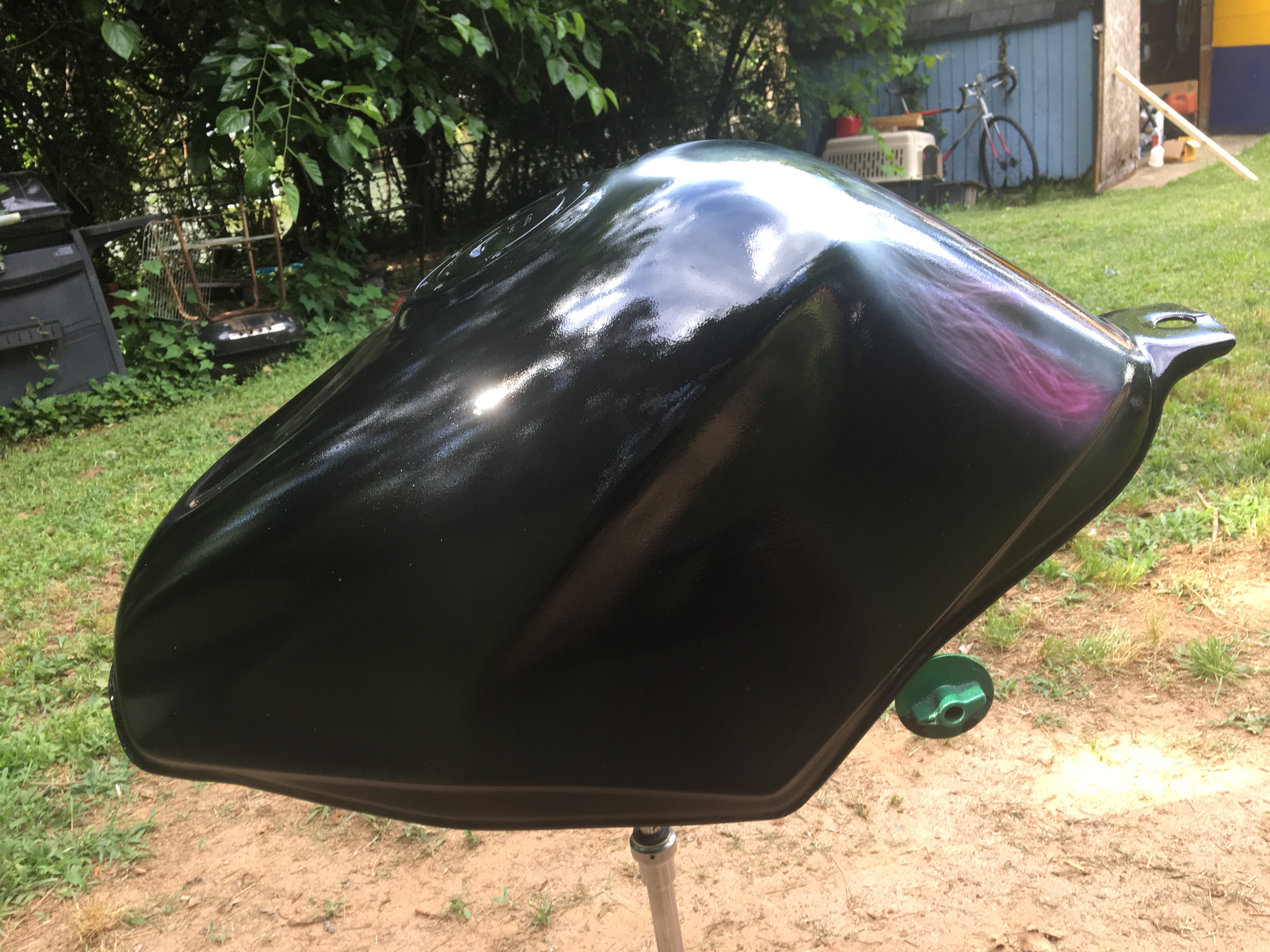

First coat of clear. Came out a little bumpy just on this side. I was a little bit to far from the side to create " dry spray" on the tank. I just had to remember to move in closer.

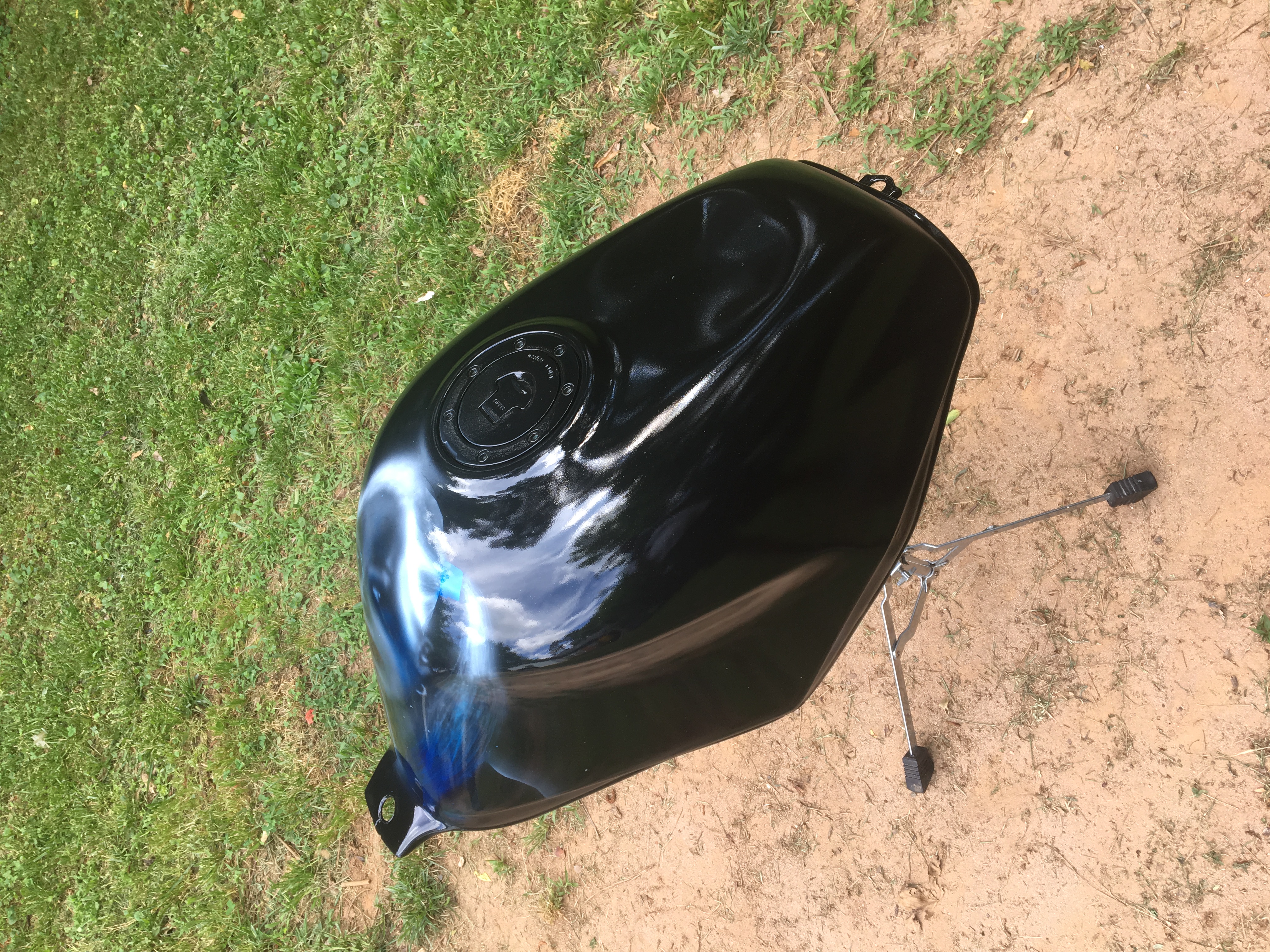

Second coat of clear. Mucccchhhhh better!

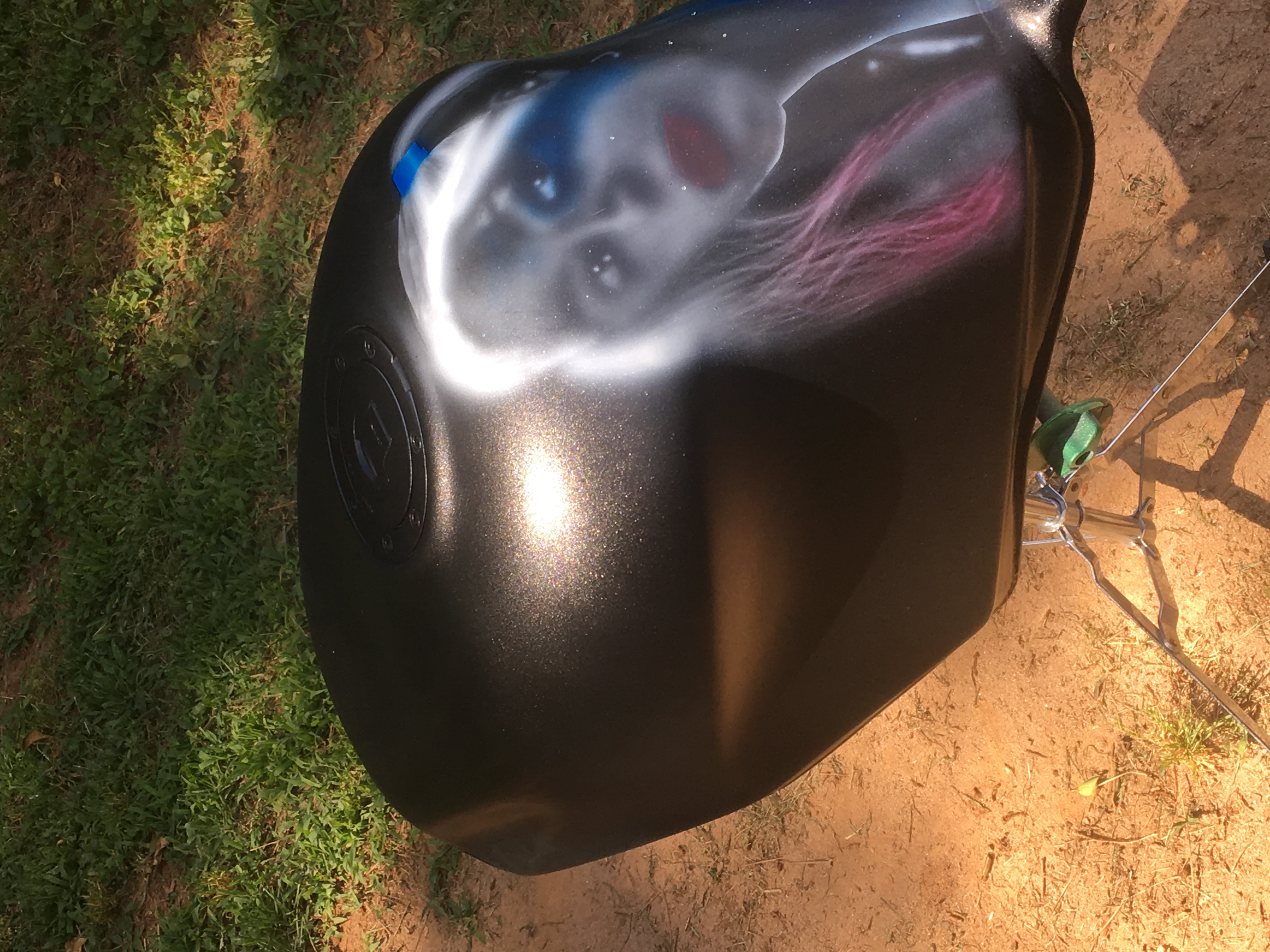

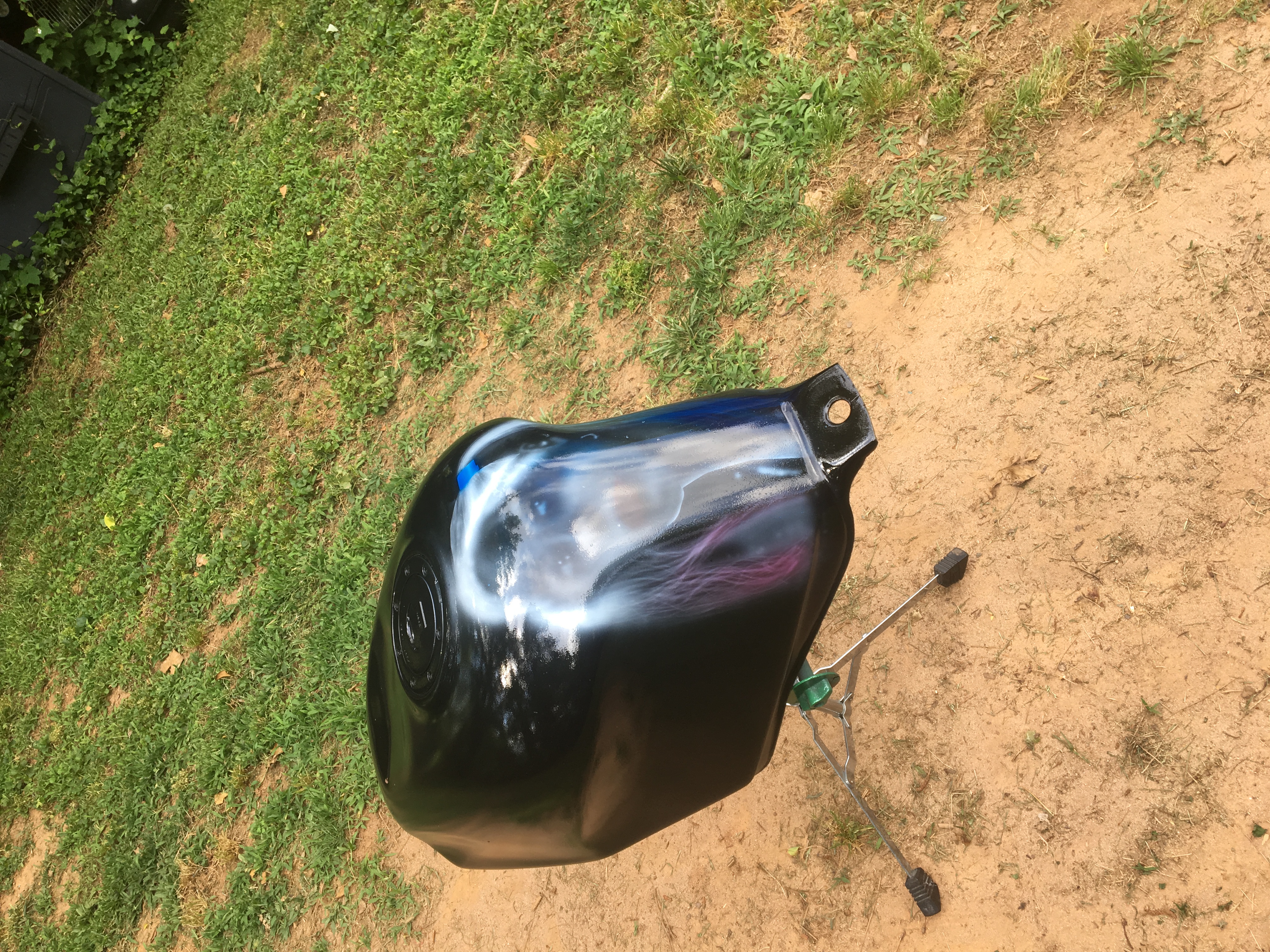

Done for now. Pictures on the bike!
Clear coat: Nason selectclear.
Tank paint: Createx airbrush paints white, deep blue, and pink.
Airbrush: Badger "Krome"
Time: If I could sit down from start to finish 6 hours, but it was spread out over 3-4 weeks. 15-20 minutes here and there, while working on other projects.
