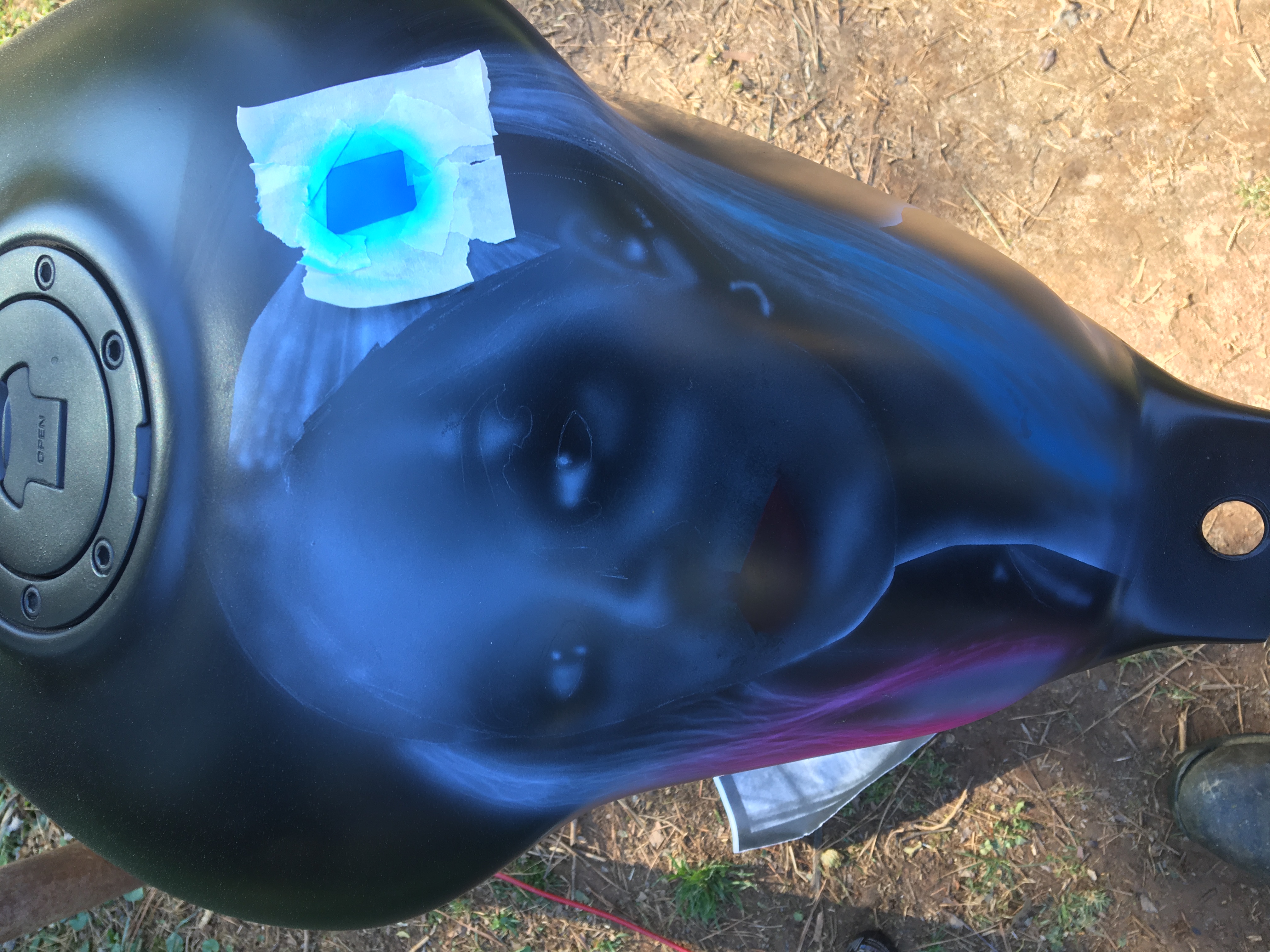

So I did the left side of the face highlights, her blue hair bow, strands going to her bow, and her lips!
Attached Thumbnails Project: airbrush gas tank portrait.-img_1489.jpg   Project: airbrush gas tank portrait.-img_1490.jpg   Project: airbrush gas tank portrait.-img_1491.jpg   Project: airbrush gas tank portrait.-img_1492.jpg   Project: airbrush gas tank portrait.-img_1493.jpg

These are kind of hard to see but it's just dark blue "make up" running on the side of her face.
Attached Thumbnails Project: airbrush gas tank portrait.-img_1533.jpg   Project: airbrush gas tank portrait.-img_1534.jpg   Project: airbrush gas tank portrait.-img_1535.jpg   Project: airbrush gas tank portrait.-img_1536.jpg   Project: airbrush gas tank portrait.-img_1537.jpg
