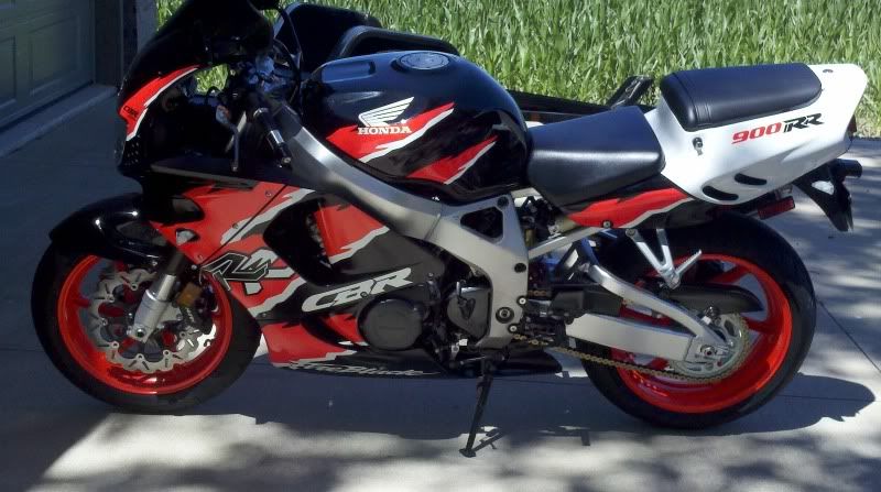

Here's a shot where the signals show up fairly well:

Just did this mod with your typical HotBodies flush mounts on my 1000rr, and it works fine. Running lights all the time, and turn signals function fine. Rest of the bike is still stock.
Only issue with hotbodies is that I thought I was given two of the same side turn signals, but they wound up going in the fitting fine.
Hey, post some more pic from different angle...bike looks good!
