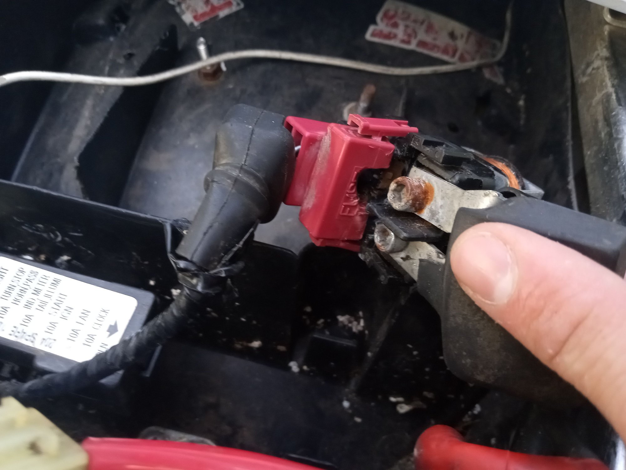

My starter relay looks like it has been melted man like I can't get the cover off of it

Where is it? And I think I need a whole new starter relay
I think I need a new relay

Remove this cover, there is a fuse located there. It's a 30A fuse. It definitely looks like it blew. You'll need to replace it. If it blows again, then you have a dead short and will need to locate it.

I can't get into it because it's melted
