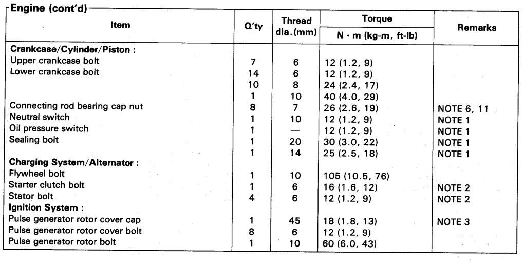

Can’t for the life of me find internal torque specs taking off the stayor and alternator what do I need to torque them down to and what about the casing what does that need torqued to thanks

What bike do you have ?

Cbr f2 93

Hope this helps
From the 89-90 service manual
