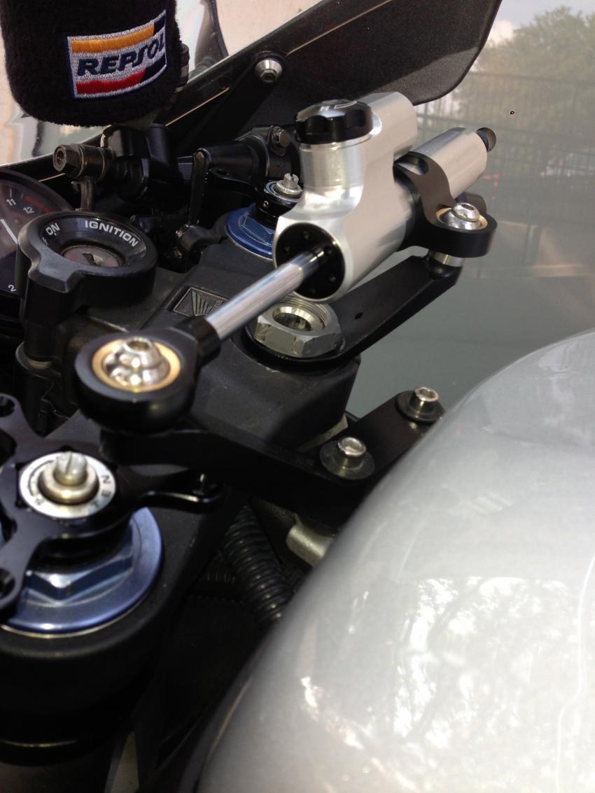

Here it is installed , I'm very pleased with it and it works very well! Just had to modify it a Bit. The bracket didn't line up as I mentioned earlier so I dremeled a notch about 3/4. An inch counter clock wise to line it up. I also used a rubber washer under the steering stem mount where it connects to damper. or the point where it connects from bracket due to allot of free play. The damper bounced and moved around with normal riding.
ok i have installed the damper and have put probably 500 miles on the bike with the damper on. I must admit I'm very pleased with it ! I just have to keep an eye on to see if it lasts and doesn't start to leak ! With that being said i did have to modify it a little bit.
I had two issues to get the damper to work properly. After mounting it up it did not have the correct throw or turn radius. the mounting bracket was to short. So i had to modify the notch on the triple tree. I busted out my trusty dremal tool and notched another groove about 3/4 an inch counter clock wise and viola everything lined up perfect.
Next was the play of the mounting swivel that holds the actual damper....... way too much movement ! It just bounced around like crazy .
My solution was to go to the local hardware store and buy two nylon washers. After installed i could tighten or loosen the play just by adjusting the allen head bolt just remember to lock-tight it!!!
