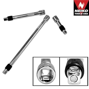

I had the same issue happen. The valve cover gasket swells a bit and tightens on the socket. I used a locking extention to get it out.
