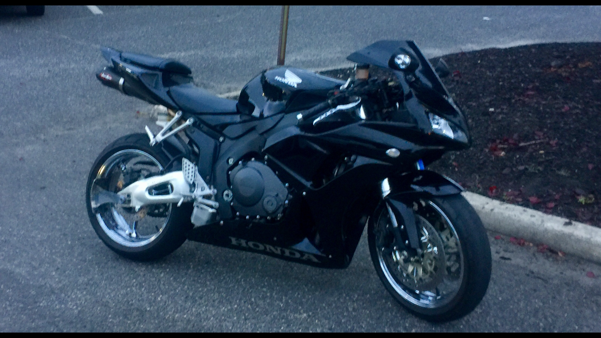

here she is- an 06! Mint. !! Can you believe it !

Besides the brake lever thats really nice. Did it run better with the plugs?

DUDE !!! You just trashed my levers !!! LOL . Yeah I hated them at first but they’ve actually grown on me. Now I won’t even mention the cheesy skull and fire tank protector that WAS on it !
Yeah, the plugs made a HUGE difference, the bikes a beast. Like I said earlier, it hesitated in the low r’s and I could feel it surge on the highway. My first ride after the plugs I took off and the rear wheel spun then when I hit second the front came up without intention.
My other bike is a 00 zx9 in mint condition and there’s a big difference.
The guy chromed the wheels and put the carbon jardine slip on on it. He installed a really nice light kit that really shows off the chrome. I put a light kit under the tail lighting up the carbon exhaust.. everywhere I go strangers either want to talk about it or give it admiration. It’s cool.
my other Honda was a white vfr- beautiful bike also.
thanks for the time and consideration w my problem and I’m glad to be part of the cbr forum. I’m keeping the levers !!😎
Man, to top it all off I got the bike for $3800 !!

Beautiful bike mate. This and the 954 are the sexiest iterations of the fireblade line!

She's a beauty!
What's that thing on the swingarm?

This is it
Thanks hawk, loving it !! The thing on the swing arm is a license plate mount. If installed properly it puts half the plates view inside the rear tire, cops cameras don’t scan it.
