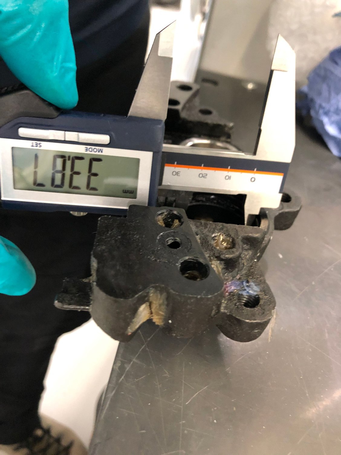

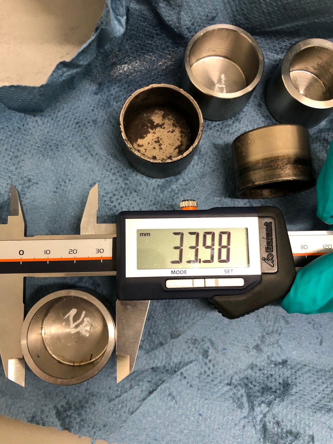

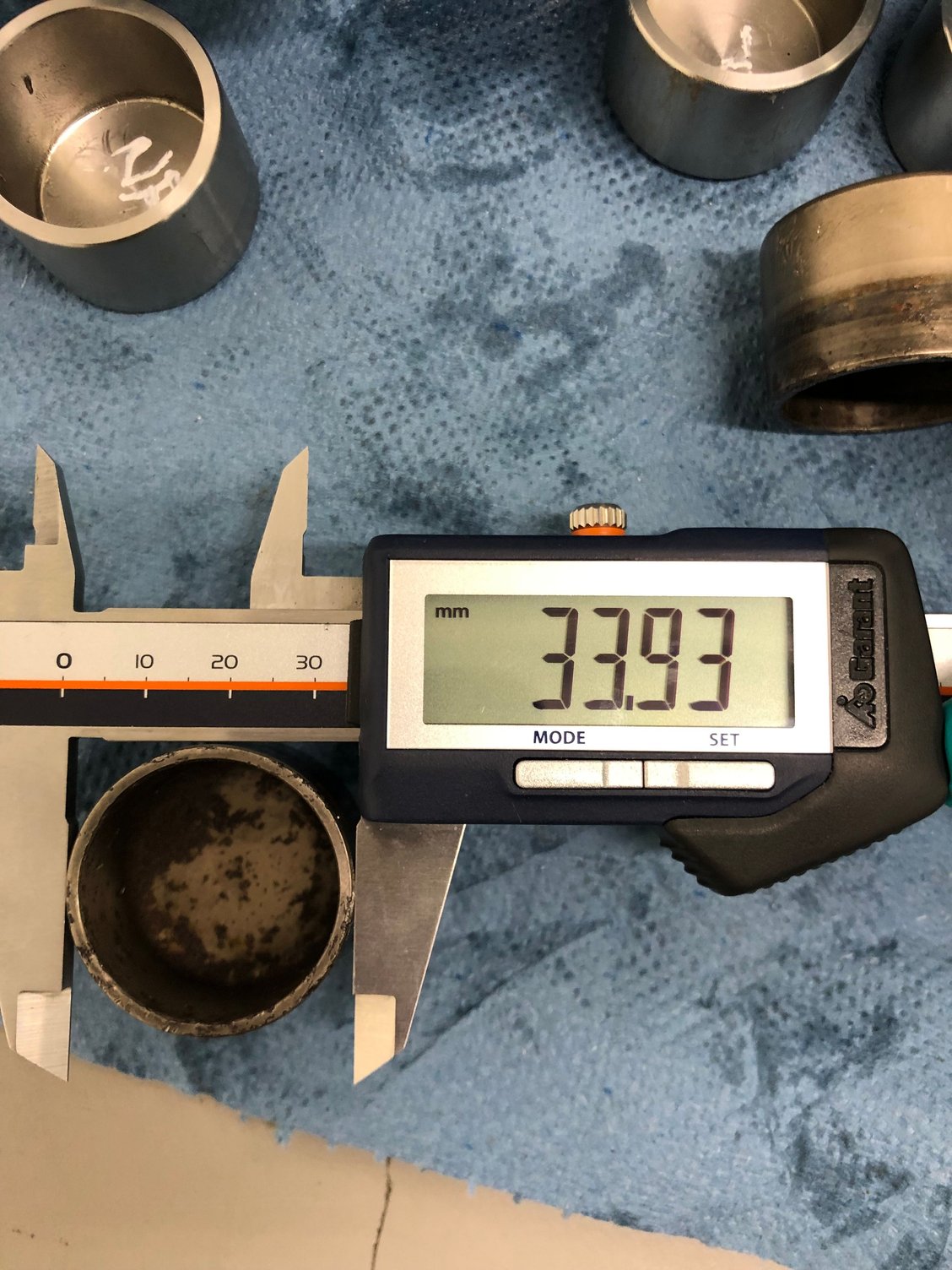

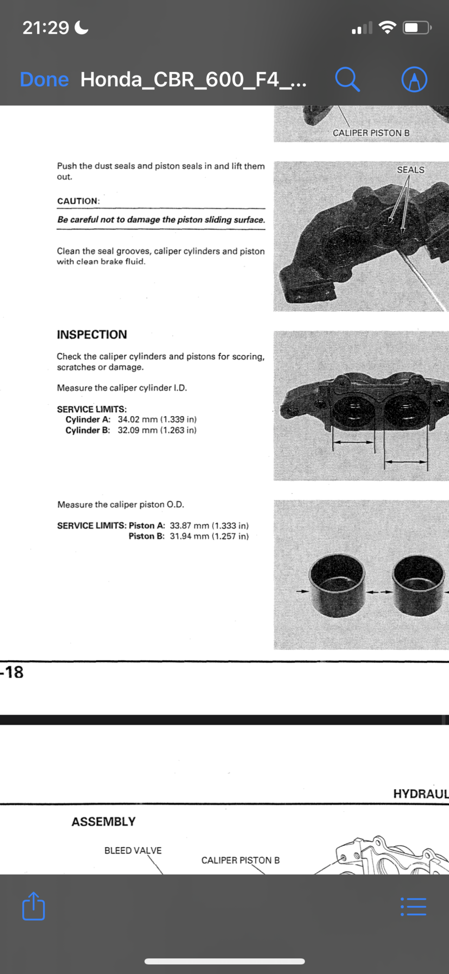

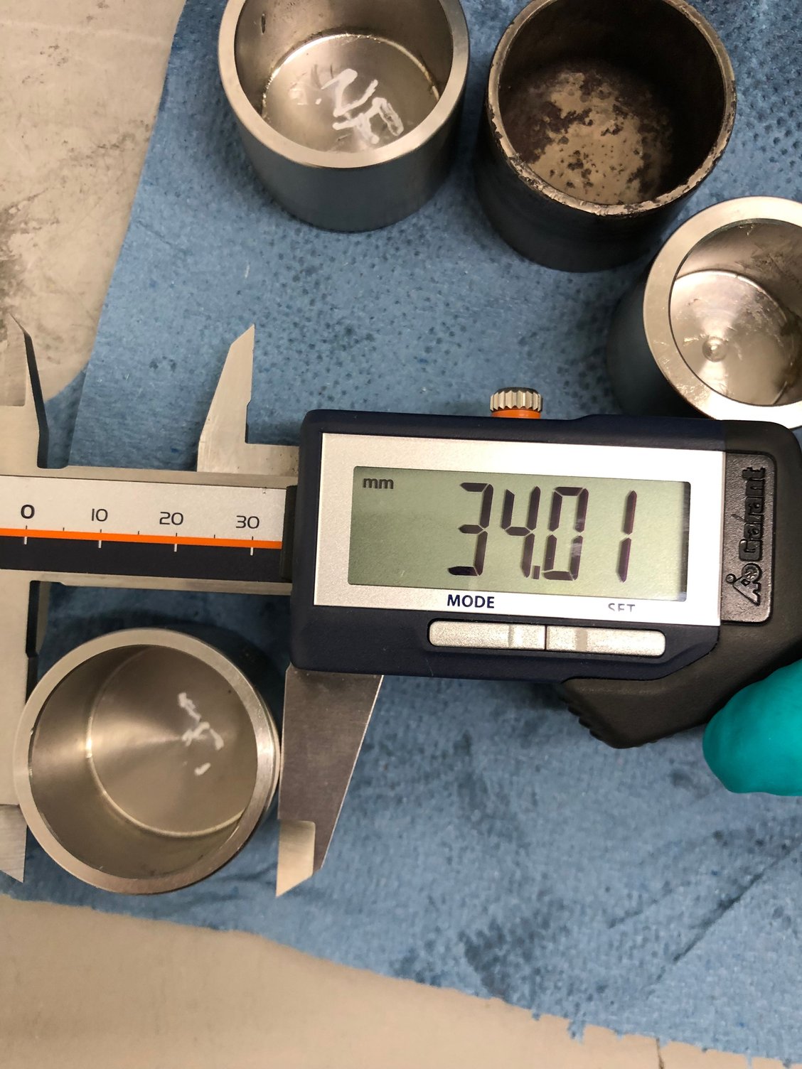

3/4 new pistons fit fine just one large bore piston giving trouble.
all 4 oem pistons drop right in.
Im thinking the bore must have a squared side though it slots in fine and evenly flush upto the dust seal point about 3-4mm down the bore 🤷
measures all and they seem to be the correct size . Really quite stumped.
excuse the mess of them , residual grease from the gun used to push them out.
*edit - pistons & calipers were completely cleaned after I took them apart, red rubber grease held the seals to their recess’ , and brake fluid lubed both caliper bore and piston.
from my searching (to no avail) there doesn’t seem to be much discussion/problems posted about caliper cylinders deforming.
though this is a 20 year old bike that lay neglected for years anything is possible I suppose.
possibly the aftermarket pistons are to blame, I have new oem ordered so these will tell all when they arrive next week.
