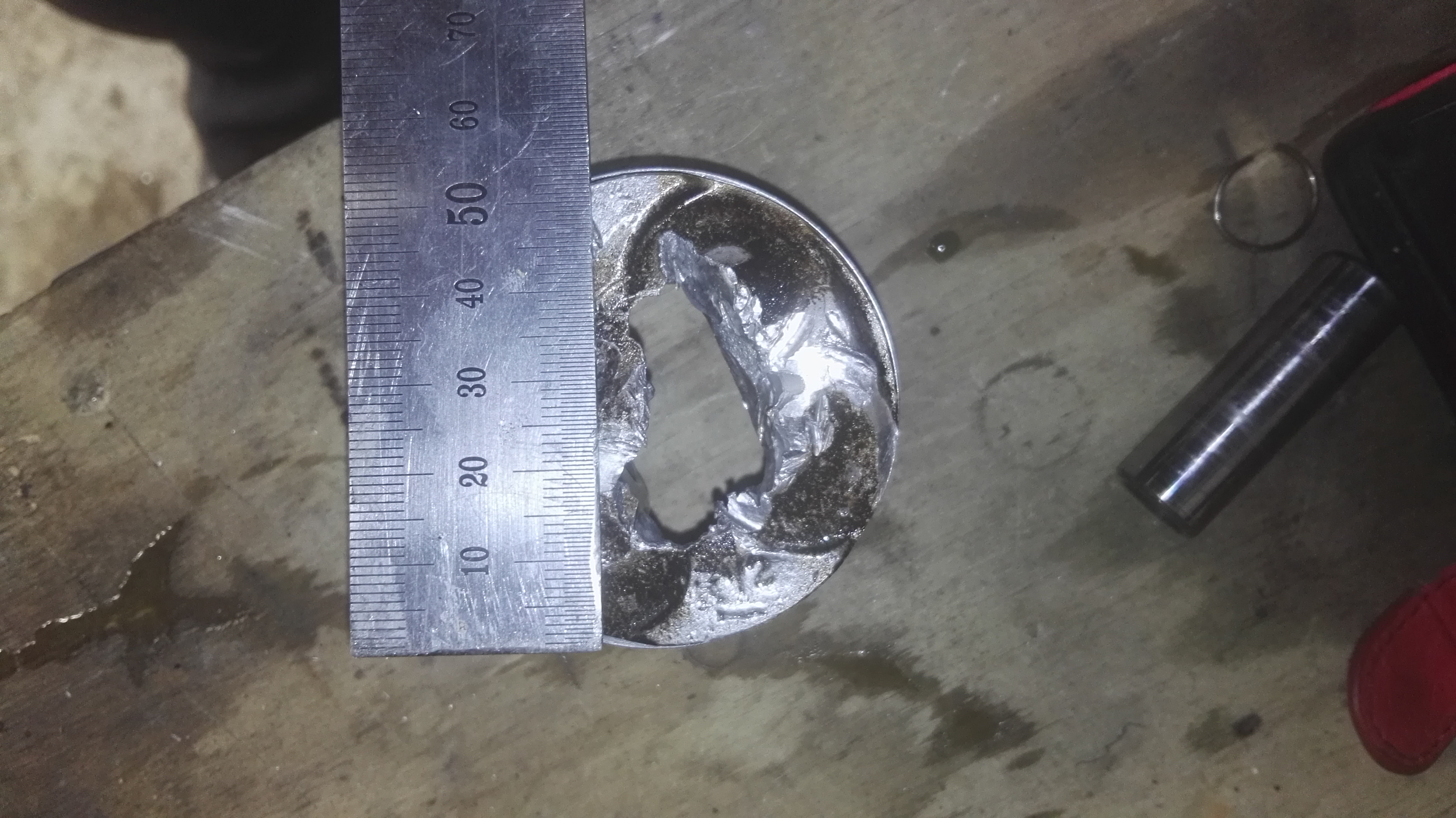

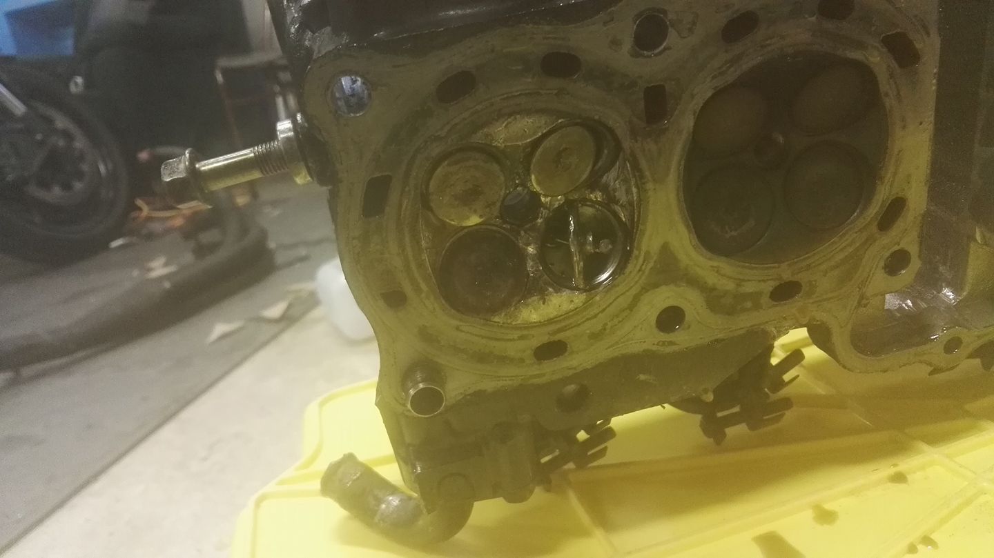

Its a bit worse than I thought. The bottom 1/3 of the spark plug has disintegrated, there's a hole in the piston I can poke two fingers through, the cylinder barrels are damaged badly, and the head is stuffed - two valved are destroyed, and I think its probably beyond repair.

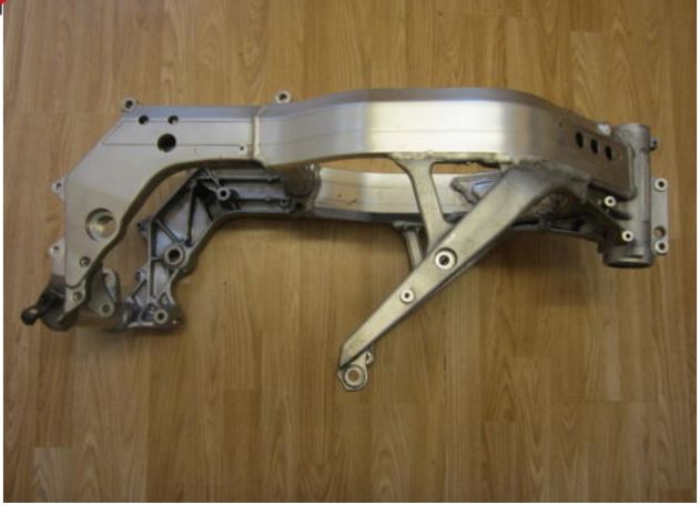

See here for exhaust
400GreyBike ? View topic - NC23 - NC29 full exhaust system compatability
and the framewill need some cutting/welding
Attached Thumbnails NC23 blew up - questions on repair-nc23-frame.jpg   NC23 blew up - questions on repair-nc29-frame.jpg

hmmm, dont really want to start cutting into the frame, I dont have the tools for it here.

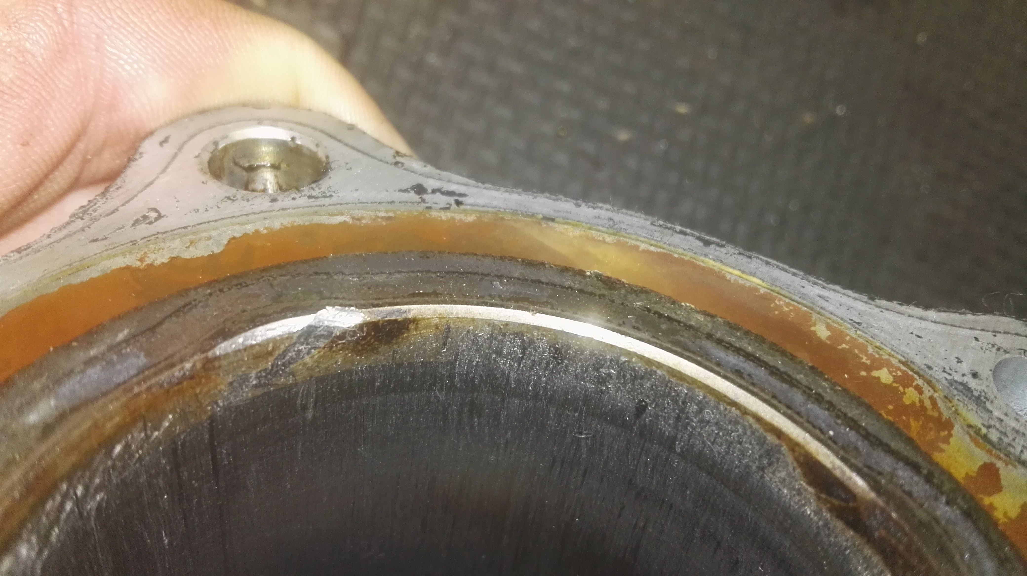

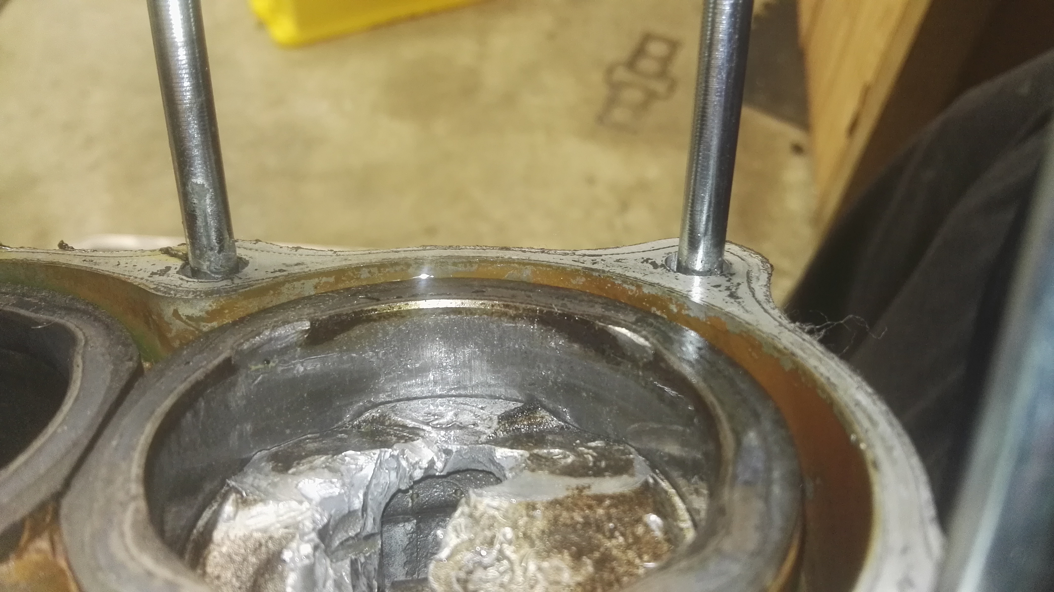

The top of the barrel on #4 is damaged, in a couple of spots around the lip. Im wondering if it would be salvageable? Ill post a photo, and perhaps you could tell me what you think?
its possible I could remove barrel, replace piston and rings, remove debris thats fallen into the motor, and stick a new head on it

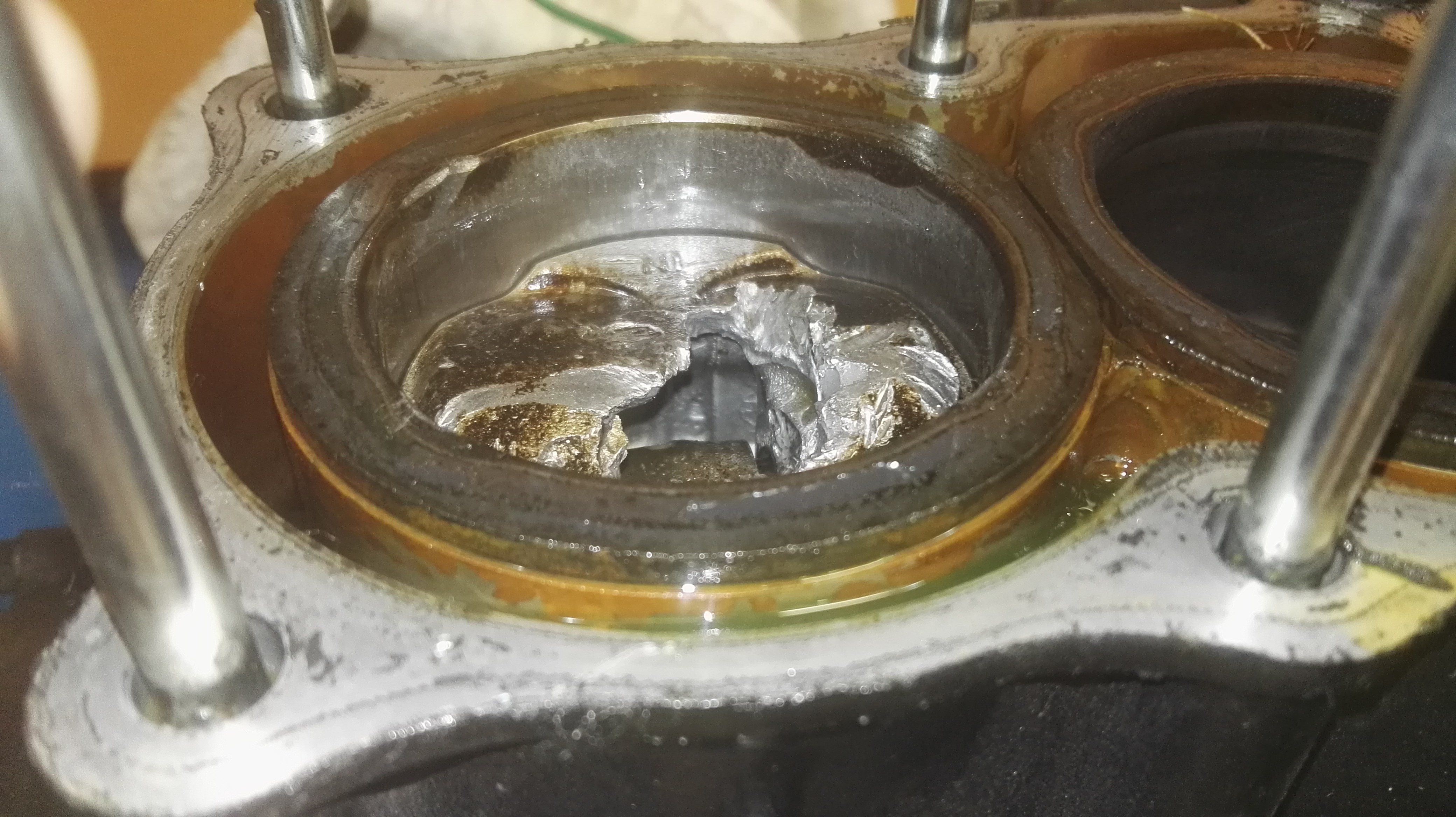

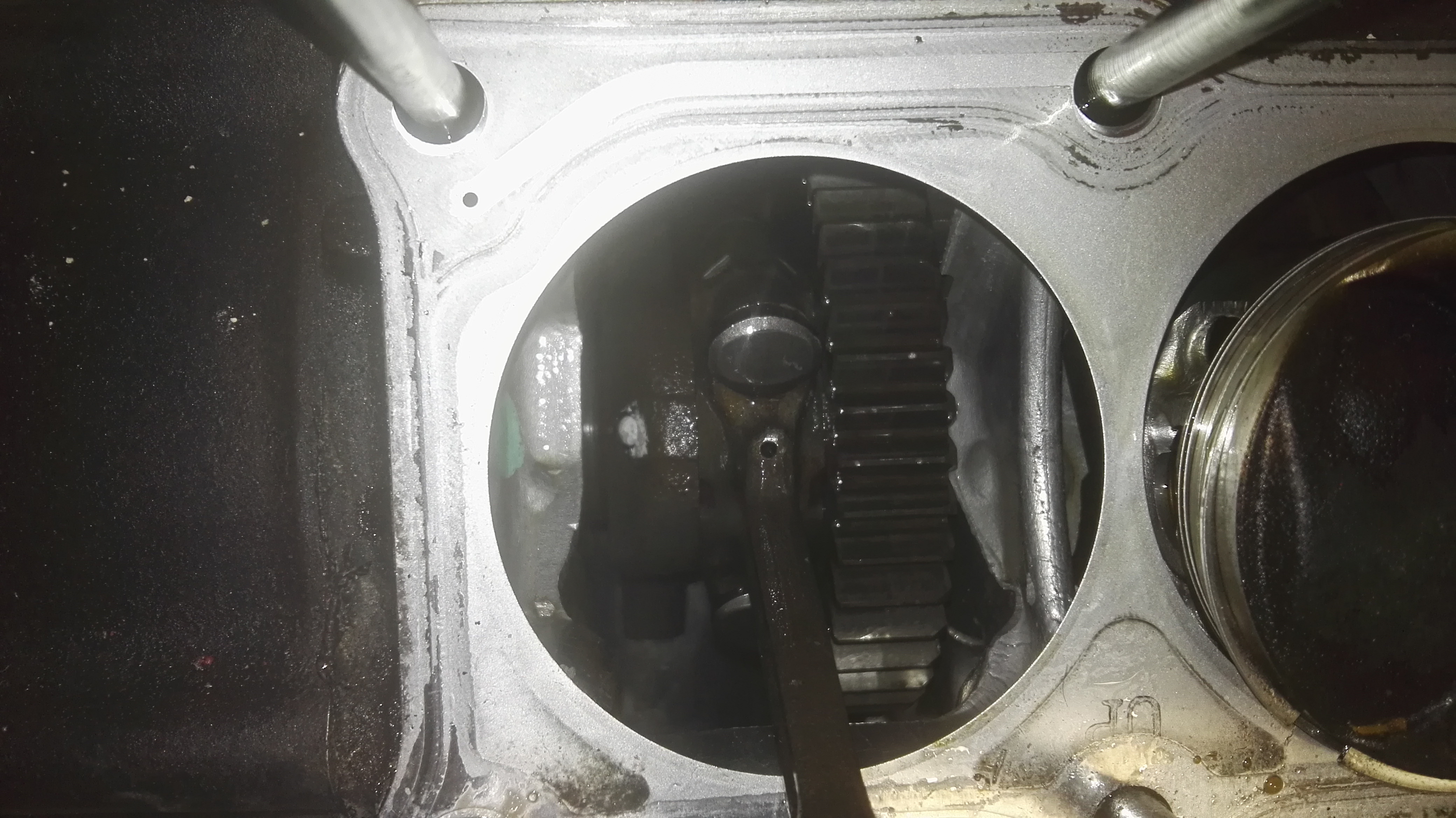

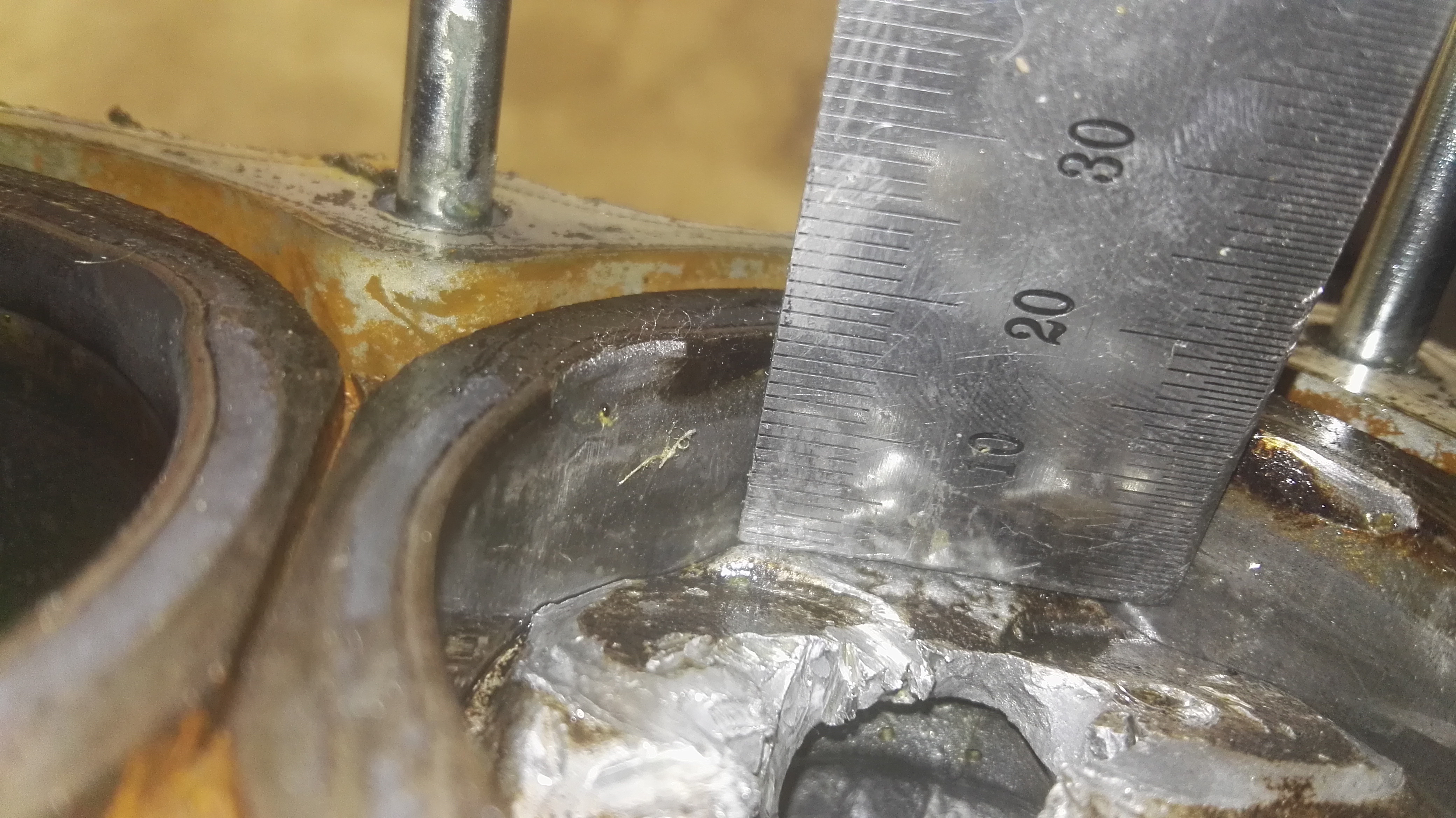

ok heres some photos of the damage.
I have found a complete head, waiting on a price though. MIGHT have found a set of cylinders as well, but not sure if he still has them.
Im hoping I can get away with perhaps going 0.5mm oversize (was still on stock 55mm piston and rings) with a new head. any thoughts on whether I should reuse the cylinders?

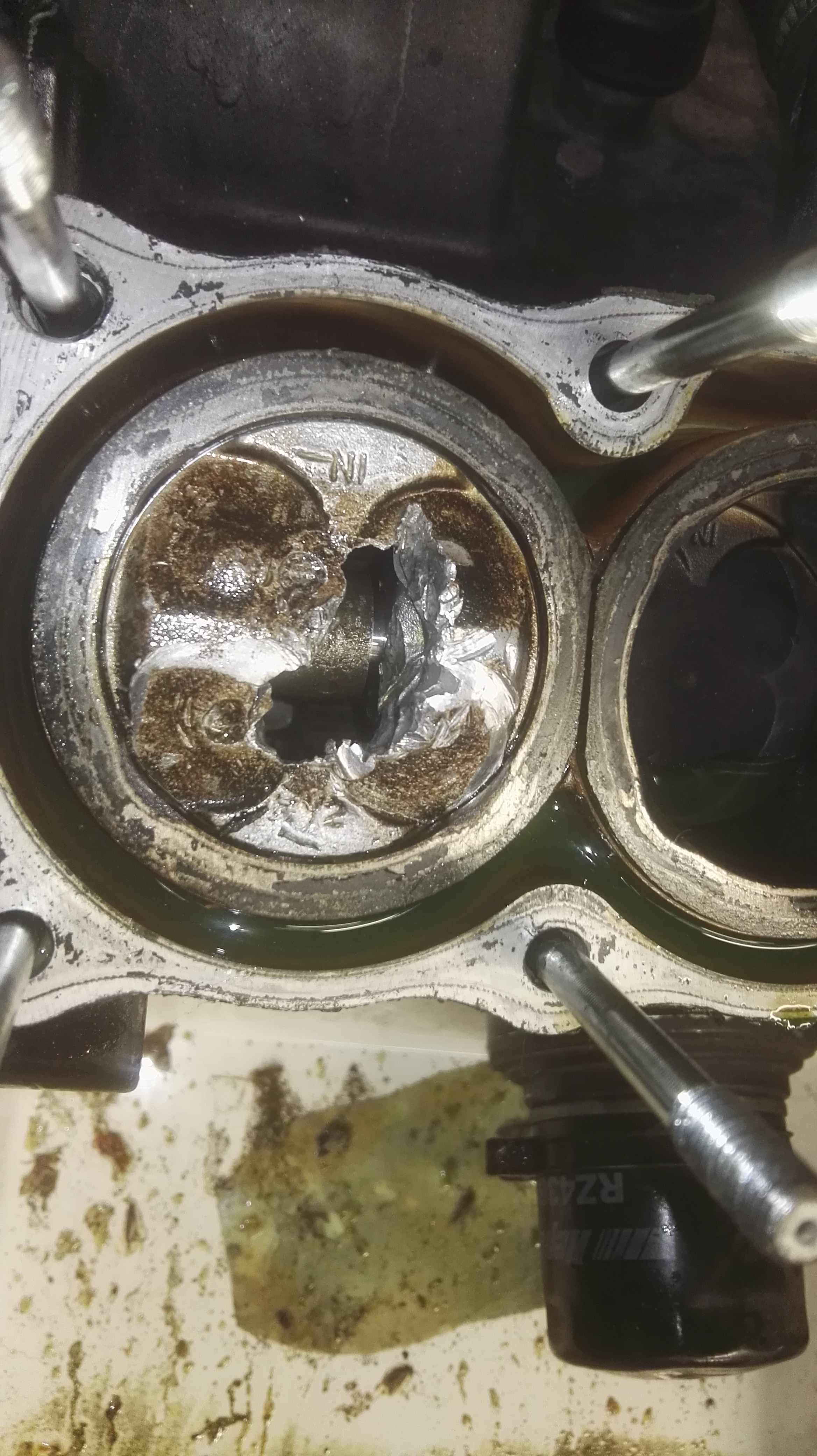

few more
Attached Thumbnails NC23 blew up - questions on repair-piston.jpg   NC23 blew up - questions on repair-into-block.jpg   NC23 blew up - questions on repair-worst-damage-cylinder.jpg   NC23 blew up - questions on repair-head-damage.jpg
